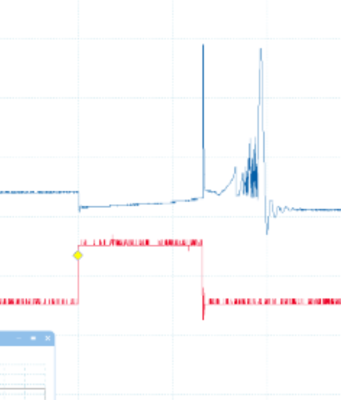

It seems as though you were correct! I just got back from a test drive after swapping the direct injectors between cylinders 3 and 1 and the problem moved to cylinder 1! I’m super stoked to have found an issue! I just need to get a replacement injector and do the job again and hopefully she’ll be good to go for another hundred or two thousand!I think your #3 injector is firing but allowing insufficient fuel through under load (high cylinder pressure). This would account for the lower positive fuel trims you're seeing because some of the oxygen is being consumed in combustion, but not all of it.

Thanks! I am definitely relieved! I used the picoscope 2204a along with the hantek ht25 and an extension wire. It doesn’t take too long to get the those installed, so I’ll make a new capture when I get the new injector!Well done! Those are some excellent captures of the secondary. What probe did you use?
FWIW, this one was the smoking gun for me:
The 'tail' at the end of the burn line, nearly as tall as the firing line.
Would love to see some captures with the new injector if you have the time afterwards.

Good work! I'm curious -- How did you hook up the HT25 to your COP?

COP Extension Cord with Earth Cord for Diagnostic Coil-on-Plug Lead (HT308) a.co/d/8wH2kPD
Replied by type3sqr on topic Cannot fix Single cylinder misfire under load.
I got one of those extension high tension leads and used it in between the coil and the plug. I zip tied everything in place so I could drive it like that.Good work! I'm curious -- How did you hook up the HT25 to your COP?
