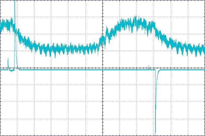

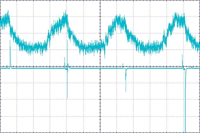

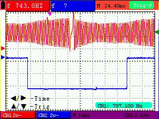

I'm working on fixing a 2007 Chevrolet Aveo for a relative.
The idle is rough and manifold vacuum is only 14" hg. The timing belt was changed a while ago and the driver thinks that it started after the timing belt change. No misfire codes at this point. I liked the example in PD's book and videos of comparing peak compression to cylinder spark event to determine if the timing is off and did that test. I have a couple of waveform .bmps I would like opinions on. In each, the top trace is a current probe around the battery cable during cranking and the second trace is a capacitive ignition probe around the cylinder 1 plug wire.
Last edit: 9 years 1 month ago by Tyler.
9 years 3 months ago #10874 by Tyler
Replied by Tyler on topic Aveo 2007 Rough Idle and Low Vacuum
Hey RH6400!
At first glance, it looks to me like spark timing is OK. A little bit retarded of TDC, sure, but that may be the default timing strategy on this engine. I'm eager to hear what others think of your captures.
What actually caught my eye was the relative compression waveform itself. The large U-shaped valleys in between the compression humps looks unusual... Kinda reminds me of other captures I've seen on engines with jumped timing. Not saying that's your issue, just thinking out loud. ;-)
If you can get to the cam and crank sensors, we can try a cam/crank waveform compared to a known good, and see if there's anything obviously out of alignment.

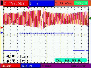

  • RH6400
  • RH6400's Avatar Topic Author
9 years 3 months ago #10907 by RH6400
Replied by RH6400 on topic Aveo 2007 Rough Idle and Low Vacuum

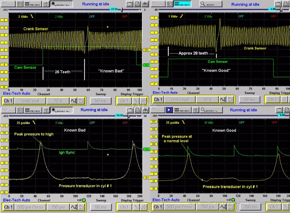

Hi Tyler,
Attached are captures of the crank and cam sensors.

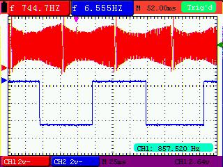

9 years 3 months ago #10927 by gav09
Replied by gav09 on topic Aveo 2007 Rough Idle and Low Vacuum
here is a known good.
The following user(s) said Thank You: RH6400
  • RH6400
9 years 3 months ago #10930 by RH6400
Hi gav09,
Thank you for the waveform. Is it from an Aveo 2005-2007? Also, it appears to me that mine is off a little. Do you have any thoughts on it?
Bob
9 years 3 months ago #10944 by Tyler
The cam/crank relationship seems OK from what I can see. It's tough to get an exact tooth count, but I saw 26 teeth from the sync notch to the cam transition. As this is a DOHC engine, it's still possible that the other cam is out of time, but you'd have to pull the top timing cover to verify. :-(

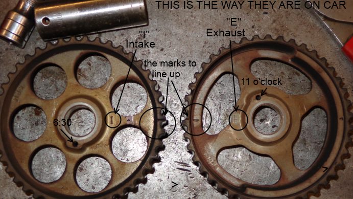

I do have the upper cover off. The lower cover is more involved to remove. I used a dowel to find TDC and the cam marks line up at TDC compression of cylinder four. I thought they should line up for that condition of cylinder one but looking at the Chilton manual with a magnifying glass that appears to be correct. I have not done a power balance test yet. My scan tool does not do it and I have not tried grounding the plug wires at this point. Does the 14" hg of vacuum, fairly steady point in any direction?

Thanks gav09. A 2008 should be the same. The engine in the 2007 I'm working on is a L91. The sprocket position you posted is the way mine line up with Cylinder Four at TDC compression. I'm not sure what direction to go in with this car but I know the owner is very sure the rough idle started after the timing belt replacement.
9 years 3 months ago #11033 by Tyler
So the crank lines up with its mark, and the two cam marks are level with each other? I don't suppose someone swapped the cams side to side? i.e. Intake on the exhaust cam, like that.
I suppose it's possible that one of the cam keyway a sheared off, but the only way to know that would be to remove the cam sprockets...
Only other thing I can think of is that they got the timing wrong the first time around, tweaked the valves on the pistons, and now they're not sealing correctly.
  • RH6400
9 years 3 months ago #11064 by RH6400
I have not removed the lower cover so I'm not sure the crank mark is correct but using TDC found with a dowel looks like it is OK. The exhaust cam is unique in that it has two marks and a pin that should be at 11:00 indicates which mark is the one to use so the cam sprockets are in the correct spots. The tweaked valves are a possibility but the leakage was < 10% on all cylinders with a leakdown test. So far there does not seem to be anything that really stands out except that 14" hg of vacuum. If I had my wish I would have a known good 2007 Aveo parked next to the bad one to check some things on, but I don't think anyone with one would go along with that.

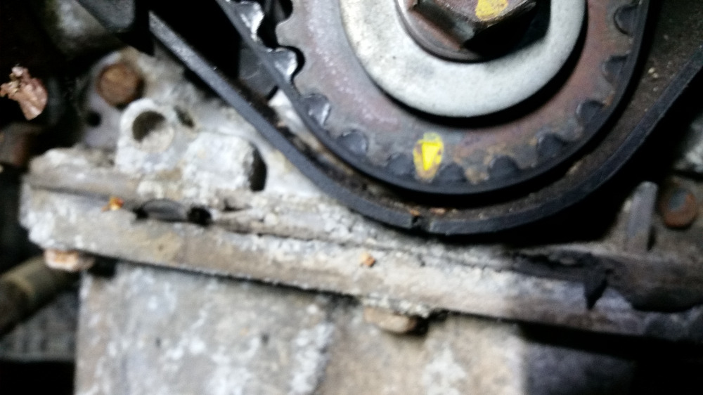

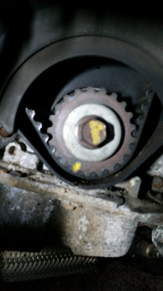

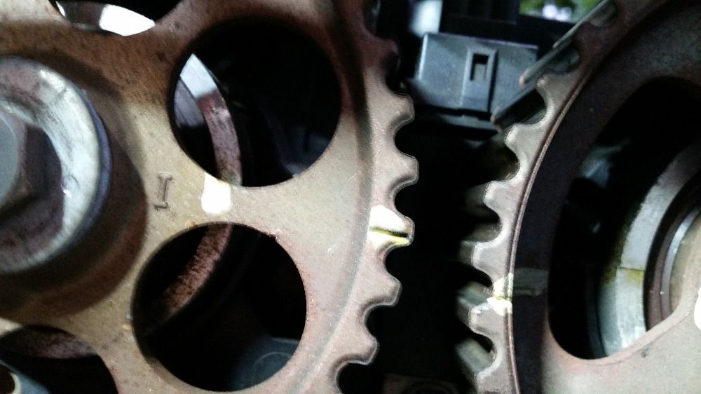

9 years 3 months ago #11360 by RH6400
Did some more work on this today. The attached photos show the crank mark lined up and the resulting position of the cam marks. This does not look close enough to me but I would like input from the forum. The last picture shows where the crank mark is with the cam marks horizontal and next to each other as they should be.
9 years 3 months ago - 9 years 3 months ago #11362 by Tyler
I think you found it! The picture with the crank mark aligned shows the issue better, but either way, timing is out. :cheer:
It looks like the exhaust cam is one tooth retarded, IMO. You can try the ol' golf tee trick and see if you can pop the cam back into time without taking everything apart. ;-)
