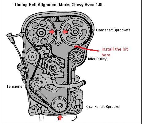

Thanks for the explanation Tyler. This sounds like a great trick so I want to make sure I understand. In my case I need to advance the exhaust cam one tooth so the bit would start on the right side of the sprocket? I'm having trouble picturing a valley to start at on the right side?
9 years 3 months ago #11404 by Tyler
Replied by Tyler on topic Aveo 2007 Rough Idle and Low Vacuum
I can illustrate it with Paint when I get home, no problem. For now, pick out a groove on the sprocket where a belt tooth would normally fit in. Put the bit into one of those grooves before the belt starts engaging (on the right side of the sprocket, as if you're looking at it to check timing marks) and simultaneously rotate the crank counterclockwise.
Catch the bit as it comes out the other side, or let it go if you've still got the lower timing cover off. :lol: Recheck your marks, and see if you get some respectable vacuum readings.

I would appreciate the Paint diagram. Also, the engine normally rotates clockwise and the repair data warns to only go clockwise and of course I need to go CCW. How risky is going CCW far enough to move it one tooth?
9 years 3 months ago #11412 by Tyler
RH6400 wrote: I would appreciate the Paint diagram.
I grabbed a belt diagram off Google, hope it makes sense:
Fair point! Rotating the engine in it's intended direction is safe advice on any overhead cam setup. That said, I've rotated belt setups the wrong way many times, and never caused an issue. Just take it slow keep an eye on the belt as you're doing it. ;-)

Diagram is very clear, thank you. As far as going CCW, that is what I was thinking, as long as I go slow it should be fine.

I finally got back to the Aveo. Thank you again for the suggestion of the drill bit trick and the clear diagram. The drill bit method did work and allowed me to get the timing marks lined up perfectly. The car runs now with 18" hg vacuum not the 12" hg it had before.. That 18" hg vacuum value is something I have not seen with this car since the first shop changed the timing belt. There is still some work to do since it has been sitting with a dead battery but it's a lot closer to being back on the road.

Tyler wrote: Basically, you put a golf tee (or the smooth end of a drill bit, whatever) into a valley of the belt sprocket, and rotate the belt so the drill bit/tee ends up under the belt, and gets dropped out the other side. This ends up making the belt jump a tooth on that sprocket.
You better believe I'm trying that the next timing belt I have to do. genius.
