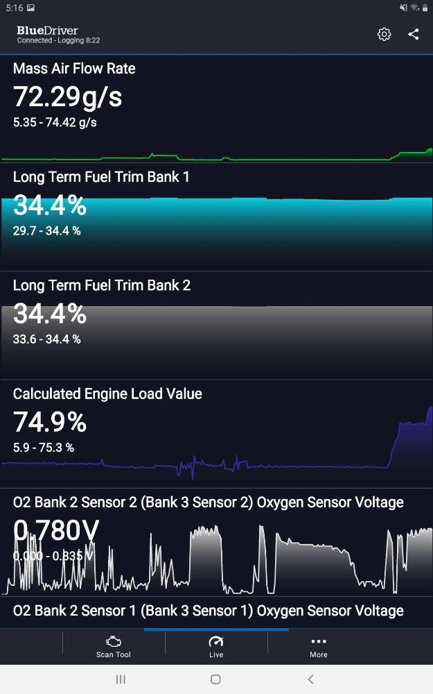

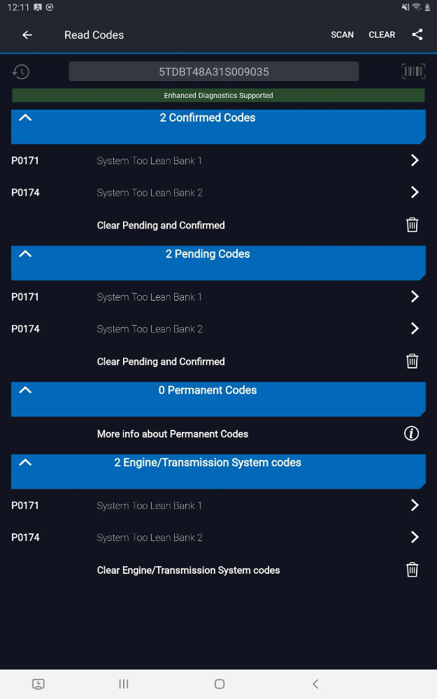

Hi group! My 02 Toyota Sequoia has been running with lean codes (P0171, P0174) for a few months now. When starting hot or cold it usually needs a few seconds to turn over, rest for a second, then it fires up on the second turn. Also, low power under load. It won't go over 80Km/h up a little hill. I'm down to 40Km/h on the big climbs with an empty trailer.
I have replaced the fuel pump, fuel filter, injectors (12 hole upgrade), fuel pressure regulator, MAF sensor, O2 sensors, and spark plugs. There are no vaccum leaks. Fuel pressure at the rail is within spec. I've done full resets after replacing each item. I'm at a loss. No other codes.

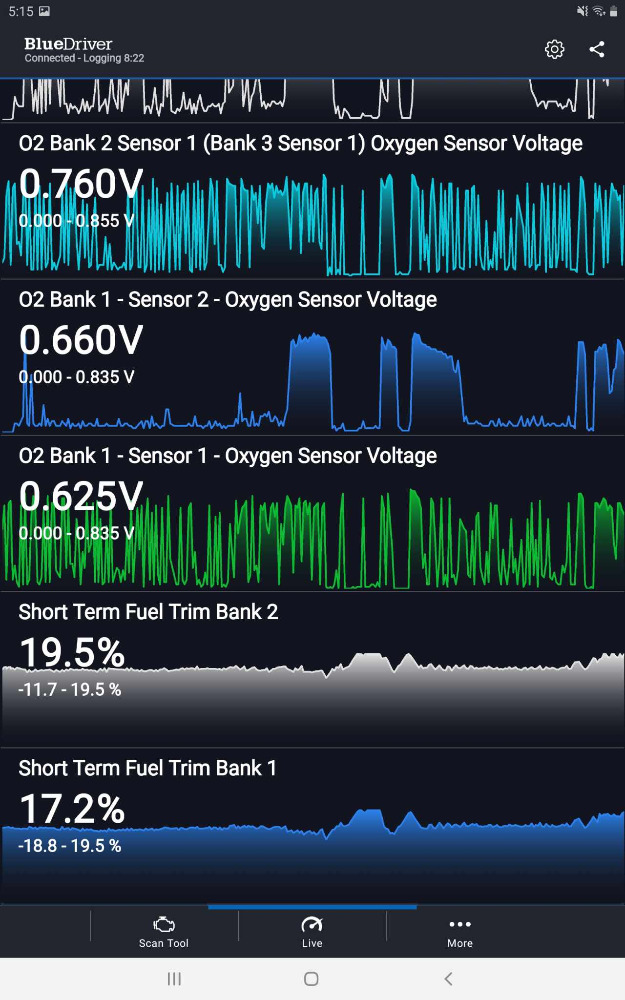

I have attached some data from the bluedriver. You can see from the MAF and %Load that I was at idle until the mid point, revved it to 2500 for a few seconds at the mid point, then started driving at the very end. I don't know what to make of it other than my fuel trims are through the roof and it seems like an oxygen sensor may be acting up? I wouldn't rule out that a new part may be faulty, but that just makes it more difficult for me to figure out. Any input is much appreciated! Any critical questions to guide me in the right direction?

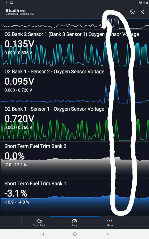

Graph your 2 upstream sensors only, and do a wide open throttle check, ie. gas pedal to the floor briefly and somewhere safe. your 2 upstream sensors should go over 800 millivolts at wide open throttle. if this test is good, I would remove one of the upstream sensors ,find a hill and see if performance improves with the forward O2 sensor out. Make sure to check your pcv hoses, valve, etc.

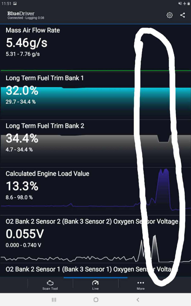

Well, wide open throttle test showed O2 sensor voltages tanking to 0 very quickly. They stayed there until I let off the gas. I had power though since I wasn't towing the trailer. Seemed to run decent actually. Little shaky at idle after. RPM's would dip low and stutter before coming back up for a couple of minutes. I attached the data of WOT test here (circled test area in white). I'm guessing this indicates that my problem isn't the converters being plugged? I noticed my MAF sensor didn't read anything different during the test.... Could that be my issue? It was reading accurately the last time I tested with normal driving.

The maf reading not changing is definitely a problem! The test confirmed you have a fuel delivery problem. The maf sensor could be dirty, or sensor no good. I would back probe maf sensor checking power and ground with key on engine off. Did you happen to graph the maf gm/ sec readings during your test? And it is looking like plugged exhaust is not your problem.As @Tyler suggested graph all he said and I would do the wide open throttle again as per his suggestion .

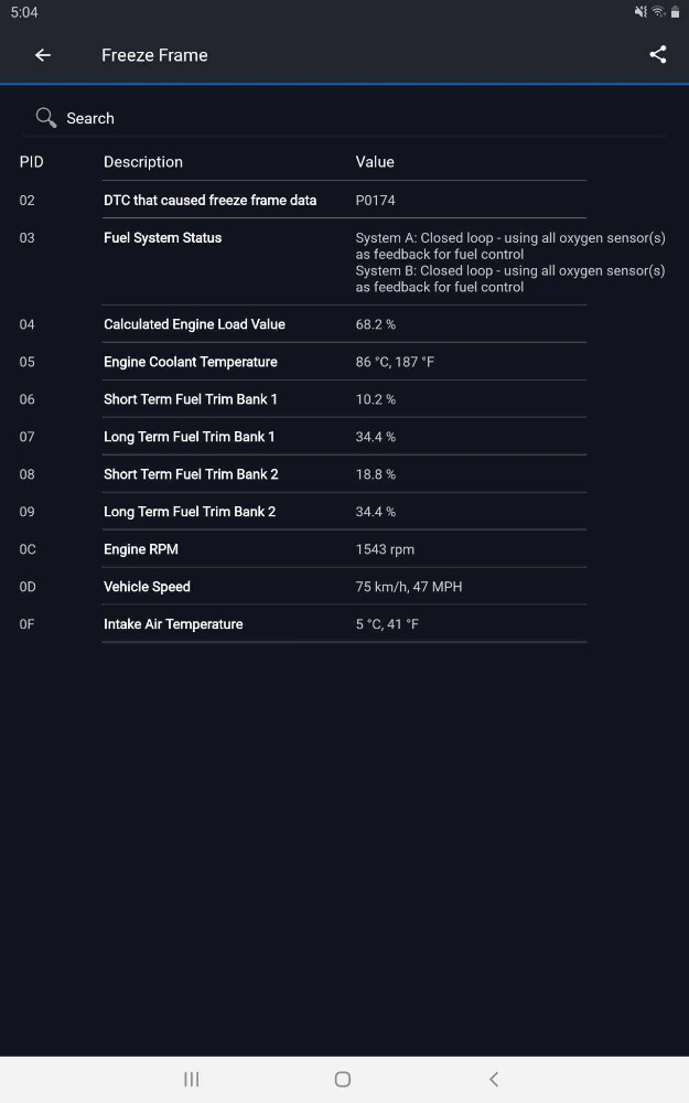

Thanks for joining in Tyler. I added air temp today and noticed the reading way way off. Not sure what that means, but it said air temp was 30 degrees when it should have been about 5 or 6. I swapped my fuel cap today, checked plugs, swapped for old MAF sensor, and re-checked fuel pressure at the rail. Old MAF seems to be working great, unlike the replacement I likely didnt need. Same issue. Starting was difficult. Took a 5 second cranking, release, and a second go to get it firing up. WOT test again shows O2 sensors drop to 0V instantly. So this is a fuel delivery issue even though I have good pressure at the rail? It is possible that I should be looking into the EVAP system? I'm just feeling so lost with this....  Thanks again for all the feedback!

Nice capture, James. Both upstreams going lean at WOT definitely suggests a lack of fuel delivery. It also suggests both cats are good. If one was plugged, you'd have one bank going rich, and one lean.
The MAF PID not changing is weird. But your Calculated Load max of 98% suggests that not only was the sensor working, but that the engine is breathing well. And the air mass is likely being measured correctly. If your BlueDriver will allow you to look at MAF sensor voltage in OEM data, you could use that as a check against the MAF g/s PID.
I'm not really worried about the IAT at the moment. The IAT doesn't have that much weight in the fuel delivery calculation, in my experience. Plus, the IAT is always going to read higher than ambient temperature due to being located under the hood. If you looked at IAT after a WOT run (underhood temps are high), that'd explain the large difference.
