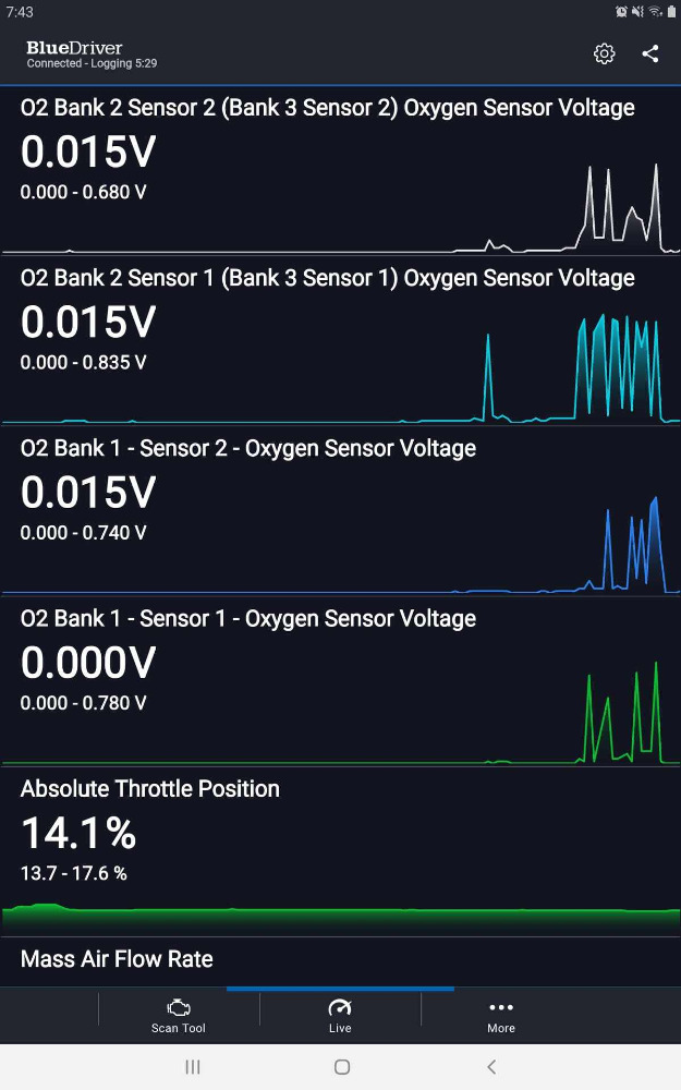

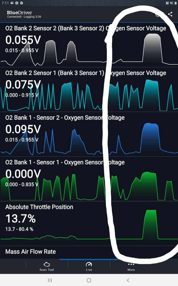

Just another update here. New regulator installed. Did not resolve any issues. I did some more testing while I wait for a fuel pump to arrive. Smoke test on exhaust and intake didn't reveal any leaks. I spent an hour looking for wiring issues and bad grounds (found one) thinking it would solve the no data for O2 sensors issue. Called my father and he informed me that they won't read anything if the engine is extremely lean. I didn't think the engine would even run if it were that lean, but I guess it does. So I moved to the propane test. Gave the intake a good shot from the tiger torch and the O2 sensors came alive! Screenshot attached.

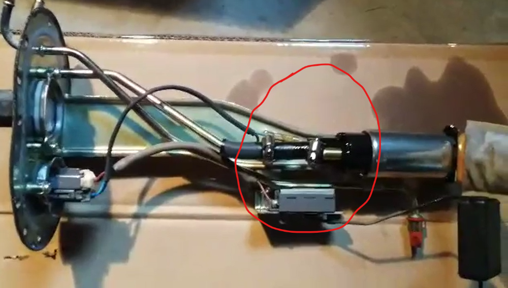

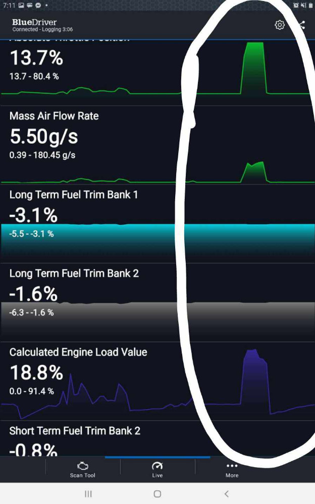

Final update here. When the shop installed the new fuel pump, they decided not to replace the 3 inch fuel line that needs to be clamped inbetween the pump and feed line. Instead, they just forced the old one (hard as a rock) over the very tip on the fuel pump outlet and called it good. So, there was pressure, but most of fuel flow was just shooting back into the tank. It explains the strange intermittent nature of this issue and why is wasn't crystal clear. Thank you all so much for teaching me to just trust the data! Everyone else I consulted kept telling me it can't be a fuel pump doing that. I guess it wasn't really the pump, but I wouldn't have dropped the tank quite yet if I hadn't checked pressure again based on the data! New WOT data attached.

Those long term trims look far better than the ones first posted when you started this thread. Well done.
