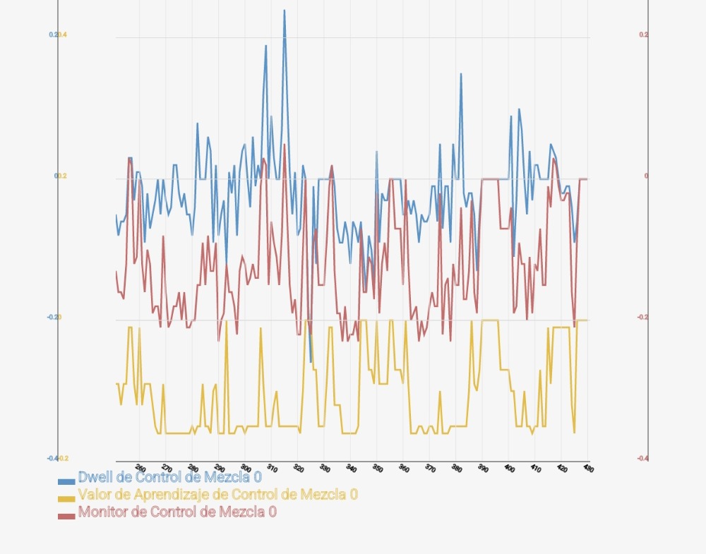

I Have a Suzuki grand vitara ( it was a chevy tracker in the states) 2 liters 1999 but i dont think that matters much. That being said, i was checking the fuel trims the other day and at idle they were fine +-3% but once i step on the pedal they go negative quite a lot (-10/-15).
Went for a drive and at WOT trims were 0 but as soon as i step out of it they went negative. Any idea what could cause it?
​Yellow line is throtle
Red line is long fuel trim
Blue line is rpm

Could be nothing. You need to also take short term fuel trim into account. I wouldn't chase -10% personally,(especially if there is no code or driveability complaint) -15% is pushing it, but if the STFT is for example +5 while LTFT is -15, total trim would be -10 and perfectly normal.

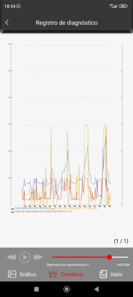

Was checking the trims and they are all mostly negative
What bothers me is why at WOT trims are 0 and everywhere else except at idle are quite negative.
Blue line is short trim
Yellow line is long trim
Red line is the sum of both
Red line goes from 0 to -20

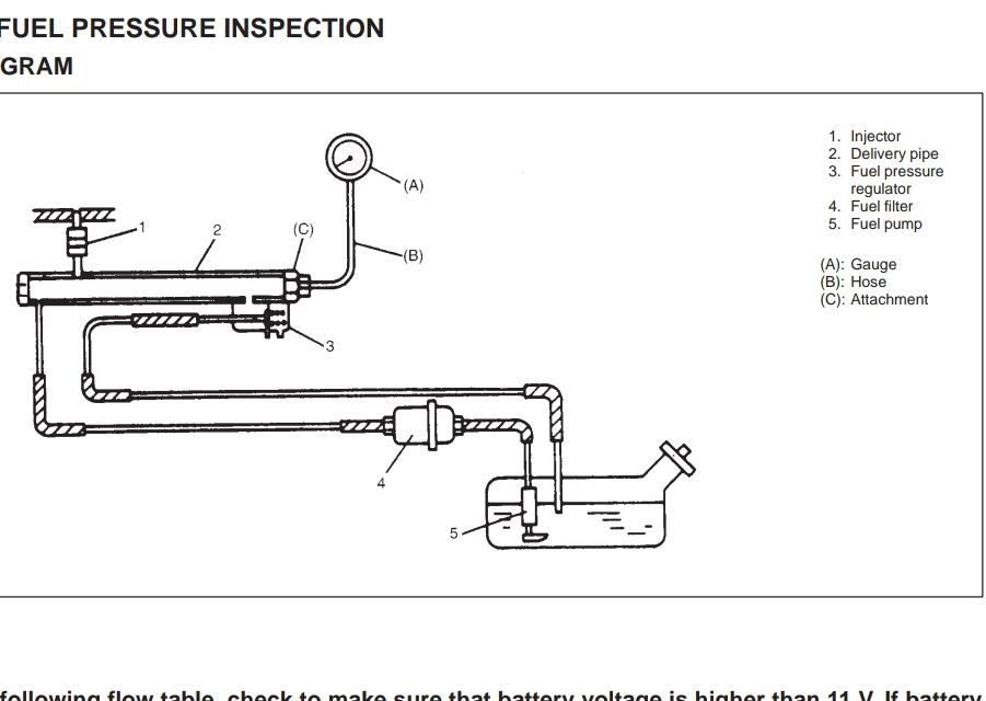

I would find the fuel pressure specs and do a fuel pressure check.

I think this is a mechanical return fuel system..Is your pressure regulator on the return line? If it is, pull vacuum hose off and ensure no fuel is there.

Yes it's in the return line
And you mean to check if there's no fuel on the vacuum hose? If thats the case there's not
2 years 8 months ago #64616 by bills4065
Replied by bills4065 on topic Fuel trims
Good, no fuel. Diaphragm is good. Since we are right here, I would put pressure tester back on and disconnect vacuum line. Fuel pressure should increase.

Fuel pressure is good. It's on the lower side of the specs. If vacuum is disconnected it increases about 5 psi so the regulator is ok. Thought it could be a clogged cat or muffler but did a back pressure test and pressure was fine

I think I would do a wide open throttle run and only graph the oxygen sensors for their reaction at a wide open throttle run. I would not worry about the fuel trims on this run. After this, figure out what my next step would be after seeing O2 responses. This is just what I would do.
  • Vincent valentine
  • Vincent valentine's Avatar Topic Author
2 years 8 months ago - 2 years 8 months ago #64621 by Vincent valentine
Replied by Vincent valentine on topic Fuel trims
At wide open o2 sensor goes full rich (about 850mv)
Fuel trims at 0
