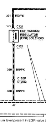

9 years 3 months ago #11243 by Tyler
Replied by Tyler on topic Re:RE: Re:2001 Ford F150 P0401 code
jayta98 wrote: I'm still trying to figure out why did the EVR test failed... I followed the video and nothing happened. I guess I can try using an actual piece of wire to left cable as see if the engine idles rough. I tried using my test light (LED) and nothing happened.
I'm starting to suspect if the issue related to the EGR solenoid. Like the signal to the solenoid is not been sent. I have an extra solenoid laying around and swapped it out. I got the same results.
Really? :blink: We're onto something there. KOEO, what are the voltages on the two EVR wires?
Wiring diagram for reference:
If you happen to have an incandescent test light around, try that one instead, as the LED will never carry enough current to energize that solenoid. If the test light doesn't work, try a jumper wire to ground. Just make certain you're on the brown/pink wire. ;-)

9 years 3 months ago - 9 years 3 months ago #11245 by jayta98
Replied by jayta98 on topic Re:RE: Re:2001 Ford F150 P0401 code
KOEO with the electrical plug connected to the solenoid I have 12v on each wire. If I unplug the wire connector and measure the voltage I have 12v on the red/yellow wire and the brown/pink is ground.
So if I'm going to use a jumper wire to test the EVR test like showed in the video I'm going to use the jumper wire from battery ground to the brown/pink wire I should see the engine stall a little and the DPFE voltage should increase, correct? I just want to make sure I don't fry my PCM when using the jumper wire. So from battery ground to brown/pink wire? Sorry to ask twice but i want to make sure.
Thanks everyone for stepping in and help. I have this problem for about a year now. I will like to resolve it.
