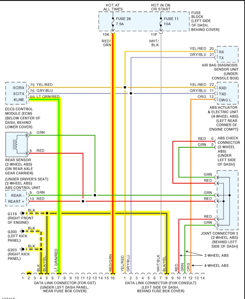

My Frontier has no communication with either diagnostic port (16 pin port or the Nissan Consultant port) so no scanner works (I tried several scanners).  I replaced a 7.5 A fuse that had been blown and that feeds 12 V to the 16 pin diagnostic port.  My symptom is a high idle (1,500 rpm at all times).  It began to have a high idle after running fine for years.  When I start the truck, I now hear multiple clicks from a blue solenoid under the dash, then the truck idles high all the time.  I tried replacing the blue solenoid with no improvement.  There is very little power when driving now.  I replaced the inlet air control IAC valve with no improvement.  I replaced vacuum lines and looked for vacuum leaks with no leaks found yet.  Do you think the throttle position sensors could be causing this condition?  I have various scanners that can be remote onto (Autel BT609 that is about 3 years old, a Topdon Pheonix Plus that is new).  Marty 850/597-1316.

Im just wondering if I am able to post wiring diagrams that I have from my subscription to Automotive Electricians Portal? I don't know if there is a prohibition on posting materials that I have a subscription to, but I guess not...
2 years 4 months ago #66025 by Noah
There has been no issue posting diagrams here on the forum.
  • Marti
  • Marti's Avatar Topic Author
2 years 4 months ago - 2 years 4 months ago #66027 by Marti
Here is the wiring diagram from automotive electricians portal

Any suggestion on getting communication on either the OBD2 or Nissan Consult connector for diagnostics? Do I look for resistance with all the power off? Which pins do I check ohms, and which of the 2 diagnostic ports...
2 years 3 months ago #66131 by Monde
Yes there is now power on the 16 pin OBD port and the two grounds are there but no communication with any scanner. I'll attach a wiring diagram of this system in my next message, about 6 PM today. Thanks
How about the K-Line on the 16 pins connector (OBD2)? If you have a breakout box, you could  connect the scanner on the obd2 port and see if you have activity on pin 7 at the box when you are attempting to communicate. Since the truck runs, most likely the resistors are fine. If you want to check them, ohm pin 6 and 14. 60 ohms is ideal.
2 years 3 months ago - 2 years 3 months ago #66132 by Chad
There is not much to the communication with the ECM via the OBD2 DLC.
First, make sure that you have good battery voltage on Pin #16, and good grounds on Pins #4 and #5 of the DLC.
Next, as Monde suggested, check for voltage activity on Pin #7.
The K-line (pin #7) should have 12 volts when there is no network activity,  and toggle to ground with communication.
That's all there is to it. If you find you have nothing on Pin #7, you need to go to the ECM, Pin #69, and check there.

2 years 3 months ago #66230 by Marti
With key on engine off (KOEO) there is 7.7 volts on the K line (pin 7). It goes to about 9 volts with engine on. Pin 16 shows 12 v with KOEO and 14 volts with engine on. The two can lines 6 and 14 show no continuity with the ohm meter connected between these pins. What's the next test?
  • Marti
2 years 3 months ago #66231 by Marti
I did not have the scanner on and trying to communicate when I tested the pin 7 of the OBDII connector. Should I try to put an oscilloscope on pin 7 and try to communicate?
2 years 3 months ago #66232 by Monde
Do that and see if the voltage drops as the scanner tries to communicate.
2 years 3 months ago #66238 by Chad
 A quiet, idle K-line should have 12 volts. If you are using a volt meter, and there is something that is trying to communicate, such as a "babbling node",  you could be reading the average of a square-wave.
Yes. That will answer the question of whether you have low voltage on the K-line or, if there is something trying to communicate.
This vehicle does not use CAN. Pins 6 and 14 are not used.
