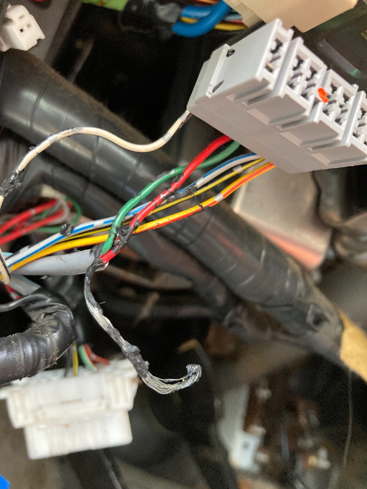

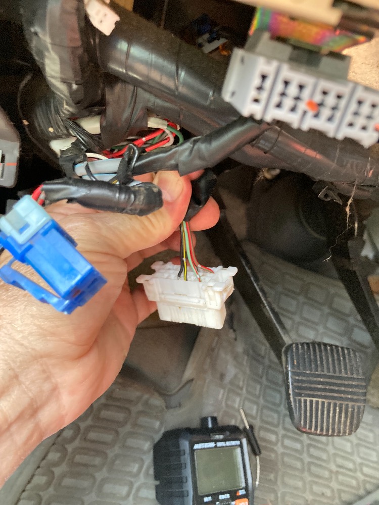

2 years 2 months ago #66521 by Marti
pics of wires to the diagnostic ports
2 years 2 months ago - 2 years 2 months ago #66524 by Monde
The wire colors seem to match the diagram. Red/ green( battery voltage)Black ( ground) Light green/red (K-line) Black/ Yellow (ground)
As you have the wires in front of you, check the K-line again if you see they match. If it shows OL, which I doubt because you had voltage on the K-line at some point during testing.

2 years 2 months ago #66537 by Marti
the k line at the OBD2 diagnostic port goes to or has continuity with pin 74 at the ECU.  Im looking for the connection plugs shown on the pin out you sent for the ECU, that go between each of the diagnostic ports because they changed the dashboard/instrument panel and may have got the plugs crossed.  I wish I knew the location for the two connectors on these lines.  I may have to pull the dash apart to find them…

2 years 2 months ago #66538 by Marti
Earlier I think I confused pin 69 and pin 74 at the ECU connector because they are difficult to distinguish and there are no numbers on the holes in the connector.  Do you have any information on the location of connector 14 from the ECU pin out diagram you sent?
2 years 2 months ago - 2 years 2 months ago #66544 by Monde
Unfortunately, no. You can go by wire color. I will post the ECU pin layout.
The file exceed the limit. If you look at the bottom of the diagram I posted. you should see the ECM pin layout. Pin 68 and 69 (second row)are above pin 74.

2 years 2 months ago #66622 by Marti
Checking the K line at the female ECU plug has been difficult to determine which pin is which.  I took the back off the female plug and I can now see which pin is 69.  It shows 1 ohm resistance to the OBD2 port for the k line (pin 7).  What I thought was pin 74 was pin 69.  My bad.  I'll check the powers and grounds again since I may have got the pins wrong on these...I'll send pics.
