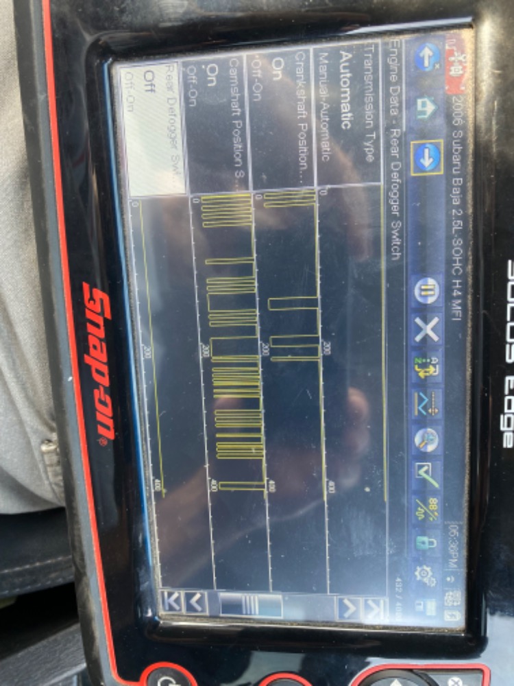

2 years 3 months ago #66246 by Buckeye57
Replied by Buckeye57 on topic Turns over, no start, no spark, no dtc’s
I borrowed a Solus Edge and I think I spotted the problem. I attached a screenshot. Would I be correct in saying the CPS is defective? Shouldn’t it be showing a squarewave all the time?
At higher rpm’s the signal would have large gaps. At idle more would show up.

2 years 3 months ago #66248 by Monde
Replied by Monde on topic Turns over, no start, no spark, no dtc’s
Both signals look kind of weird, but crank looks worse.
Usually with a crank or cam sensor issue, you lose both spark and injection pulse. Are you missing injection pulse as well?

2 years 3 months ago #66250 by Buckeye57
I replaced the crank sensor and I ran it for 30 min and didn’t have any issues. I plan to go for a drive in the morning around the neighborhood with the Solex plugged in.

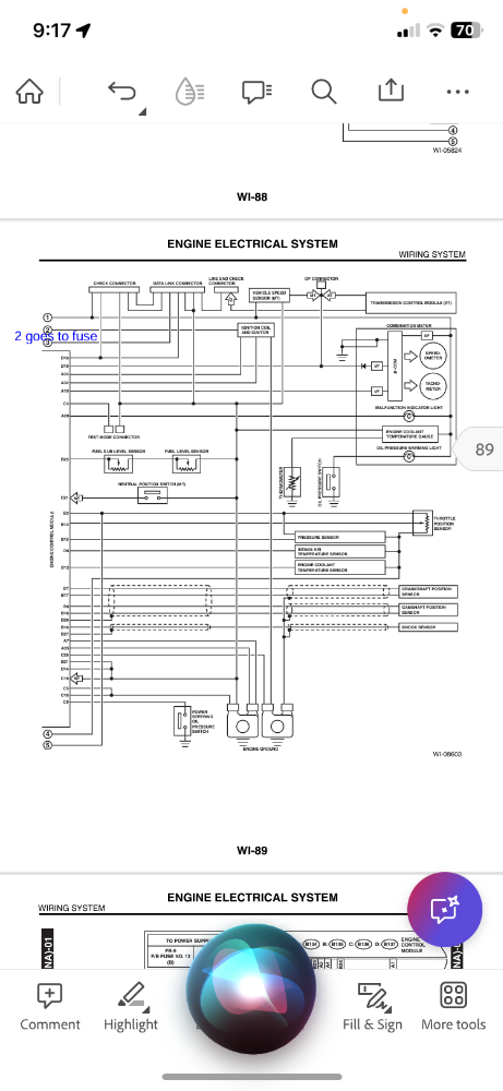

2 years 3 months ago - 2 years 3 months ago #66270 by Buckeye57
LOL, I watched that video yesterday.
I have attached a engine schematic.

2 years 3 months ago - 2 years 3 months ago #66272 by Monde
Does this happen to be your ignition coil and ignitor wiring diagram?
Has your car been a crank no start since you replaced the crank sensor or has it been intermittently starting? Have you ever tried scoping the 4 wires going to the coil doing cranking or before stalling?

2 years 3 months ago #66273 by Buckeye57
Yes, that contains the coil pack wiring.
