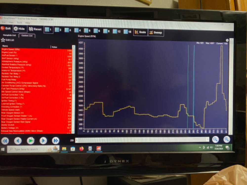

I ran around the neighborhood this morning and while recording the live data, the vehicle stalled and I rolled for a short distance.  Just before it stopped, it recovered. I pulled over and hit the save button. I downloaded the SnapOn smart stream software to view this file. The screen shot of the rpm signal shows the rpm drop at the 260 point as marked.
I will try to extract a report and upload it when I figure out how to do it.

2 years 3 months ago #66282 by Buckeye57
Replied by Buckeye57 on topic Turns over, no start, no spark, no dtc’s
 Between the vertical lines is where the stall happens. I had made a 90 degree turn, and after the turn the stall occurred. As I was coasting, it recovered as you can see in the scope picture. The first return to idle was the coasting, the second idle event was where I pulled over to save the file and look at the waveforms.

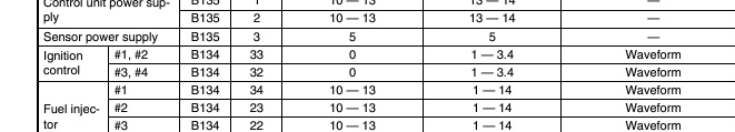

I checked all the items you listed and all items checked within limits, except for the 10v minimum from ECM to ignition coil. The signal is supposed to be between 1 and 3.4 vac. What I did was to monitor voltage of coil pack supply, signal voltage of one wire, and an inline spark tester. I got it started *and then it quit running. When cranking, it did not start after a long crank. What I noticed was the voltage supply never stopped, the signal wire showed around 2 vac, the spark tester showed no spark.
Hmm. Bad coil?
When I got it started* the first time I saw my setup show supply voltage 12.6, and the VOM on the signal wire of around 1.4  to   2.6vac, and the spark tester was flashing.

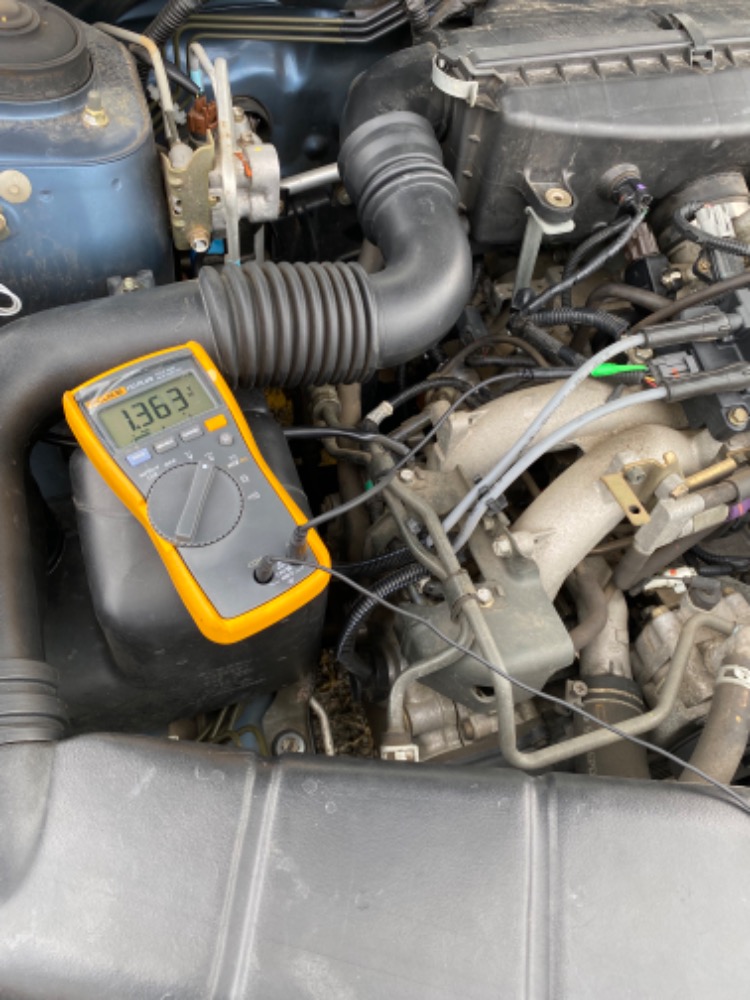

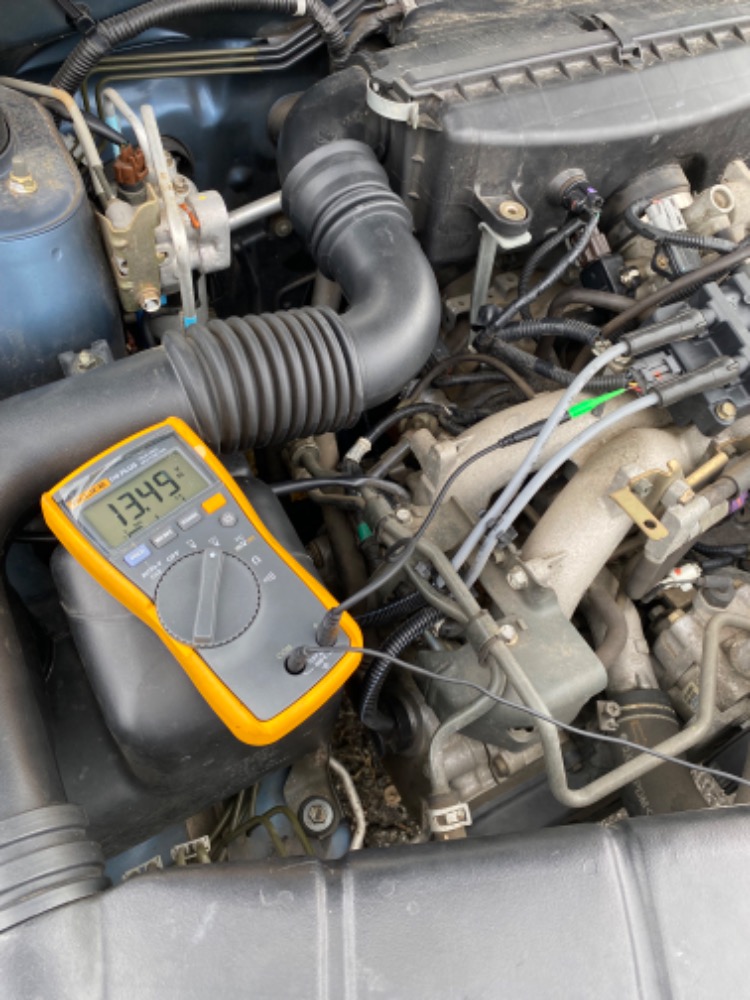

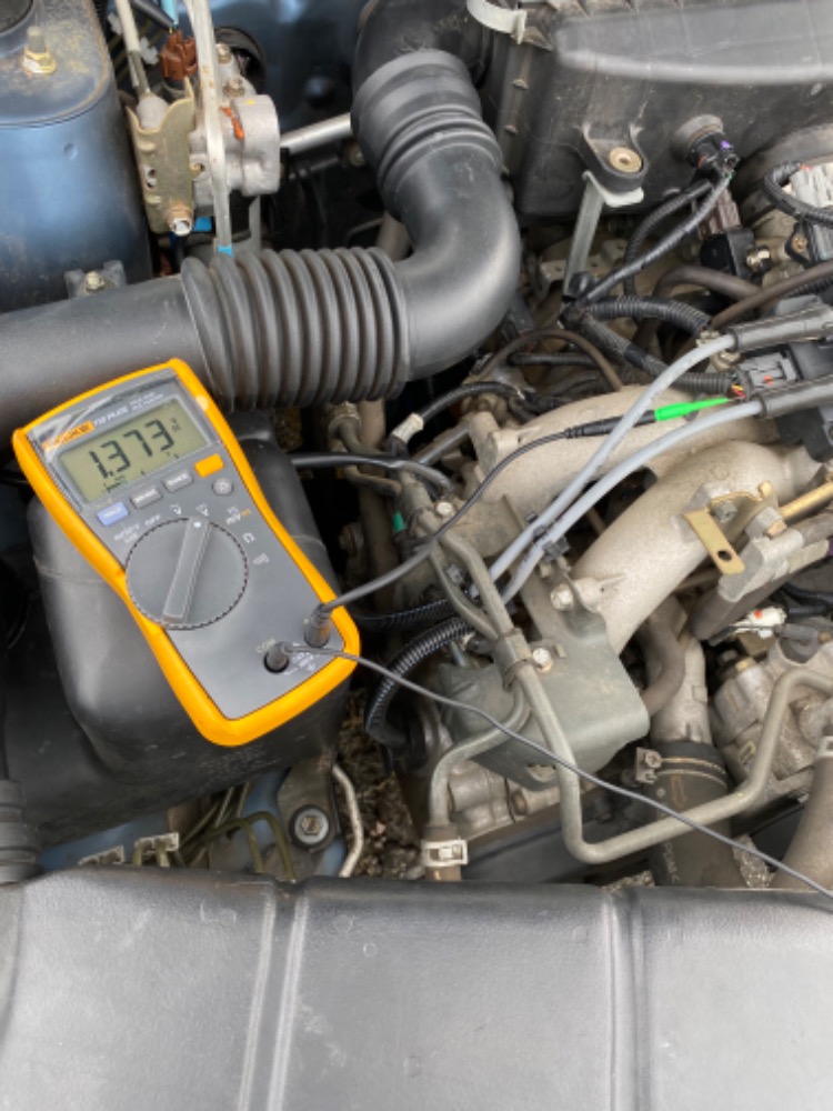

I connected my VOM as shown in the pics. The first 2 pics are reading pins 1&2. The last pic is showing the 12vdc input. The engine started and was running during these pics.
I walked away to keep my cool.
I put my spark tester/ signal setup back on and took a video. It did not start and noticed this time the signal voltage was 0.002vdc and the spark tester was not glowing.
I turned the key off, waited 20 seconds, and attempted a second start. It started. The same signal voltage was .9 to 1.6 vdc and the spark tester was flashing.
I am not sure what the voltage should be on the 2 wires coming from the ecm  with the car running. I do not have that information.  I can assume that .9 and 1.6 v may be correct since you have spark and .002v, incorrect when there is no spark. I attached a file on how to test the coil itself. Hopefully, it will help you determine if the coil is good or not.  is it possible that you can go back to the shop and see if they can try another coil or do a throughout  diagnosis?
The shop should be able to return the part and get a new one under warranty.
If you had not replaced the coil yet, I would  suggest  replacing it. It is a tough call that only can make.

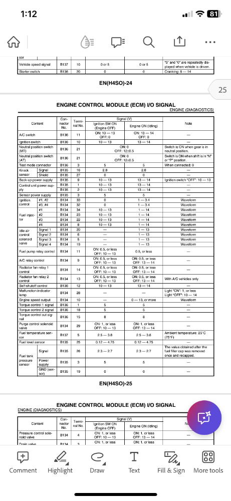

I have a question, why does your reference material and the Subaru diagnostic say the voltage on both of the signal wires is supposed to be 10v or more when cranking when the pin outs for the ECM show 0 for (Key on engine off), and 1.0 to 3.4 with (engine running)?
I wonder if I was to unplug the coil connector and monitor the voltage of the signal wires while cranking. What would that tell me if I was to measure 10-12v?
I would think the ECM is my problem.
