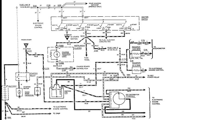

I have a FORD 1989 F-150 4.9L pick up.
The truck just died and will not start.
Using test procedures from Haynes and the Internet I first tested the spark from the coil tower with my test light and there is no spark.
I made a 12V led light to test the signal on the ICM after testing for power and ground at the connector, all was good!
Oh yes I tested the computer relay also and put in a new one.
Trying to not leave anything out.
When the ICM showed good I just bought a new MOTORCRAFT Ignition coil and put it in. (the old one had 300,000 miles on it!)
Put in the new ignition coil and sometimes I get spark sometimes not?
Checked the signal wire from ICM to IC and it has continuity?
Everything should be good but I'm now at a loss on what to do next???
Any ideas on where to go next would be appreciated!!!

are you getting 12 volts at one of the coil wires? check it under a load. id start there.

I just started completely over in my testing.
Checked the IC for power and it is good.
Then checked it for a pulse signal and there was none.
Went to the ICM....ground and power is good, but...
Now no PIP Signal !
pulled the spout and engine does not crank.
This is confussing as I had the PIP signal before, but???
I'm going to see if I can rebuild a OEM ford dizzy with new MOTORCRAFT PIP sensor and ICM.
The dizzy in it now is a OEM junkyard find and worked for awhile I guess.
I don't know what else to try, need to get this going!

Put in the new rebuilt dizzy and got nothing?
I retested the coil, I got power on the positive and no flashing on the signal.
I did an ohm's test on the signal wire from the coil to the #5 signal coil ICM terminal and have continuity???
I back probed the #5 on the ICM and got 5 volts on my vom meter while cranking?
This is all GOOD by the test but I have no spark at the brand new coil?
My battery is now dead from the testing and I'm recharging it.
Oh yea, all of this is going on in a parking lot where I work so I'm having a ball!
If ANYONE here has any ideas, I'm all ears!
Probably pull the computer next as this is not going well by the book of testing and finding solutions!

could try tapping the signal wire to the coil to ground see if it sparks.

have you seen this article??
easyautodiagnostics.com/ford/4.9L-5.0L-5...ition-module-tests-5
i would definetly check the pip sensor. i havent messed with one of these in 15 years or so

cheryl hartkorn wrote: could try tapping the signal wire to the coil to ground see if it sparks.
Hi,
So, I understand the ICM gives the ground to the ignition coil off and on from the PIP Sensor, to make the coil "spark"?
If grounding that line at the coil, makes the coil spark then there HAS TO BE a short in that wire even if I get continuity???
Thanks for the help!
I do appreciate it, but I'm now a little aggravated with this!
I don't think any thing was wrong with the JY Ford dizzy but I have to follow the trail and try to make it better as I go.
This problem COULD of been anything I have already renewed???
I feel I'm missing something and it is something stupid, but I don't know what?

I'd still be suspecting the ICM at this point simply because I've seen so many fail. Try looking at some tests here though-

I think I may have stumbled on a clue.
I think maybe I have a short in the RF noise capacitor....
And THAT is keeping the coil from sparking???
I'm going to look under the coil and do some tracing and see if that is it?
Thanks for the help, if this is not it, I will get back!
8 years 11 months ago #13415 by Tyler
Replied by Tyler on topic 1989 F-150 4.9L No Spark!
Possible? The only way that could be true is if it was a direct short, causing the fusible link to burn, and interrupting power to the coil and ICM.
Normally, the engine WILL run without the capacitor. So, if you have any doubts, you can disconnect it for now.

you said you dont have a pip signal. that comes from the distributor. sounds to me the "new" distributor might have a bad pip. do you have a scope??
