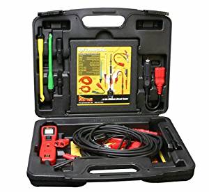

  • seagiant
  • seagiant's Avatar Topic Author
8 years 11 months ago - 8 years 11 months ago #13501 by seagiant
Replied by seagiant on topic 1989 F-150 4.9L No Spark!
Hi,
Well.....I just bought a Power Probe 3.....
My test light sucks, so I thought why not crank it up a few notches!
I'm going to find out what is going on with these wires one way or the other!
Last edit: 8 years 11 months ago by seagiant.

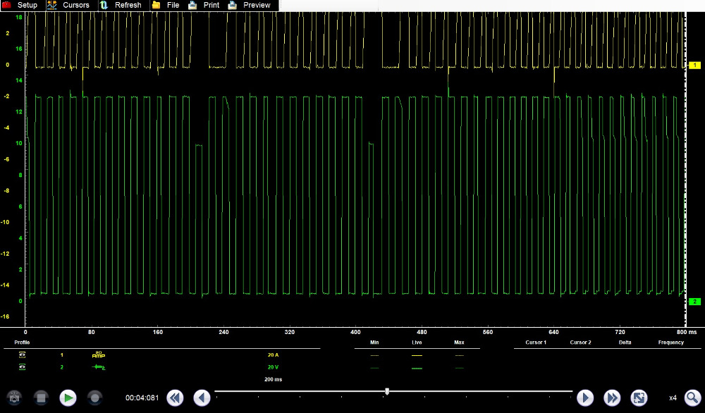

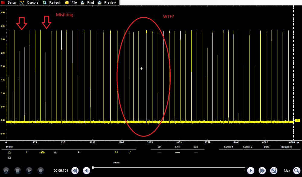

8 years 11 months ago #13510 by Tyler
Replied by Tyler on topic 1989 F-150 4.9L No Spark!
seagiant wrote: With the OBD-1 on the old truck, I don't know how good these sophisticated scopes would be?
Very useful! In my experience, anyway.
This is an example of a PIP signal I took off an early 90's F-150 last week. The glitch is obvious when looking at it this way, but I'm pretty sure a DVOM would have struggled to catch it:
The scope also opens up secondary ignition and current probe testing. ;-) Again, off that same F-150, the current ramp for one of the injector drivers. This waveform made the cause of the running issue clear as day for me:
I'm NOT saying you need one to fix your truck. I just find that it helps me understand what's happening in a circuit.
The following user(s) said Thank You: seagiant

Hi,
Thanks for that!
I'm going to run the tests from my Haynes Manual and write everything down with results!
I actually suspect the signal wire in the harness from the ICM harness to the ignition coil harness?
But, I will start over and see what I come up with, I'm hoping that the PP3 will let me know how solid the continuity is, on the wires I test, BETTER, than the VOM meter???
Supposedly the red green lights for power and ground will flicker or sound broken if the wire is "iffy"!
I believe the parts are good but there is a problem or short somewhere?
This would of been done a week or more ago, if it was just a bad part!
Thanks again!
