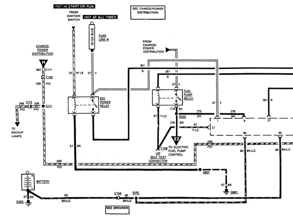

Ok I did some testing today and after watching a vid where "reference voltage" was mentioned by back probing the TPS sensor on the top or orange wire I got 1.5V!
I believe the correct voltage is about 5V?
I then went to the EEC power relay and found that the #3 wire, the one that feeds everything when connected to the #4 wire from the fusible links at the starter selinoid....
Was only putting out 4.9V!
This should be around 12V from the info I have.
Oh yea the #4 wire that comes from the fusible links IS giving 12V???
The #3 that connects to the #4, is only giving out 4.9 as I said???
Oh yea, this is a brand new Motorcraft relay!
Could all this problem be a BAD brand new relay?
What about the relay connector?
Anyway to test that?
Any thoughts on this is appreciated!
Orange/white? That's definitely the 5V feed, shared with the MAP and EGR position sensor.\
For clarity, I grabbed the EEC relay diagram:
You're saying that, with the key on, you've got 12V at the yellow wire, but 4.9 at the red wire? If so, you're absolutely looking at a voltage drop. It's possible that you have a bad 'new' relay, but I think it's more likely there's a connection issue. Those relays live in a crappy location, and I've personally seen the connectors corroded beyond repair. Pop the EEC relay out and have another good look at the pins. Any green crusties are a red flag.

Yes, I'm talking about the red wire not putting out the 12V it should!
I think in the Vid that Paul made about the 88 F-150 with the relay voltage problem was because of the #4 wire not having the right voltage coming from the fusable links at the selinoid.
I have a good voltage (12V) coming from there, my problem seems to be a drop at the connecter?
The relay is a NEW Motorcraft ($40!) I'm going to assume for NOW it is good?

Eager to hear what you find! For the record, there IS a way to test if the voltage drop is from the relay or the connector. It'd involve pulling the relay slightly out of its socket, so that the relay is still installed but the pins are exposed, and checking the load side pins for voltage.
This way, you could see if the relay is at fault, or the connector. Anyway, let me know when you're back at it! :cheer:

Ok, got back to the truck today and tested the NEW Motorcraft relay and it was bad???
Plugged in the Fuel pump relay that tested good and got 12V out of the red wire (Power out) and got 5.0V for a reference voltage out of the top orange wire on the TPS!
Truck would crank but not start again, with or without the spout connector installed!

Thanks for the update! :cheer: So, you swapped the fuel pump relay into the EEC relay socket, and got good power out of it. When you tried to start it, did you have another relay to install into the fuel pump socket? :huh:
Also, bad brand new relay. :lol: :silly: That's how it goes for parts these days. Coworker installed an alternator in a Mustang this afternoon - bad right out of the box. :angry:

Had a good day to day, actually got the truck to start!!!!!
Here's what happened, I got the new EEC relays and a Fuel Pump relay.
Put in the EEC relay and tested for spark at the coil.
I had spark !
Did a voltage test at the EEC relay power out wire (with key on)...
And once again only got 4.9v out???
Decided to run a jumper from B+ to the red power out wire.
I could hear the relay click when I applied power.
STILL no start, was going to call it a day when I started thinking about the Fuel Pump relay.
I now had a new one so why not?
Put it in, reran the jumper with the 12 v and the truck started!!!
So.......I still only have 4.9V coming out of the EEC relay???
I do have a new connector I could put in, I don't know what else it could be?
I checked the EEC relay ground again and it is good?
Last edit: 8 years 10 months ago by seagiant.
  • seagiant
  • seagiant's Avatar Topic Author
8 years 10 months ago #14214 by seagiant
Replied by seagiant on topic 1989 F-150 4.9L No Spark!
Hi,
Hey you guys don't be shy....
Tell me what you think about bad relay connectors and voltage drops??????
  • seagiant
8 years 10 months ago #14290 by seagiant
Hi,
Well this is one hell of a Forum!
I went and replaced the OEM connector with a new Borg Warner....
I STILL have the voltage drop!
This is THREE relays I have tried in this thing!
12.2V going in and 4.9V coming out.
Switch voltage is 11.8V and there is an excellent ground!
When I supply B+ voltage to the red supply (out) wire with my PP3 the truck starts and runs....
Of course when I pull it off it quits!
I'll admit it I'm lost on this but obviously missing something?
Any ideas Folks???????????????????????????????
