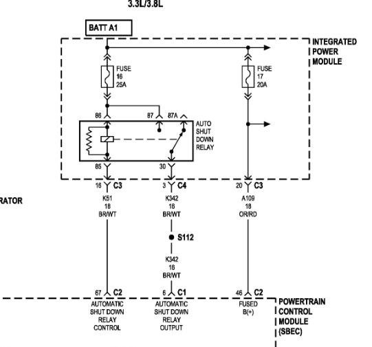

working on an 03 dodge grand caravan 3.8 cranks no start. finally got the service manual from Mopar. looking at the schematic I should have voltage potential at circuit 86 and 87. The 25a fuse is good. I have no voltage at 86 which should energize the relay. Am I correct in assuming that 86 and 87 are on the same wire coming out of the fuse? I have no ref voltage at the TPS which i am guessing gets voltage from the ASD relay. I checked circuit 85 which should be the ground side of the circuit and have good continuity to ground. What could be keeping the voltage from getting to 86 is it safe to jump 30 to 87 to see if the vehicle will start and run?
Last edit: 8 years 7 months ago by Mort.
8 years 7 months ago #16743 by Tyler
Replied by Tyler on topic Auto shutdown issue
Hey Mort! I did a quick edit of the title for clarity. ;-)
So you're testing at the ASD relay, correct? I had a look at the wiring diagram:
For our info, are you using a DMM or a test light? It looks like, KOEO, you should have voltage at pins 86 and 87 of the ASD relay socket. If Fuse #16 is good, but you don't have voltage on either of those pins, then that would suggest an open wire or a pin issue inside the IPM. You COULD jump between pins 87 and 30, but only if you're absolutely positive that you're jumping the correct pins, and that pin 87 actually has power like it should. I'd suggest waiting on jumping the relay until we have a better understanding of what's missing for the relay to work. ;-)
You've checked all pins at the TPS, and didn't find anything? That would suggest that the PCM isn't working, as it's the source of the 5V reference that the TPS uses to create signal.

8 years 7 months ago #16758 by Tyler
Mort wrote: Thanks for the quick reply. Ya I pulled 16 and have continuity between the negative side and 87 but nothing on 86 which has me stumped
Really? :huh: That's pretty much down to an IPM issue, then. Or the wiring/connections in it, anyway. You could verify this with a test light connected to B- on pins 86 and 87. If one lights but the other doesn't, then you've found the problem.
You could also partially install the relay (with the pins exposed), and connect your test light to B+. Touch on pin 86 and see if the relay now operates during cranking.

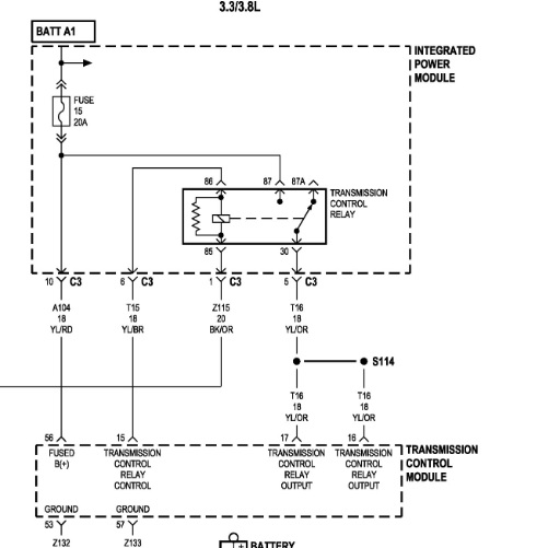

Ok I made a major FUBAR. the ASD circuit is good. I removed the IPM and realized I was looking at what the IPM cover calls the ETAX safety shutdown relay. the schematic calls it the transmission control relay. again I checked the fuse # 15 it is good I have continuity to 87 of the relay circuit and nothing at 86. looking at the schematic i see that voltage comes from the TCM with the IOEO If I am reading this right I should have voltage at 86. now I am thinking I have a bad wire between the TCM and IDM. yay or ney.
8 years 7 months ago #16875 by Tyler
:lol: No problem! At least you realized what happened before you swapped the IPM, or started cutting wires.
Again, looked up the diagram for reference:
Now, at this point I feel it necessary to point out that a problem with the transmission control relay won't cause a no start. Don't get me wrong - I'm totally happy to help you chase down this relay issue! :cheer: But if the engine isn't starting, then I think we need to back up and attack this from another direction.

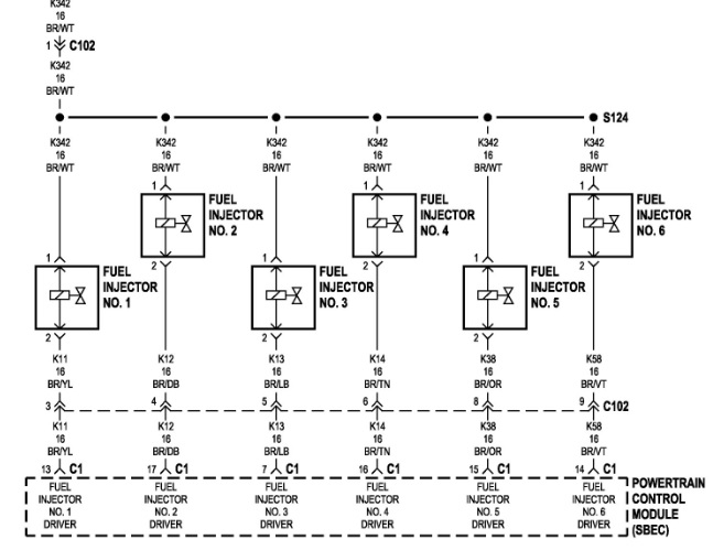

Your TPS and MAP sensor readings are very strange. :ohmy: I could understand how the TPS would have no voltage, but those MAP numbers are difficult to account for, especially because the TPS and the MAP get their 5V source out of the same PCM pin.
I say stay with the lack of power at the ignition coil. Back up that reading with a voltage check at pin 1 at C102 of the fuel injector harness during cranking:
If you still have no power, then we need to go back to the ASD relay. If we're sure the ASD relay is working, then we can trace a wiring problem in between.

Tyler I have rechecked the ASD relay. I have voltage at 86 and 87. I tried your suggestion of leasving the pins of the relay exposed and checked the voltage IOEO seems the ground side 85 has an open I then grounded my test light and made contact with the 85 side of the relay and it energized I am assuming this is grounded by the PCM Haven't checked the wire to the PCM. correct me if I am wrong, I should be able to check between 85 and pin 67 of C2 at the PCM for continuity..
8 years 7 months ago #17146 by Tyler
KOEO and you're seeing 12V at pin 85 of the ASD relay? That's normal, as the relay isn't grounded with just the key on. The engine has to be cranking (or running) for the ASD relay to get energized.
If you still don't see a ground at relay pin 85 during cranking, then absolutely, go to pin 67 of C2 and recheck during cranking. :cheer:
