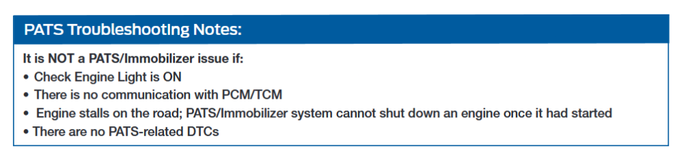

1 year 9 months ago #78404 by ferris48
I can't find any information regarding a PID called "ENG_IMB_STAT" on google nor in service info on PATS. The service info does point to a BCM PID "START_ENABLD" and it should say "Enabled" if everything's hunky-dory regarding PATS. I believe there's also a PCM PID "PATSENABL" which should also say "Enabled" but this PID was not mentioned in the PATS service info.
This pdf seems pertinent as well: www.fordservicecontent.com/ford_content/...ats_job_aid_2013.pdf
My understanding on the bullet points, the first one being the Check Engine Light being on (while cranking I assume) would seem to indicate that there's no RPM signal. The second bullet, if you had no communication with the PCM then PATS would be the least of your worries, and lastly, you have no PATS codes in the BCM, right?

1 year 9 months ago #78412 by lmg866
Your assumptions about the bullet points are correct: Check Engine Light on while cranking and no RPM signal on the scan tool, I have communication with the PCM, and no PATS-related DTCs. I have seen the PATS job aid and I have been able to successfully reprogram two keys. PATS seems happy.

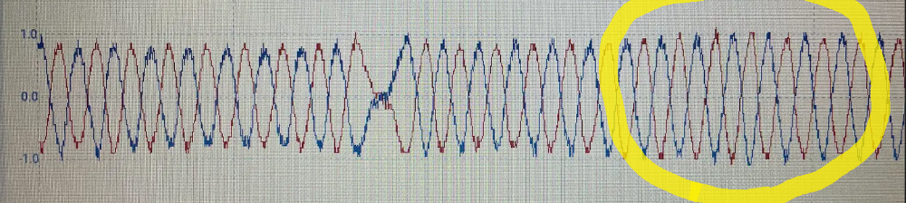

Most recent capture of CKP signal measured at PCM connector can hopefully be seen here:
drive.google.com/file/d/1gSOOERQn5ofAQAx...18/view?usp=drivesdk
1 year 9 months ago - 1 year 9 months ago #78416 by ferris48
I volt peak to peak voltage is achieved here which I circled. The sensor is doing it's job, the computer however is not. If your scope ground was at the battery negative your capture shows no DC bias from this computer. CEL doesn't go out while cranking, no RPM according to computer and missing 2 - 2.5 volts from the computer and you checked the connector? Looks like a bad computer to me.
Correction: you have 2 volts peak to peak which is very good.

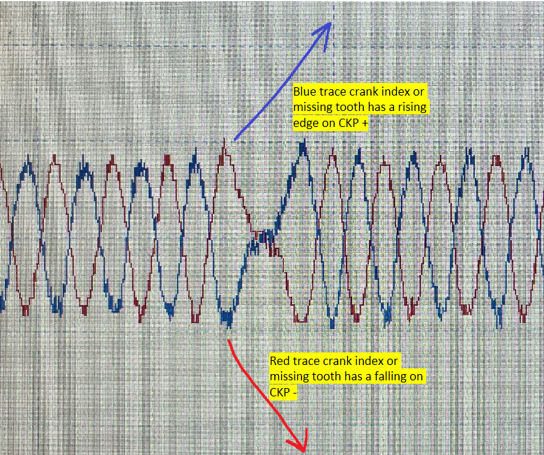

1 year 9 months ago #78425 by ferris48
The CKP + leg should have a rising edge and CKP - should have a falling edge. I have seen case studies on YouTube where is the wires were swapped it could cause a no start.
I don't think you have to worry about a short to ground as the voltage produced by this sensor is with well within expected norms. Check pin fitment at the computer one more time.

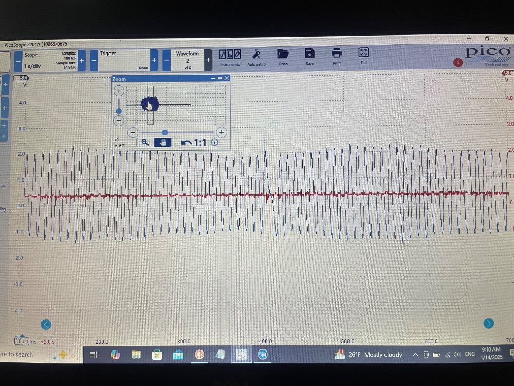

1 year 9 months ago - 1 year 9 months ago #78454 by lmg866
Interesting idea with the adding 2.5 volt reference to the CKP circuit.  While we are focusing on the issue of bias voltage, I'll clarify that I checked for bias voltage by measuring with positive multimeter lead at CKP+ and negative lead at battery negative, then postive at CKP-, negative at battery negative.  At this point I have measured three different voltages using that test: .5 volt, .18 volt, and .2 volt.  The capture I uploaded before was with scope negative leads detached--I guess this was my uneducated interpretation of the term "floating ground" :D.  Another capture is attached with scope channel 1 positive at CKP+, scope channel 2 positive at CKP-, and both scope negative leads at battery negative.
Last edit: 1 year 9 months ago by lmg866.
1 year 9 months ago #78456 by ferris48
It seems the the red trace, CKP+, has now lost its amplitude. It should mirror the blue signal.
What changed?
Can you get the red channel signal back by unplugging the computer and jumping the load side contracts of the Starter Relay inside the battery junction box? I have a sneaking suspicion that the computer's messing with that CKP+ signal.
1 year 9 months ago #78459 by bills4065
Your scope captures look like a failing crank sensor. You said you get an initial fuel prime when turn key on. The computer will not turn on fuel pump cranking if it does not see an rpm signal. Your check engine light stays on while cranking. Not saying that is it, but your symptoms are pointing at the crank sensor.
