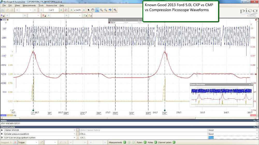

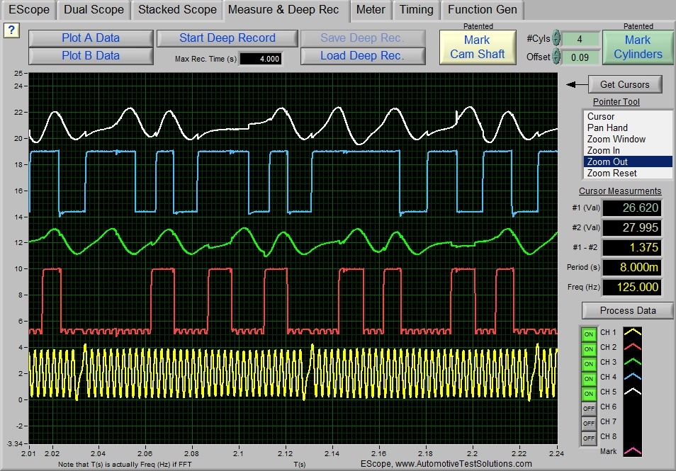

1 year 9 months ago - 1 year 9 months ago #79227 by ferris48
Here are some known good waveforms I found from diag.net but they're at 600-700 RPM with peak to peak voltage 4V roughly. They're kinda useless for comparison to your cranking waveform, except to show off the 2V bias from the computer. That would mean the scope was referencing battery negative for the capture and there was 2V bias voltage on this wire from the computer. Also note the rising edge for the crank index for the missing tooth. This also would mean that both captures were scoping the same wire, either ckp- or ckp+ . My money is on the scope was on ckp+

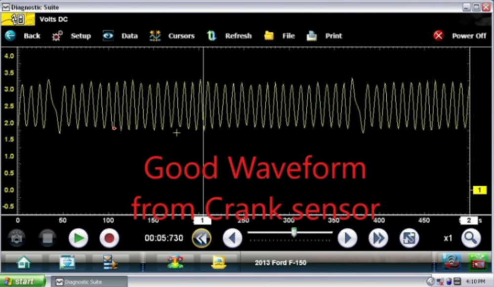

And then there is this YouTube video showing a cranking waveform:
Here is the screenshot from that video. The annotation is not mine.
The bias voltage is at 2.5V from the computer and 184 RPM and peak to peak voltage is 1V -1.5V roughly. The crank index is a falling edge. This means he was on the other ckp wire, whereas the 2 captures from diag.net were on the same wire. My money is on the scope was on ckp- that would explain why the crank index is a falling edge in this YouTube video. And scope negative is on battery negative. If his scope leads were switched around, then the bias voltage would be at negative 2.5V.
I wish I had another known good cranking waveform to analyze to be certain.
You bias voltage is way too low and I calculate your cranking RPM to be 171 RPM, roughly in line with the YouTube video, and your sensor is making peak to peak voltage of 3V. The YouTube video on a known good showed 1v-1.5V. Your sensor shows a flatline on the other wire which should not be. I think you wrote that the flatline signal was on ckp- wire which is concerning because your ckp+ is showing a falling edge for the crank index. I believe it should be the rising edge, but I could be wrong.
Right now the signs are pointing at this crank sensor.
