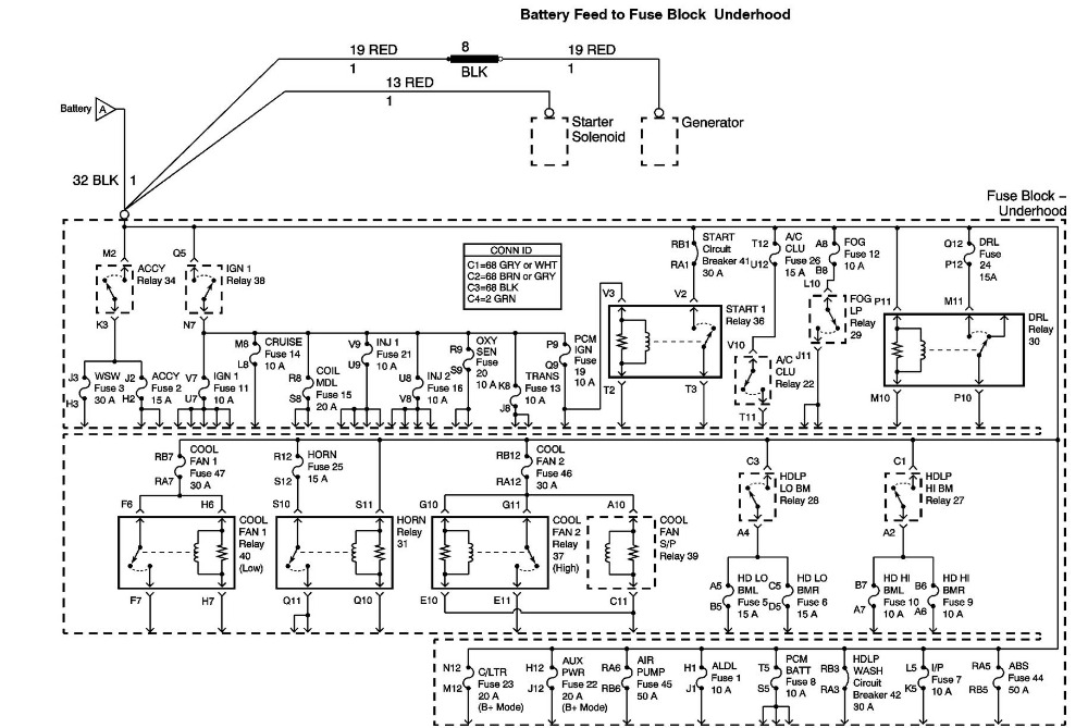

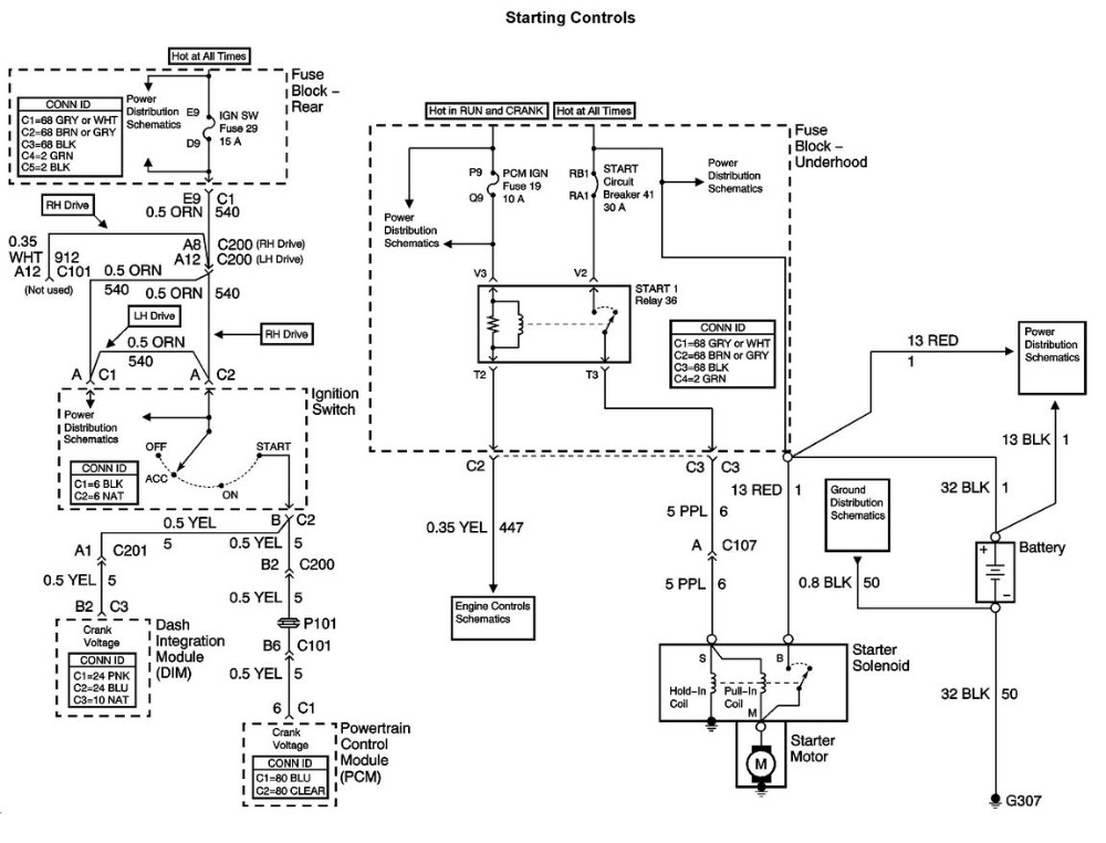

Ok I bought a 2004 cadillac Seville. Ran very good for 3 days. I pull in to shopping center car cuts off. I try to restart with no luck. Now next day car wont do anything. Check battery 12.6. Check up front at fuse box 12.6. Check all fuses fine. Buy a new starter because the one in it with my unionbox does nothing. Now I am sure its a ground. Dash lights up airbags working. Everything seems in order. Car does nothing. Can you help an old man out here. Thanks. Dave

Here is a wiring diagram for your starter circuit:
www.revbase.com/BBBMotor/Wd/DownloadPdf?id=79834
From your description it sounds like you have 2 issues, stalled & will not crank.Is this one of those starters under the intake manifold? If so, I would start at the starter relay & check powers & grounds. The starter should have constant power to the large cable, switched power to the small wire & be grounded to the engine/trans. Check the I/O's to the relay & let us know what you are missing.
Lets get the engine cranking, then move on to the stalling.

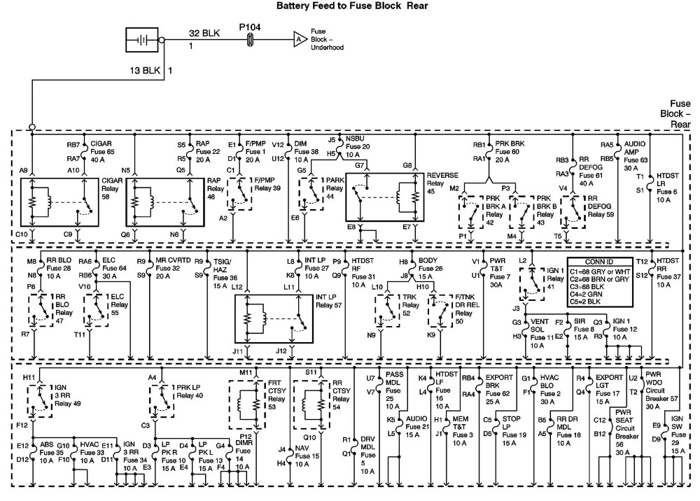

David56 wrote: Ok . Passed I went out today to fine my problem. Placing my hand on the fusebox in the back. It was hot. So I opened it and I think I found the source. Turns out my number 58 relay was very hot. Unplug the relay but when I put it back it started snapping. Then I could here things coming on. Seconds later I heard a pop and everything shut down. That's were I am. Thanks. Dave

Do you have power on any of the fuses in the fuse block under the rear seat?

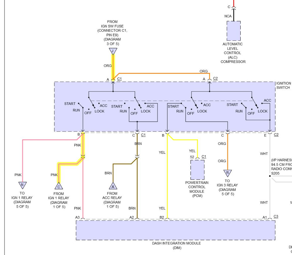

I put car back on charge. Back fusebox #10 & #23 do not light everything else does. In the front fusebox the following do not light #21 #16 #11 #20 #15 #19 #14 #13 #5 #6 #9 #10 . dash lights up again.

David56 wrote: In the front fusebox the following do not light #21 #16 #11 #20 #15 #19 #14 #13 #5 #6 #9 #10 .
Is this with the Key On? Or, off?

looks like you might have a bad ignition 1 relay in the front fuse box. what turns that relay on??
8 years 7 months ago #18670 by Chad
cheryl hartkorn wrote: looks like you might have a bad ignition 1 relay in the front fuse box. what turns that relay on??
Key in START or RUN

Yes that's the only place. Box in front nothing in middle works.

Yes power in backseat box. Just pulled ecm never seen a green and white wire.
