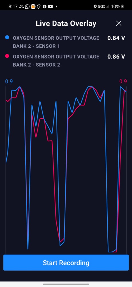

I've been battling this vehicle for a while. I randomly get a misfire code. And I'm always getting po172 po175. I also intermittently get a PO420 code. I'm back to thinking now it may be the catalytic converters. The vehicle has 152,000 miles on it. I just noticed while viewing my overlay between O2 sensors 1 and 2 from bank one and Bank two that the sensors are pretty much mimicking each other on the graph. And since I am very often getting a 420 code is it safe to assume the catalytic converters are bad? I did do a pyrometer test on the catalytic converters. And they are hotter leaving than they are entering by about a hundred degrees. Any help would be appreciated. Thanks

Both O2 signals are rich, suggesting a true rich condition. What are the O2 signals for bank 1?

It's identical on Bank One. Basically the downstream O2 sensor is mimicking the Upstream O2 sensor. I wish I could attach the video but it's too large. But basically both bank one and Bank two downstream O2 sensors are pretty much mimicking the Upstream and from my understanding they should be more of a straight line at the catalytic converters working correctly but I honestly don't know how it works. I will say that every time I get a check engine light and I go to the Freeze Frame it is always at low RPMs or idle so it's always whenever I'm sitting still or coasting from accelerating to a stop. I was monitoring the fuel trims while driving and under normal driving the fuel trims are acting correct within the 10%. But as soon as you let off the gas or stop the fuel trims go crazy. Hopefully this helps you help me

The mimicking of the rear O2s with the front O2s is due to the fact that the vehicle is running rich. The p0420 code can be resulted from the rear o2 stuck rich. Try fixing the rich condition first before attacking the p0420.

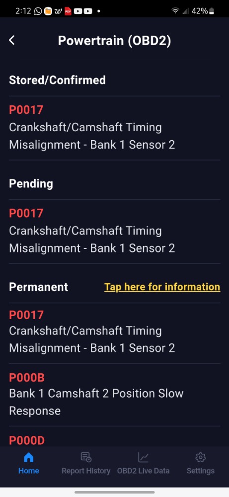

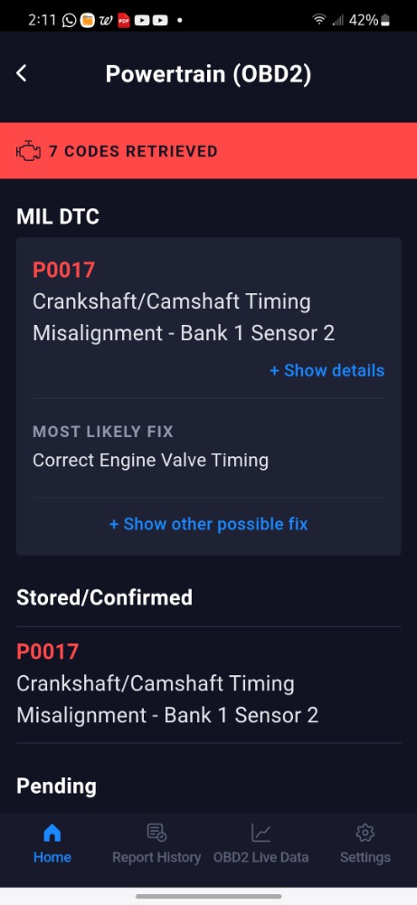

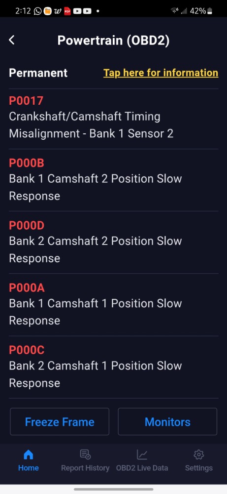

So to add to all my other issues I brought the van to a mechanic shop today because I don't have a scanner that will do a camshaft relearn and I was told that since the camshaft sensors are changed that it would be required. I took it to the mechanic shop they tried to do a relearn and it failed three times. I drove home and didn't really notice anything but traffic was heavy so I didn't go very fast. For this evening I took it for a ride now the van is stuck in limp mode with every code you can think of for camshaft sensor and timing
What are the codes it is setting now?
I can see there has been a lot of work done to try to correct this issue. Was there any engine repair work done before this issue? Anything that would have had the timing chain or camshafts removed?

So previous to this incident the van seemed to run fine but was running rich and throwing the po172 and po175 codes. I went to start it one day and it seemed to have some run on when it went to start. That's the best I can explain it. So a mechanic friend said he thought it was the camshaft sensors so I bought a set of camshaft and crankshaft sensors and had him replaced them. That was probably 3 months ago. The van ran okay after that that was still getting the codes po172 po175 but the run-on was gone. I had read online that these Vans required a relearn anytime the sensors were changed. So I thought it would be a good idea to go ahead and have that done. So I contact the local mechanic shop which said they could do the relearn and after they tried three times and it failed I took the van home. It was that afternoon when I learned it was in limp mode. It is throwing about five different slow to respond sensor codes and one crankshaft camshaft out of sync code as best I can remember. None of these codes were there previously to the relearn

Going to need to know what those codes are.
There's no point trying to diagnose a rich fuel mixture if the base mechanical systems are not sound.
That's why I was wondering if there was any major engine repair done that could have resulted in the chains being misaligned or the magnetic reluctors on the camshafts damaged or possibly installed in the wrong position.

I understand, and thanks for the help. I will get you those codes as soon as I'm back to the van. There was nothing done at all prior to the limp mode. And the van was running okay just getting the same 172,175 codes. Be changing of the camshaft and crankshaft sensors is done months ago. And I never got any codes after that about them until this relearn was performed. One of the other mechanics I had the van thought they may have been an issue with the timing and inspected the timing chain and timing and said everything there was good. I'll get you those codes
