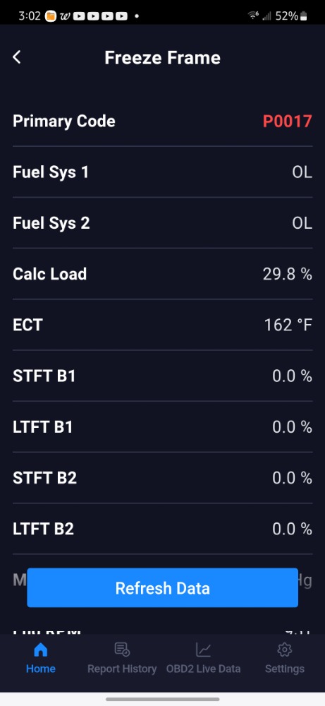

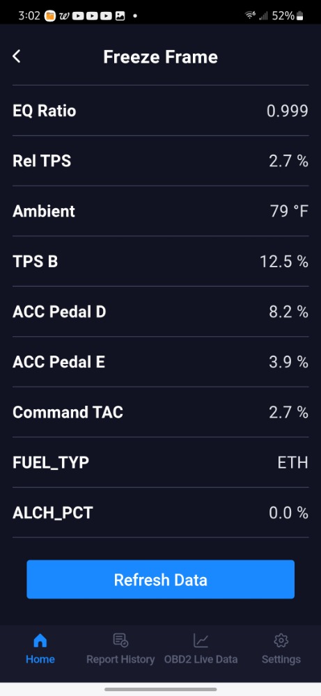

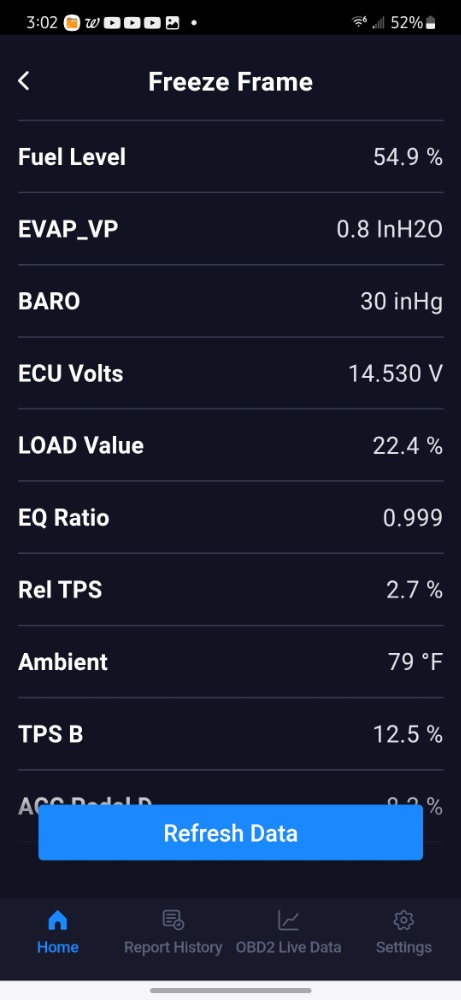

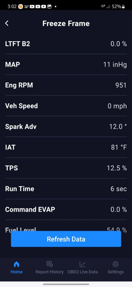

Can you post the Freeze Frame data for P0017? When the fault set might give a clue as to the problem.
  • DShock
  • DShock's Avatar Topic Author
1 year 8 months ago #82667 by DShock
Replied by DShock on topic 2015 chrysler T&C po175 po172 PO420
just for reference I don't know if you read all the posts but the problem has always been po175 po172. I've noticed through all the old freeze frames that it only happens either at idle or when coasting at low RPMs. I'm bringing it to a mechanic that did the relearn that failed that caused this issue on Tuesday.
