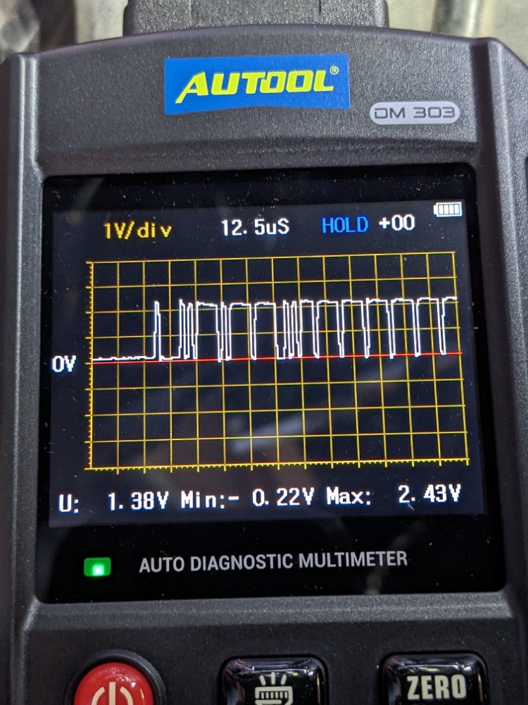

1 year 8 months ago #83514 by ChallengerDude
Here's what the can bus from the dlc looks like. Not sure what would cause that wave form.

1 year 8 months ago #83519 by ferris48
I think you have this single channel scope hooked like this: can high on red lead and can low on black lead. This would explain the absence of the bias voltage. To check for proper bus bias, you'd want to hook up your scope to battery negative.

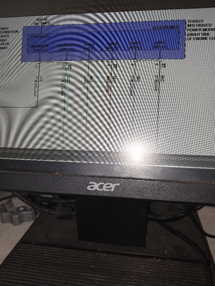

1 year 8 months ago #83603 by Monde
Can you provide the can bus diagram to us if possible?
Is that the diagram you have?
