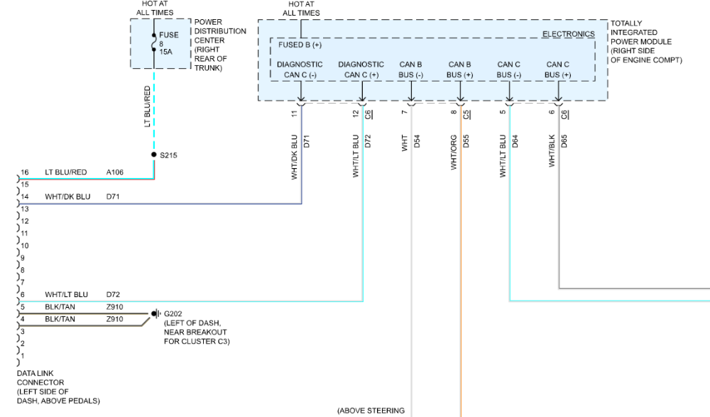

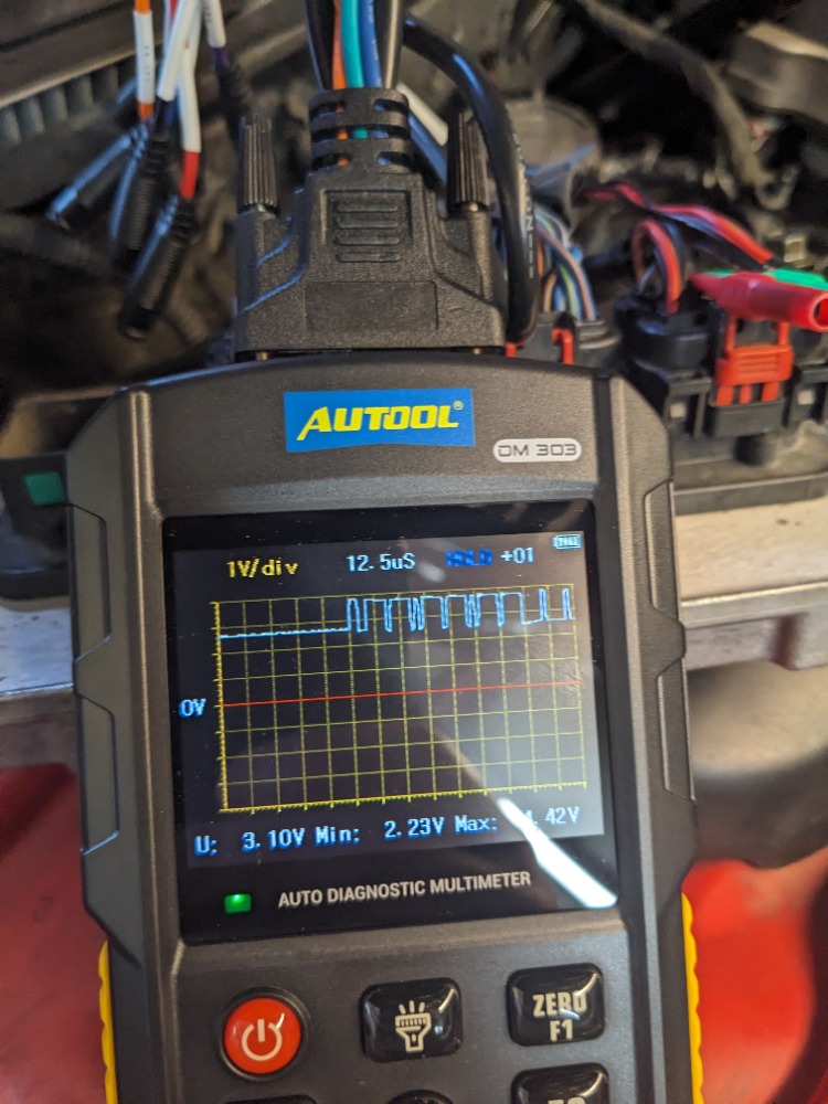

1 year 8 months ago #83604 by ChallengerDude
That's how I hooked it up. I'd hook it again with the black lead to battery negative.
  • ChallengerDude
  • ChallengerDude's Avatar Topic Author

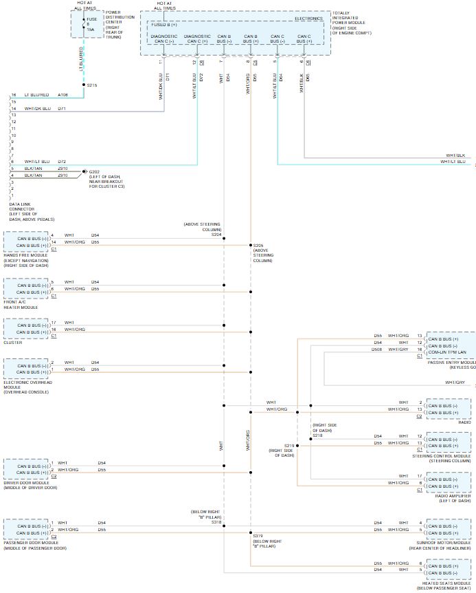

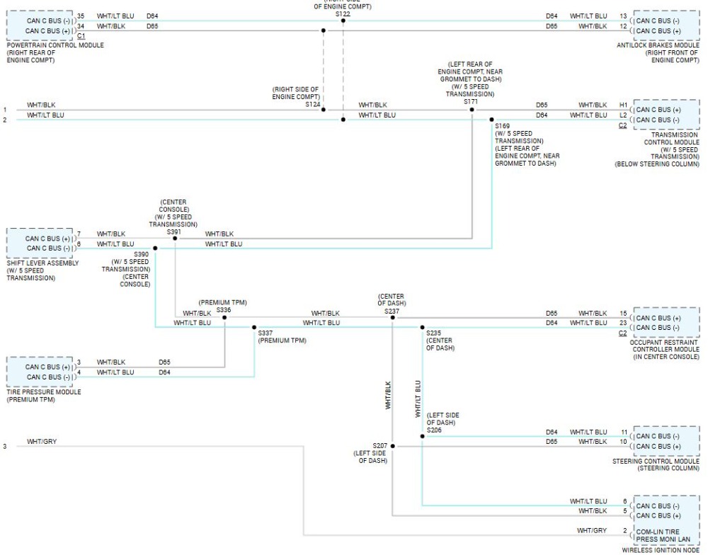

1 year 8 months ago #83607 by ChallengerDude
I'm going off these diagrams.

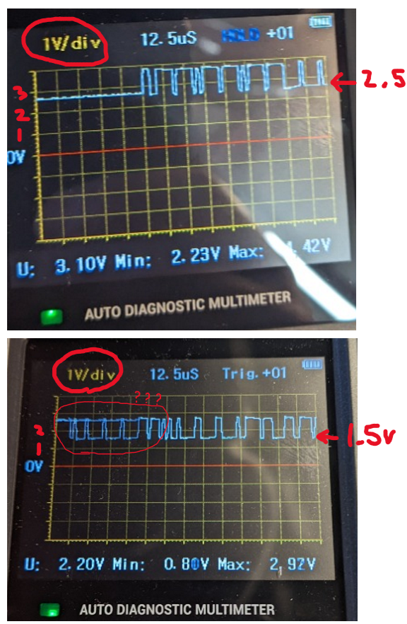

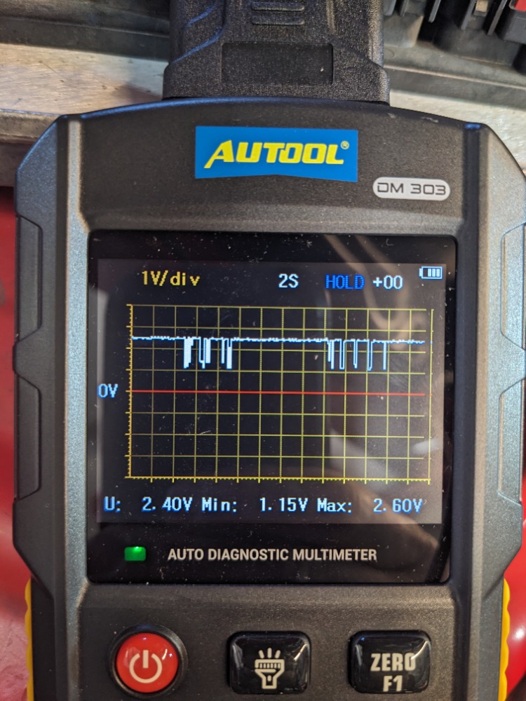

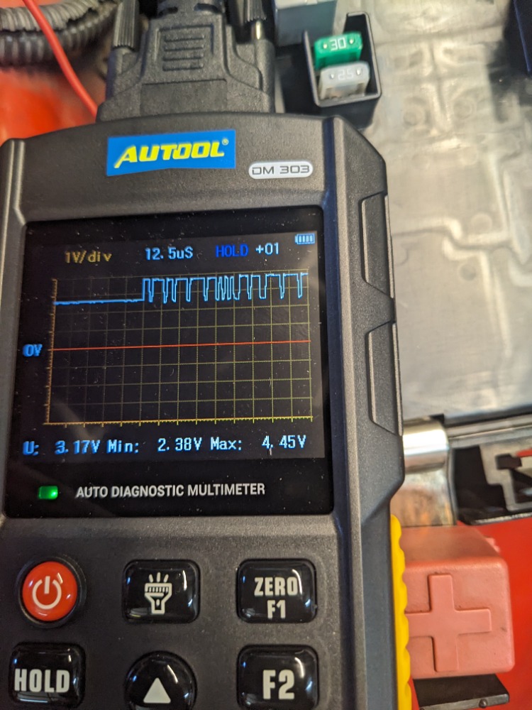

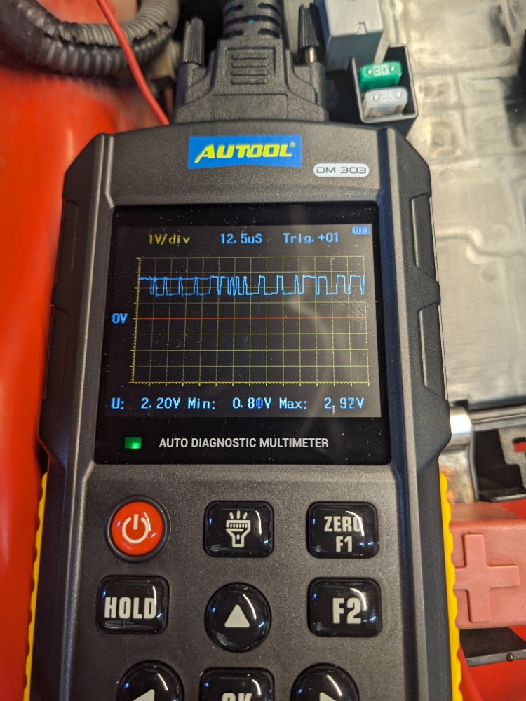

1 year 8 months ago #83610 by ChallengerDude
Here's some waveforms I pulled at the can lines on the pcm and tipm sides.

1 year 8 months ago - 1 year 8 months ago #83627 by Monde
Yeah, If i use obdlink, the can b bus is accessible but not the can c bus. Get a U0001 can c bus error.
I've gone through the wiring but don't see any other damage. The rebuilt PCM I tried has some corrosion on the pins. Not sure if it's also not working but the rebuilding is going to send another unit. There was or still is a rodent running around in the car. Not sure if there is some unseen wiring damage. But tried using the powerprobe short finder but didn't find anything.
In my opinion, If the pcm were the cause of the  CAN C bus error, you would most likely have a lot of echoes on the CAN lines  if the terminating resistance were missing unless the terminating resistance were fine, but the transceiver were bad. When you unplugged the pcm for can lines testing, you would have the communication back as it would be the reason that the bus were down. The pictures you posted  did not  show echoes. The quality of the pictures were in part due to the scope itself.

1 year 8 months ago #83631 by ferris48
The can bus lines at the TIPM measure 60ohms. The DLC shows 62ohms and no change with the PCM and WIN unplugged. The battery was disconnected.
That's great information, thanks for testing that.
For can high look for bias voltage of 2.5V and the signals jumping up to 3.5V. The first picture is obviously can high.
The second picture where I put question marks. Did the bias voltage drop down to 1.5V from 2.5V ?
The question marks I drew, I think that's image ghosting because of how fast the signal is going across the screen.

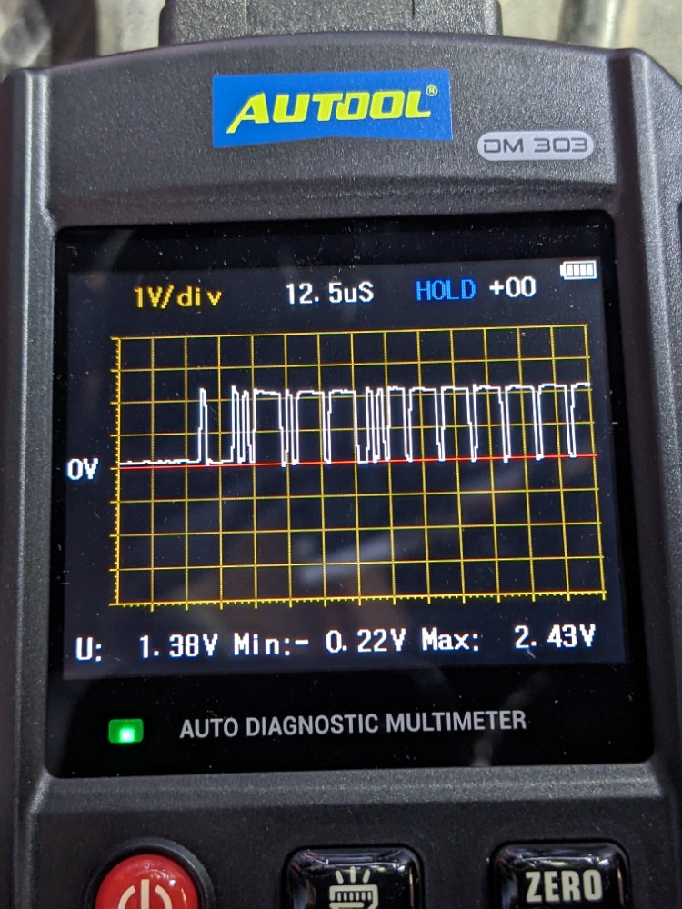

What does can low look like. It should be biased around 2.5V and signals should drop down to 1.5V.
You need to stare at these to find any abnormalities.

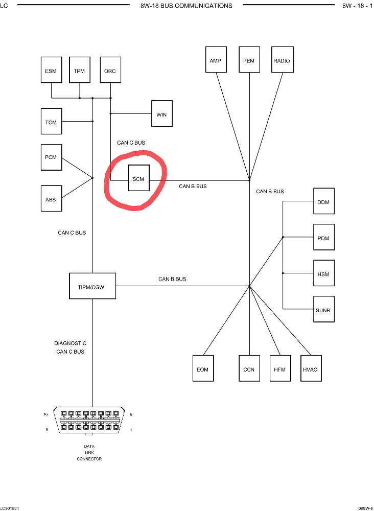

Can the steering Control module talk to CAN C ? Or rather, is it throwing a lost com to pcm?
It's on CAN-C and CAN-B.

1 year 8 months ago #83733 by Monde
I am curious to see what will happen if you start bypassing all the modules on the CAN C. Starting from the DLC to pins 5 and 6 (where the CAN lines exit the TIPM) to the IN and OUT of all the other modules. If there is a bad wire or module, you should regain communication.

1 year 8 months ago #83738 by ChallengerDude
Here's what can low at the pcm looks like.

1 year 8 months ago - 1 year 8 months ago #83741 by Monde
By bypassing, I mean to isolate each module. The tipm has 2 can c lines going into it and 2 coming out of it. You remove the tipm and find 2 wires , then use the 2 wires to complete the can c lines. Do the same thing to the other modules and see if you get the communication back
The way that Bernie was showing in the video
