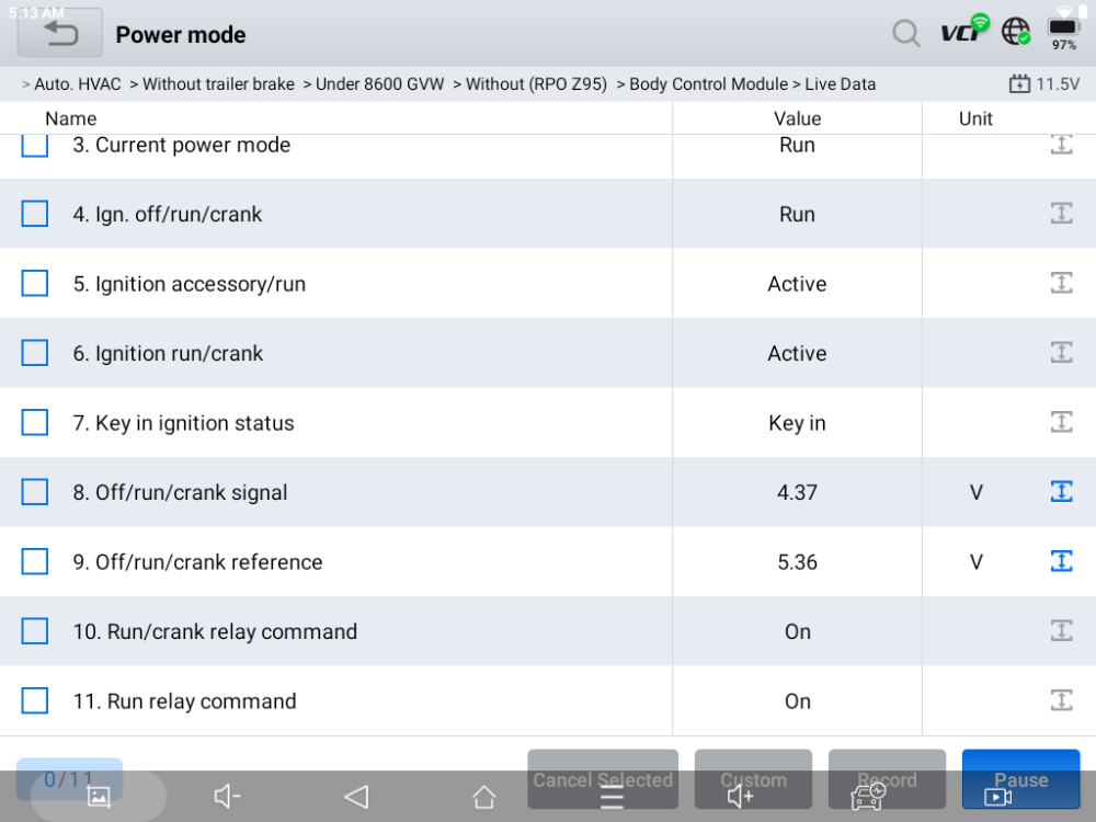

Started doing some tracing and all the sensors I tested had a 5v ref but found the scan tool showed that ignition voltages were different,
Found that the 5v ref via circuit 530 from BCM to ignition had a good 5v reference with the switch off and system awake and when the switch is in the first click/acc of the switch.
When in the run position it drops to 4v, while cranking goes up a little and with engine running 4v which is in line with the difference I am seeing on the scan tool.
Start probing the actual ignition switch and find the same results, replace it with same results. (killed my scan tool cause I acidentaly shorted across the switch, blew the DLIS fuse and kill the tool connected via OBDII DLC)
Using the Autel AL539b and another cheap oscope found the PWM signal is not 120hz but more like 96hz
The signal seems to respond the same when tested at BCM, Batt Current Sensor and at altenator

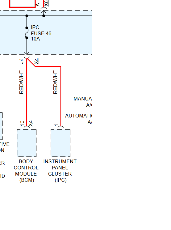

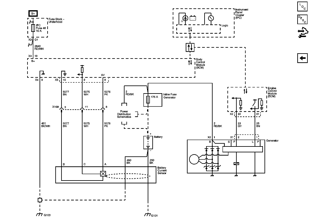

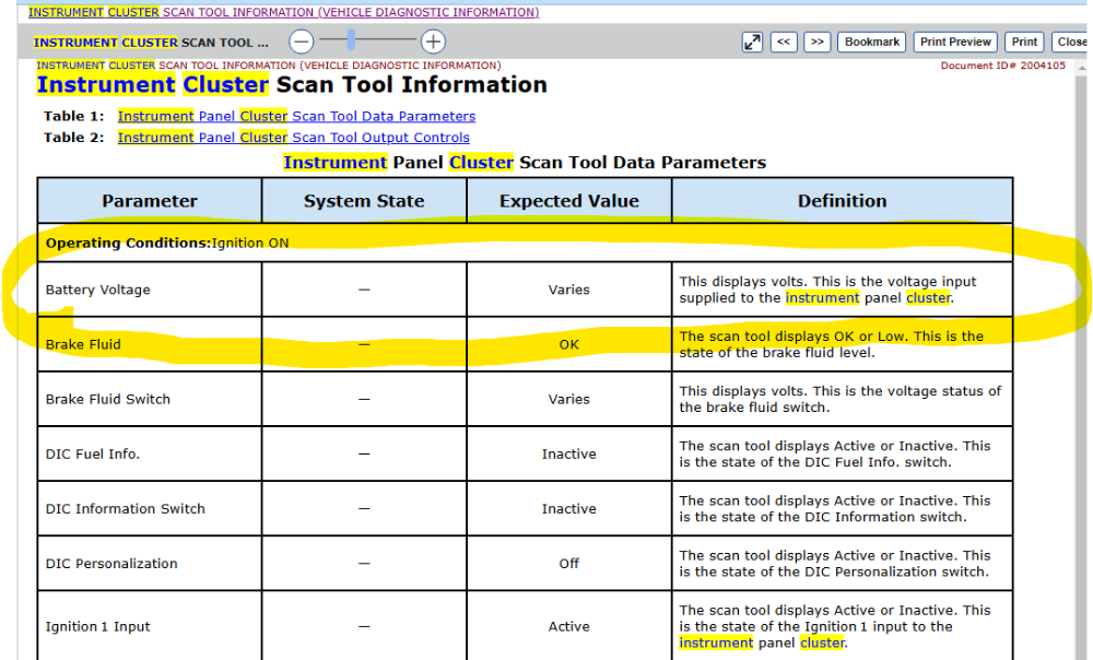

Battery Voltage Gauge OperationThe IPC displays the system voltage as received from the BCM over the GMLAN serial data circuit. If there is no communication with the BCM then the gauge will indicate minimum.This vehicle is equipped with a regulated voltage control (RVC) system. This will cause the voltmeter to fluctuate between 12 and 14 volts, as opposed to non-regulated systems which usually maintain a more consistent reading of 14 volts. This fluctuation with the RVC system is normal system operation and NO repairs should be attempted.
This IPC fuse 46 is interesting. If you have 15+ volts at the battery you should have this same voltage at that fuse. See attachments at bottom.

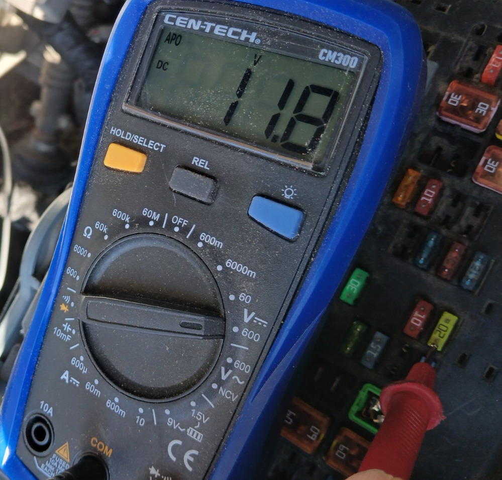

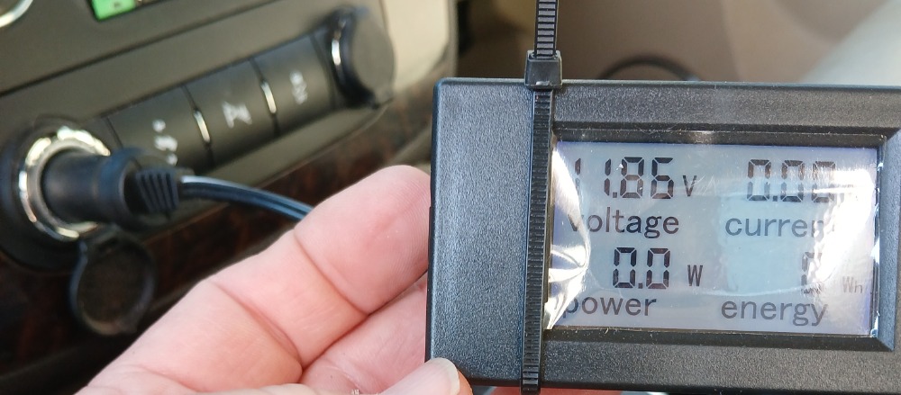

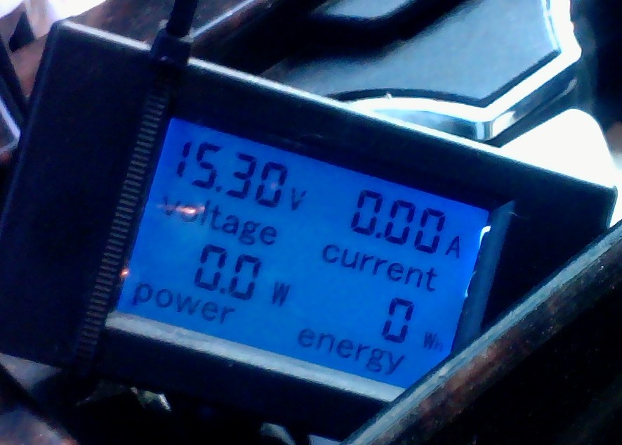

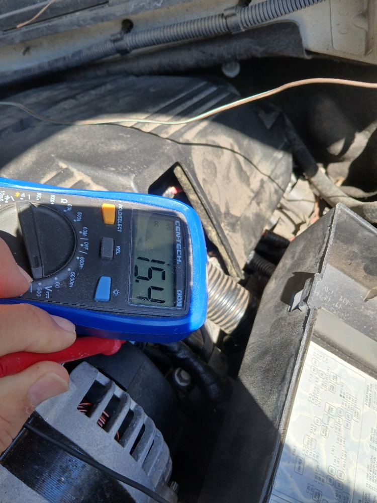

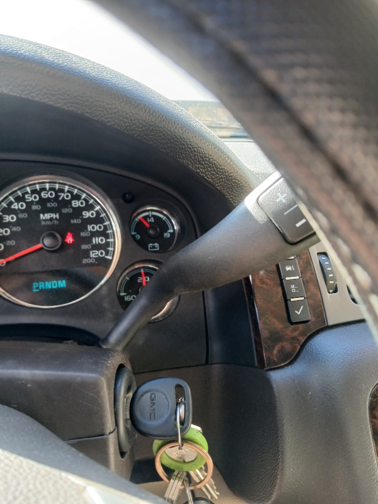

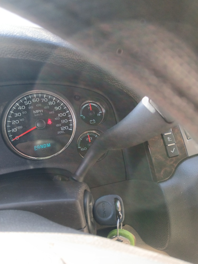

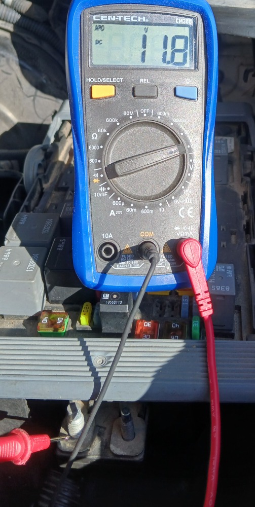

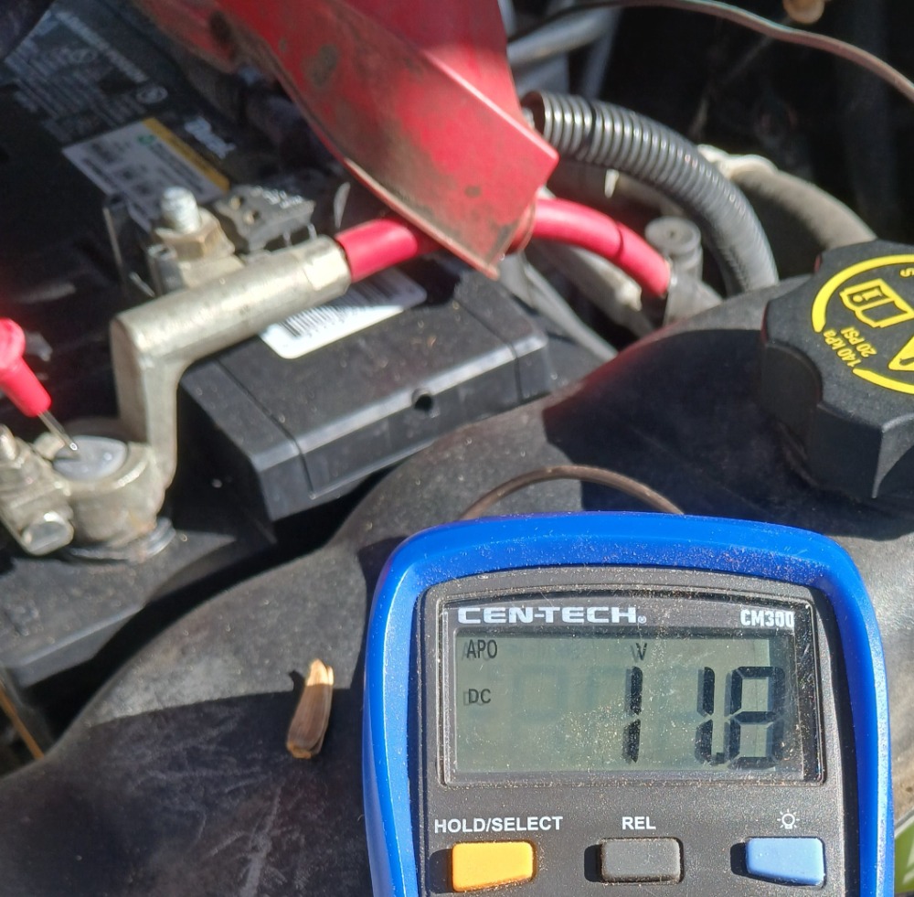

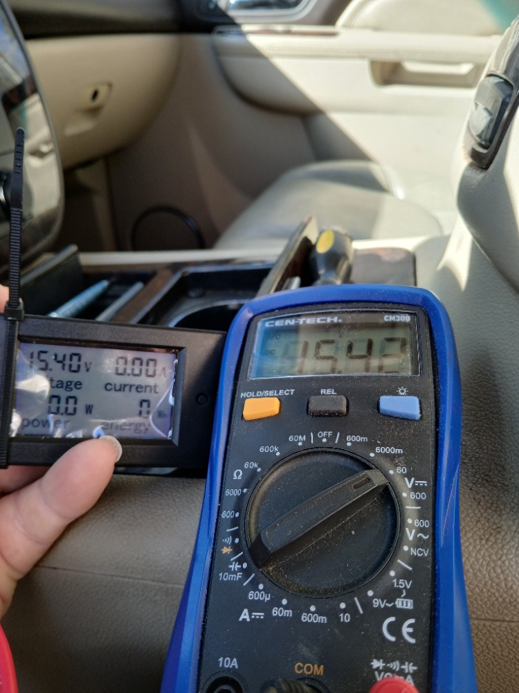

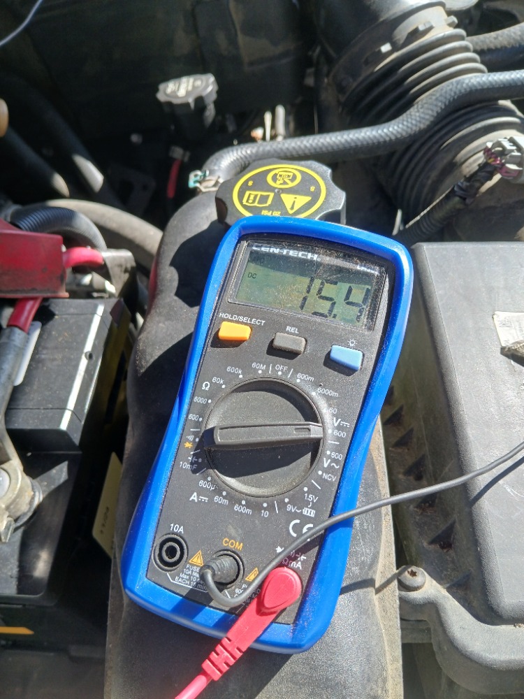

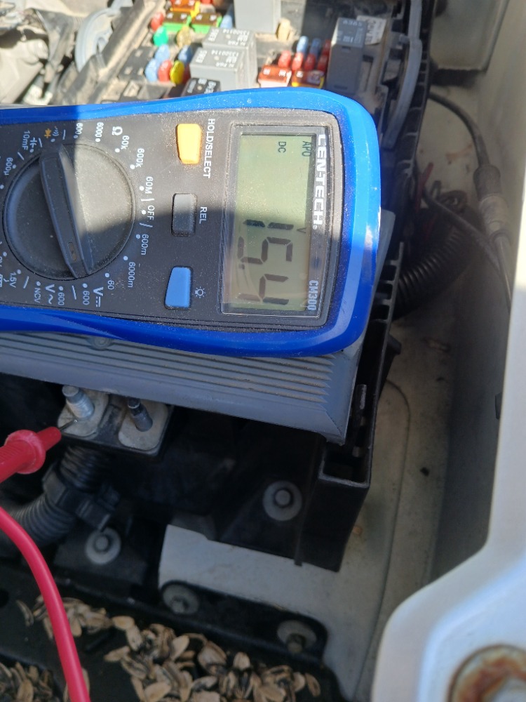

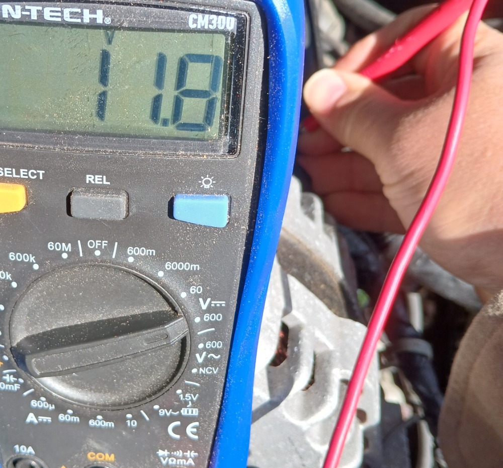

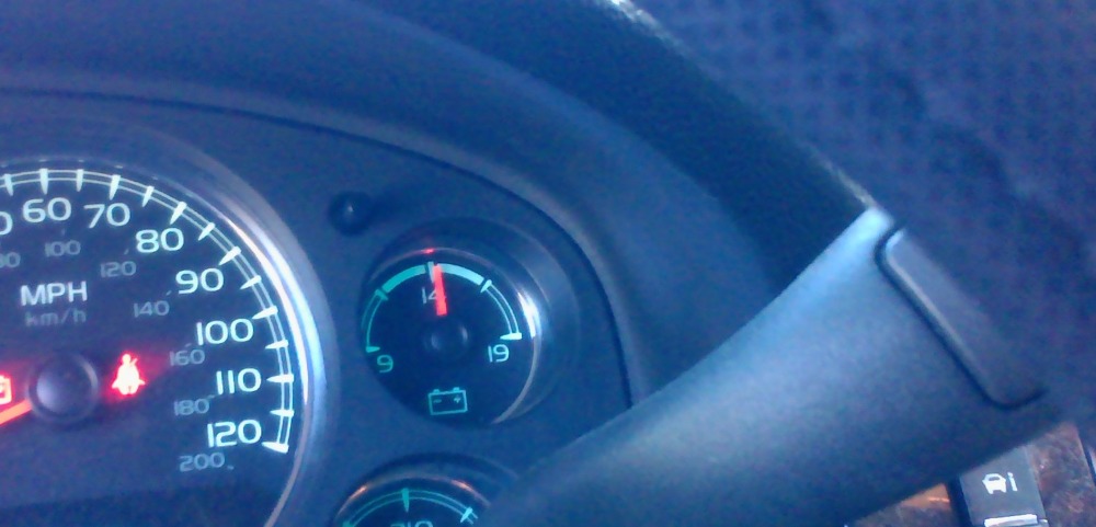

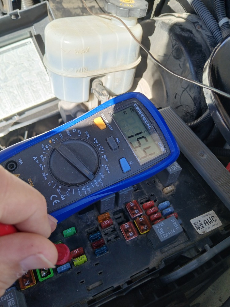

1 year 7 months ago - 1 year 7 months ago #84425 by jd64
Hope all is well!

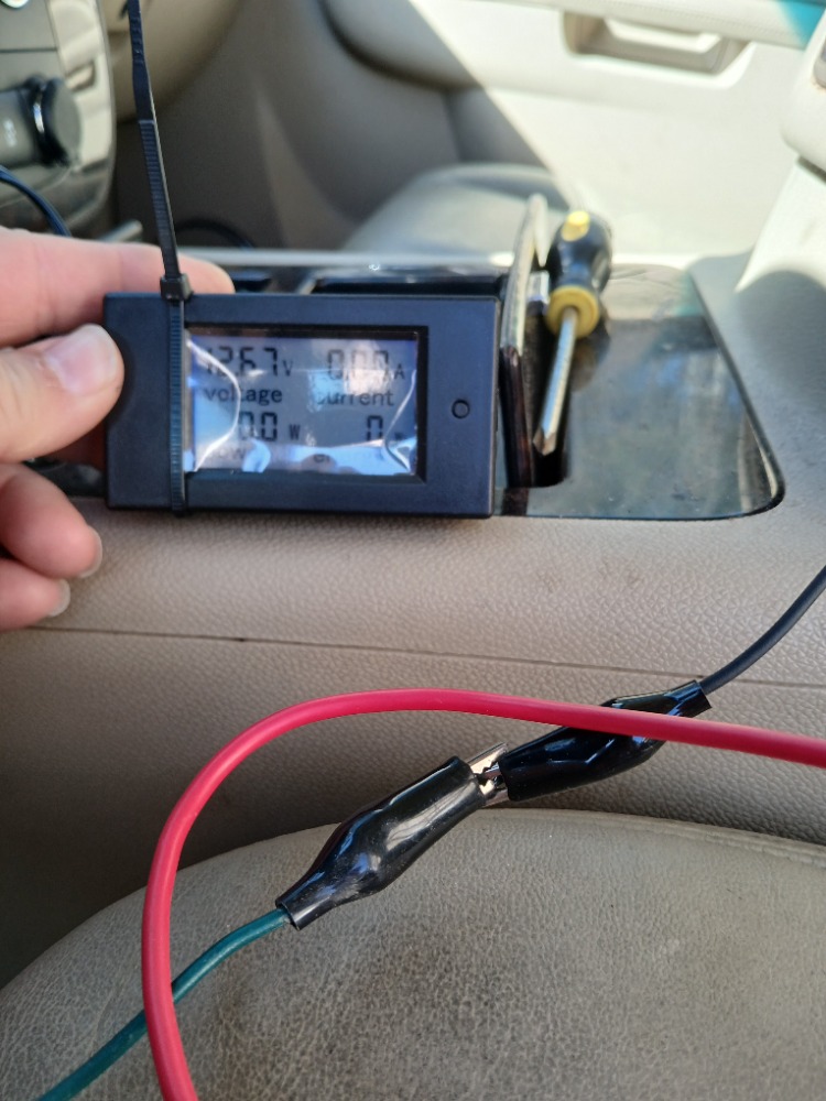

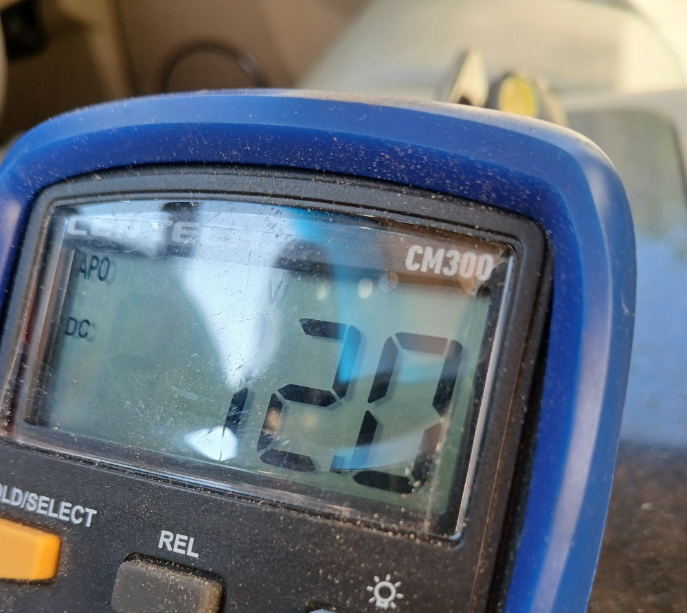

Finally had a minute to test the following, Each was tested using a homemade extension/lead from the ground. This is to limit the fluctuation by not touching the metal right at each location. These were all done with the vehicle having sit for about 2 weeks without anything being touched.
The system had just got woken by me opening the door and can see by the end of the test it was going back into sleep by the voltage increase.
1st picture is + to - across the battery using the extension for ground.
2nd is to batt volt on alternator
3rd is fusebox hot leg
4th IPC 46 Fuse
5th is the homemade voltmeter in the cigarette lighter
6th is measurement of the back side of the voltmeter just to keep everything in perspective (also system is a sleep and battery is recovering)
Last edit: 1 year 7 months ago by jd64.
1 year 7 months ago #84426 by jd64
Running  + to - across the battery using the extension for ground.
Running batt volt on alternator
Running fusebox hot leg
Running Fuse 46 IPC
Running homemade voltmeter in the cigarette lighter
Running  Dash
Acces Dash
Acc homemade vmeter
1 year 7 months ago #84438 by ferris48
Replied by ferris48 on topic 2013 Yukon Denali XL 1500 6.2 overcharging
Before going knee deep into this i think the easiest thing to check is to see what the BCM and cluster "thinks" the system voltage is at.
The following user(s) said Thank You: jd64

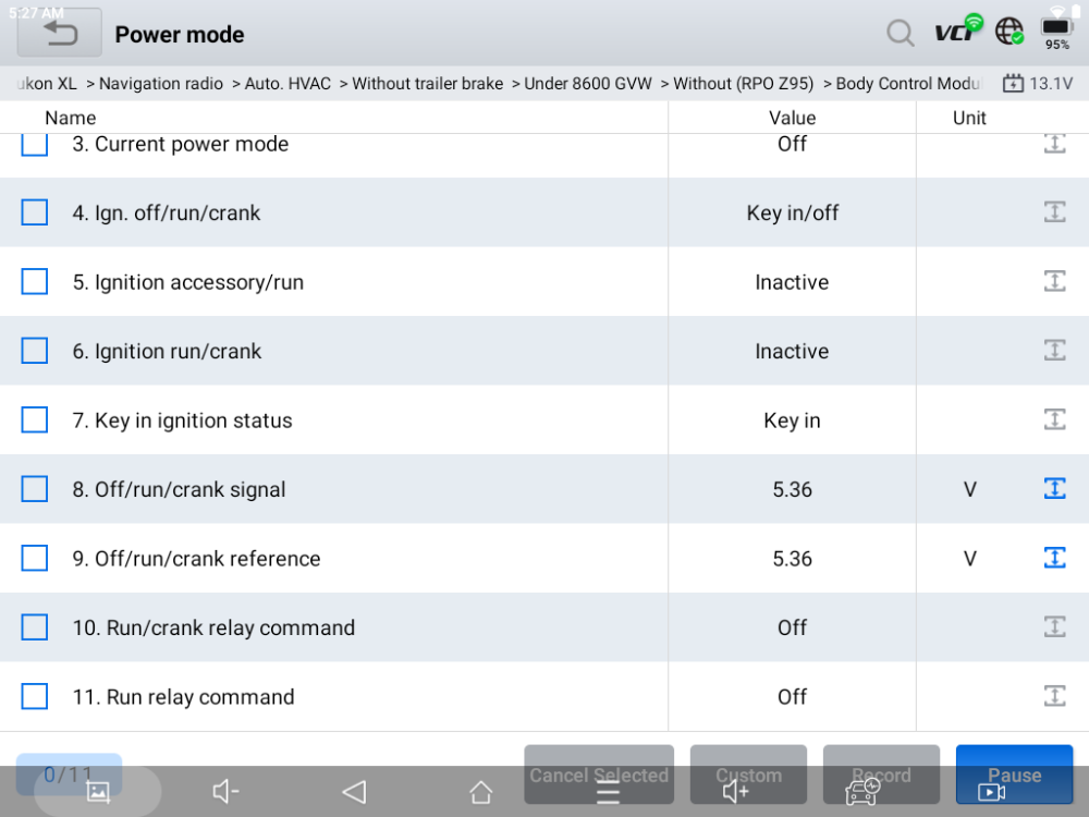

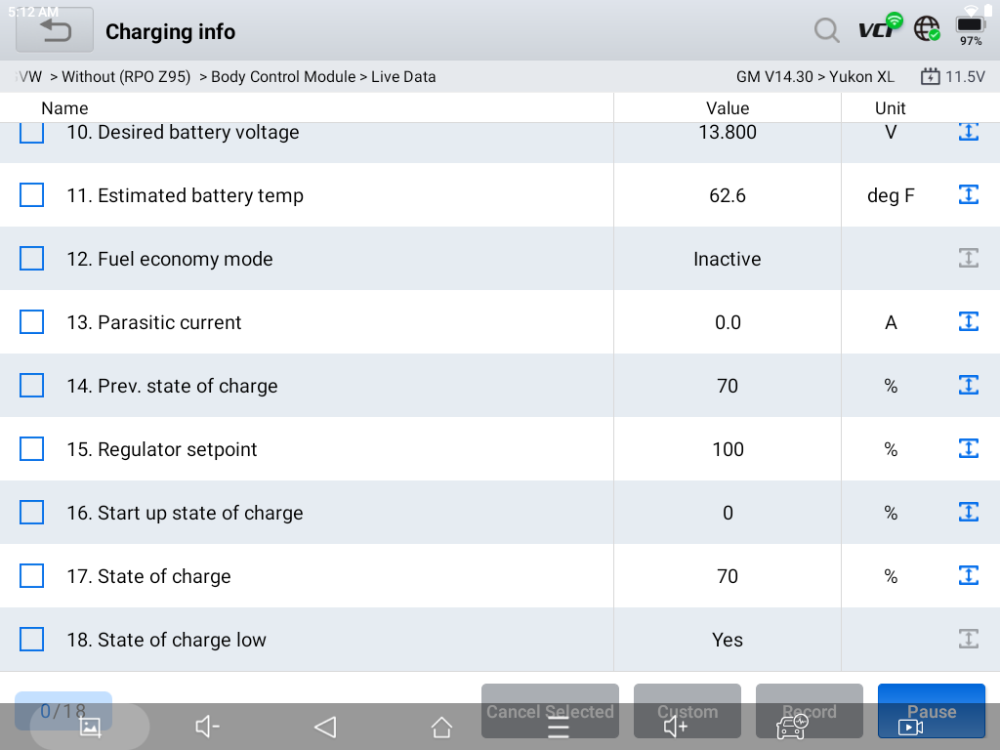

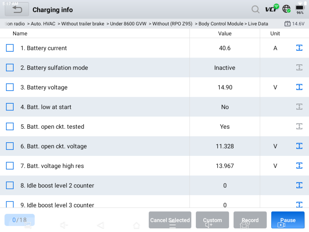

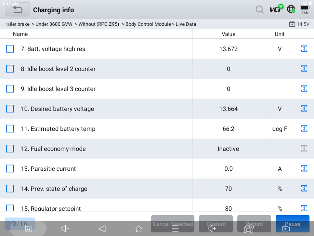

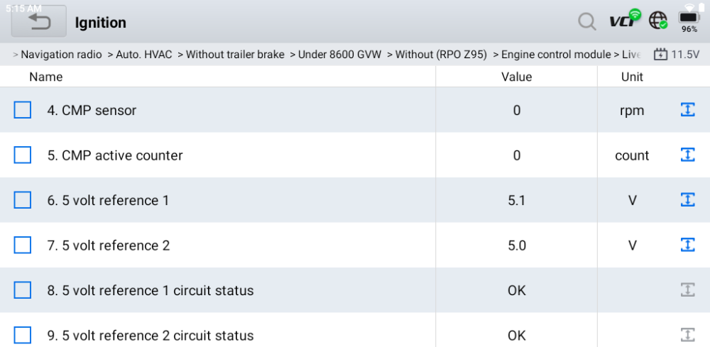

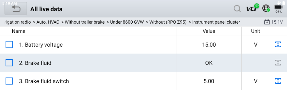

1 year 7 months ago - 1 year 7 months ago #85148 by jd64
Have another round of pics to explain and hopefully answer the questions.
Using Xtool D8 for the below pictures.
Have captured several images but only posting the ones I think stand out or to answer about questions comments to prevent pic overload.
1 year 7 months ago #86683 by jd64
Hoping to get your thoughts on the data provided
1 year 6 months ago #86919 by Noah
Have you seen anywhere a "desired voltage" PID?
1 year 6 months ago #86968 by jd64
I have
1 year 6 months ago #88795 by jd64
Still battling this issue
1 year 6 months ago #88815 by Noah
I do see GM vehicles charging around 15v without issue.
I think Tyler just had a run of bad aftermarket alternators charging over 15v and had to through quite a few to get one that charged at a lower rate.
Are there any codes or symptoms you are after, or are you just not happy with high charging voltage?

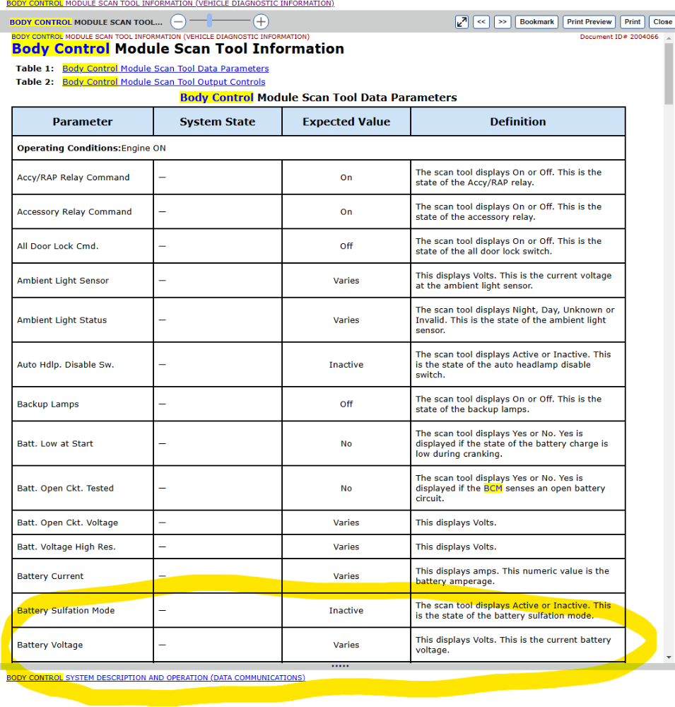

1 year 6 months ago #88840 by Tyler
Replied by Tyler on topic 2013 Yukon Denali XL 1500 6.2 overcharging
When I see GM's with the charging system voltage above 15V, it's usually in response to a weak battery. There's other things that can it, too, but that's the most common one, in my experience.
From GM theory and operation:
Charge Mode
The BCM will enter Charge Mode when ever one of the following conditions are met.
  • The wipers are ON for more than 3 seconds.
  • GMLAN (Climate Control Voltage Boost Mode Request) is true, as sensed by the HVAC control head. High speed cooling fan, rear defogger and HVAC high speed blower operation can cause the BCM to enter the Charge Mode.
  • The estimated battery temperature is less than 0°C (32°F).
  • Battery State of Charge is less than 80 percent.
  • Vehicle speed is greater than 145 km/h (90 mph)
  • Current sensor fault exists.
  • System voltage was determined to be below 12.56 V
When any one of these conditions is met, the system will set targeted generator output voltage to a charging voltage between 13.9–15.5 V, depending on the battery state of charge and estimated battery temperature.
I did see in a couple of your captures that the State of Charge was at 70%. The BCM wants it at 80% or higher. Also saw the open circuit voltage was 11.3V at one point.
Has the battery been replaced with new? If so, which brand/model?

The battery has been replaced twice and need to get the last brand/model for the response. (updated) Duralast H6-DLG Din H6 En ln3 BCI 48 730 CCAmps
I am tracking the triggers for the charge modes. No AC, idling, lights to include daytime and interior off, no radio, wipers or defrost either.
(Correction I found it) I did not see the 11.3 screenshot but did see 11.5. This was when I 1st started looking at the truck and it had been sitting and then opened the door so the system woke.
