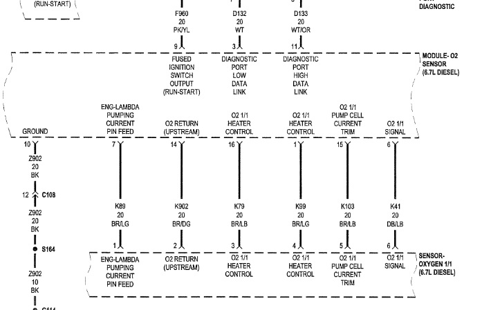

This is a recent purchase that came with the MIL lit up. The only engine code is a U011A which states there is no communication from the ecu to the O2 module located on the Passenger side chassis rail.
Actions I've taken: Checked for power (Pink/Yellow - Ignition run start pin 9) and ground (Black wire- pin ten) at the connector at the module. Both showed to be good. I then back probed the wire that goes to the ecm (white and orange wire -pin 11-high data link). The following video shows the results. To my untrained eye it looks like the signal cuts out so i check ground and my t pin and both were good.

I went and grabbed a diagram for reference, thought I'd share:
Thanks for the video! I dunno what all that noise is, but I can see why the PCM is pissed off about it. The diagram doesn't say this is a CAN network, but I can't imagine what else they'd use in this application. You'd expect the voltage on the high side of the network to be from 2.5V to 3.5V, but that's nowhere close. Does the low side look similar?
Also, I see that you've got your scope set on a 100us time base, which is pretty darn fast :ohmy: You might get a better idea of what's going on if you zoom out a bit, maybe 5 or 10ms? I find that's usually fast enough to see detail on network signals.
I'd be very curious to check the resistance across both network terminals, unplugged, at the sensor module connector. The reading you get will tell us if it truly is a CAN network, and if the wiring is good or not. With the sensor module unplugged, I'm hoping for a reading of 120 ohms - that would mean good wiring, and the correct resistance of the terminating resistor in the PCM.

The 60 ohm measurement makes me think there isn't a wiring problem, as this is exactly the resistance a CAN network should have at rest with both terminating resistors intact. To me, if we can prove wiring integrity and that the PCM is OK, then I think you're safe to sell a sensing module.
Just FYI, this sensing module talks to the PCM on it's own exclusive, dedicated network. Sure, there's other CAN networks on the vehicle (for the ABS, instrument cluster and such), but none of those are involved in this circuit. Mostly, I'm trying to establish if this sensing module network plays by the usual CAN network rules. That's what the resistance measurement was for ;)

Sweet! B) That's a perfect reading with all modules plugged in, and also positively ID's this as a CAN network. I feel pretty confident that there isn't a wiring issue at this point.
The 120 ohm reading I quoted would be if you had either the sensing module or PCM disconnected.
You could check the sensor wires, but I don't think that would account for the waveform you saw on your scope, or the network code. No service info here at home, but I believe this system would set a different code if it was just a sensor not performing correctly. I'll check on this tomorrow.
No worries about the next vid, though I'm happy to check it out when you can upload it. Really, I'd like to see the voltage on the high side above 2.5V with the sensing module disconnected, as it should never go as low as you were seeing.

Also, how many wires total are there at this module? The BBB Industries diagram I posted earlier showed 10, with one sensor connected. But the Mitchell diagram I found showed 16 wires, with two sensors connected.
IF the diagram I posted earlier corresponds to your truck, then I'm looking for voltage readings on pins 1, 6, 7, 14, 15, and 16. I'm gonna take a shot in the dark and say:
Pin 1 + 16: Pulsed power and steady ground
Pin 14: 2.5V steady
Pin 7: 3V steady
Pin 6: 2.5V, varying
Pin 15: same as pin 6
Could be WAY off :lol:

Tyler the vehicle follows the on demand wiring diagram and is 16 wires I will try to follow through with what you want as far as I can with my limited abilities.

61 ohms sounds correct. The ECM has a termination resistor and the variable geometry turbo actuator has the second.
If you have clean data square waves at the module it's probably a failed NOx sensor.
Prior to replacing it check for TSB's, If you have the Engine Serial Number I can try and check QuickServe for anything on cummins side.

The following are all my readings based on the on demand diagram. A vantage Pro was used on a 20 volt scale 5 ms time base. There are 16 pins all together.
Pin 1: 12.31 volts
Pin 2: 12.31 volts
Pin 3: 2.95 volts
Pin 4: 2.94 volts
Pin 5: 2.86 volts
Pin 6: 2.94 volts
Pin 7: 2.84 volts
Pin 8: 12.35 volts
Pin 9: 12.35 volts
Pin 10: .69 volts
Pin 11: .68 volts
Pin 12: .68 volts
Pin 13: 2.52 volts
Pin 14: 2.52 volts
Pin 15: 2.86 volts
Pin 16: 12.30 volts
I don't have clean data square waves based on either pin 3 (white) the low data link or pin 11(white and orange) high data link.
