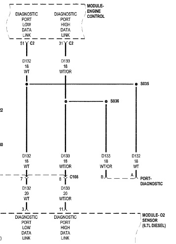

ephotrod wrote: The following are all my readings based on the on demand diagram. A vantage Pro was used on a 20 volt scale 5 ms time base. There are 16 pins all together.
Pin 1: 12.31 volts
Pin 2: 12.31 volts
Pin 3: 2.95 volts
Pin 4: 2.94 volts
Pin 5: 2.86 volts
Pin 6: 2.94 volts
Pin 7: 2.84 volts
Pin 8: 12.35 volts
Pin 9: 12.35 volts
Pin 10: .69 volts
Pin 11: .68 volts
Pin 12: .68 volts
Pin 13: 2.52 volts
Pin 14: 2.52 volts
Pin 15: 2.86 volts
Pin 16: 12.30 volts
I don't have clean data square waves based on either pin 3 (white) the low data link or pin 11(white and orange) high data link.
Forgive me if I'm missing something, but there's not a good ground on any of those pins. I'd think at least one would be (much) lower than half a volt.
The diagram looks bad on my phone, gonna have to fire up the PC, but that's my initial impression.
9 years 10 months ago - 9 years 10 months ago #3167 by Tyler
Pin 1: 12.31 volts
Yay! :woohoo: Thanks a ton, sir! This is exactly what I was looking for.
Floating ground ;) Usually 2.5V, but some Fords use 3.6V (for whatever reason :unsure:). That's why pins 13 and 14 show 2.52V.
The predictions I made for those pin voltages were hit and miss. I had this pegged for a power-side switched heater, but I think it's actually ground-side switched. Oh well :(
61 ohms sounds correct. The ECM has a termination resistor and the variable geometry turbo actuator has the second.
It does? :huh: Looking at the diagram again, and it doesn't show the turbo involved:
Could be the diagram is wrong?

9 years 10 months ago #3169 by Noah
The module itself uses a floating ground? I thought that was a signal circuit strategy? :(
9 years 10 months ago #3170 by Tyler
Noah wrote: The module itself uses a floating ground? I thought that was a signal circuit strategy? :(
Sorry, I coulda been more specific there :blush: The sensor circuits use a floating ground. Actually, I see what you mean now... Pin 10 is the module ground, with .68V :blink: I didn't look too closely at that one, 'cause ephotrod said he checked module power and ground in the first post.
Maybe it's time to revisit the module ground? :huh:

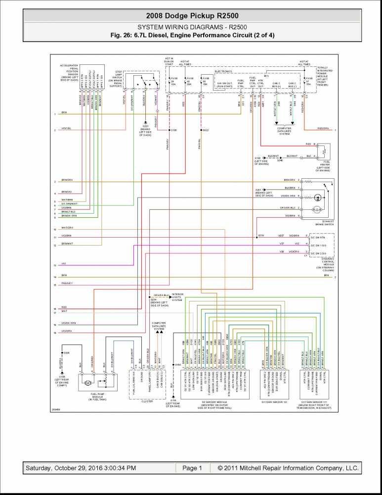

I'm going to agree that your ground voltage is to high. .69 is to much and being that the diagram says the ground at at the rear of the engine, I'm going to bet its corroded.
As far as Ohming out the data lines go... Most Cummins engines of the newer vintages uses 2, 120 ohm termination resistors. One is in the ECM, the other is usually in the VGT actuator of the turbocharger. This year may not have the electric turbo actuator on the turbo so this may not be applicable. When both are working and connected in the system, you'll see 60 ish Ohms on the circuit. If one is failing, you'll see it above the 60 ohms.Allow me to remind you that i work on class 8 trucks so Dodge may do it different. Looking at the diagram you put up, they are incomplete views of the ECM. I believe that mitchell has a diagram for the network wiring of most newer cars. I might be wrong but its worth a look.
Again, check your ground wiring, I'm betting that's where you'll find the problem. I'm kinda guessing if the second termination resistor is not in the turbo it might be in that O2 module.
Last thing, Do the squarewaves on the Data lines clear up when you unplug the O2 module? I ask because I had a ISX 15 Cummins that had a shorted VGT actuator crashing the CAN, I was plugged in to the CAN with my scope and when i unplugged the VGT the waveform came back and started looking normal again.
