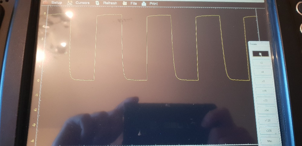

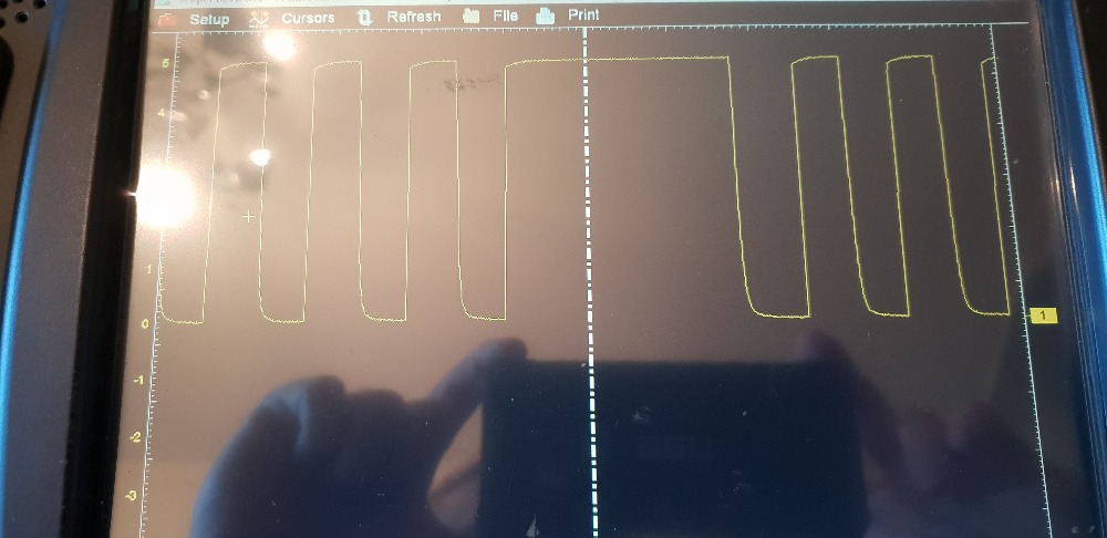

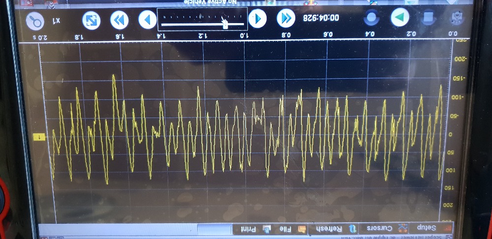

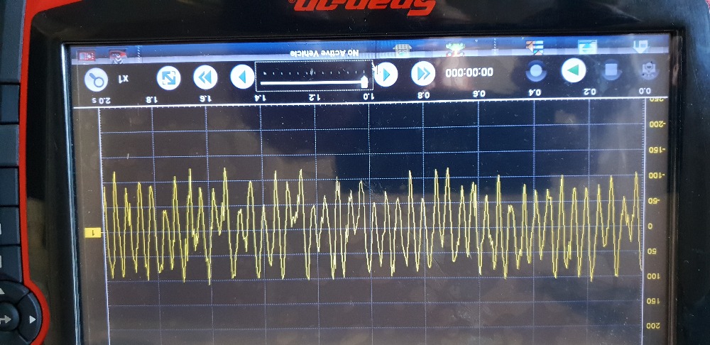

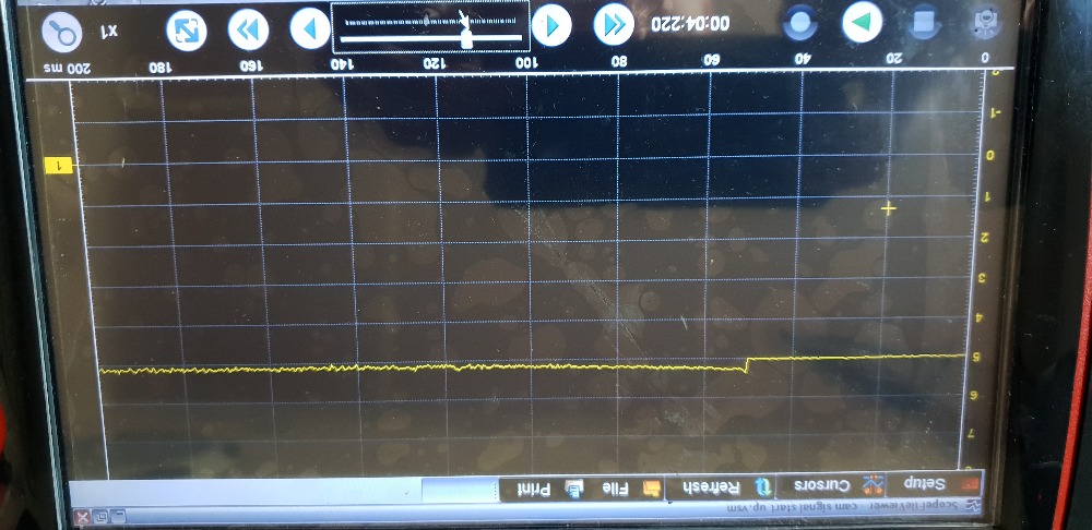

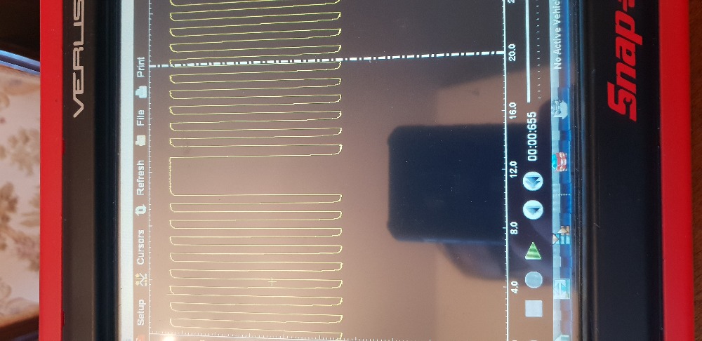

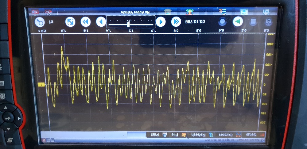

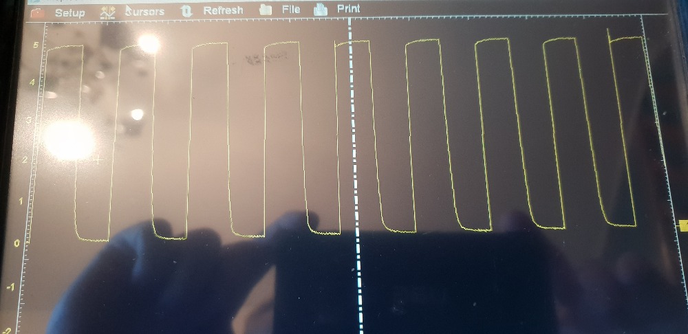

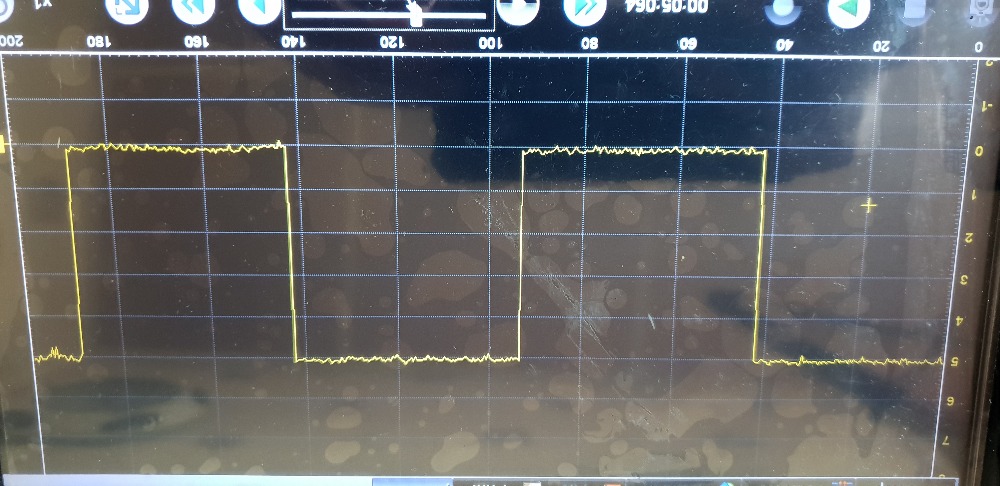

Hi im a bit confused with the waveform im seeing...
So upon putting my verus scope on the crank signal wire with the car running im getting a waveform that i cant work out, im getting a fault code for a cam sensor fault but when iv scoped the cam sensor everything is as it should be a nice square wave from 5v to 0v but when iv scoped the crank sensor its a 3 wire sensor and like i say the waveform is wierd. Iv attached some pics of the crank waveform.
7 years 11 months ago #23465 by Tyler
Replied by Tyler on topic Crank sensor waveform help
I dunno, that looks like a decent crank signal to me? :huh: Is this off your VW Fox? I won't be able to find a known good to compare to, since the US market never got the 1.2L engine. But at first glance, that appears to be a fairly typical Hall effect waveform with a sync notch.

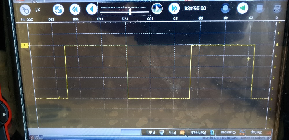

Replied by sam12301 on topic Crank sensor waveform help

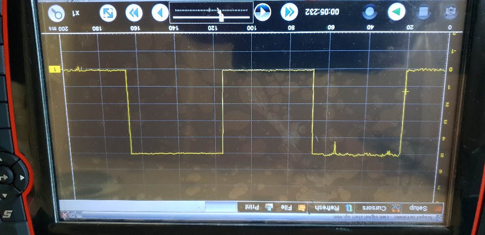

Yh its off the vw fox 1.2, its strange because its giving a cam sensor fault an intermittent one and iv scoped the cam sensor and the form is bang on with the its a nice square wave on and off from 5v to 0v and the ground is good and the power and i cant for the life of me get it to act up, iv tried scoping from a cold start when its not been started for a day, iv tried getting the car hot, iv tried turning it on and off loads of times.
  • sam12301
  • sam12301's Avatar Topic Author
7 years 11 months ago #23467 by sam12301

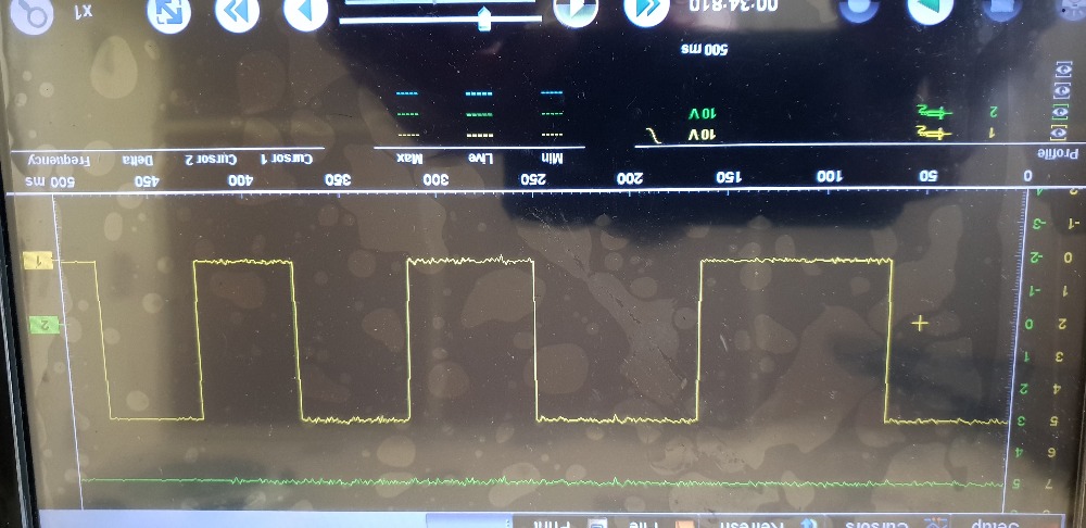

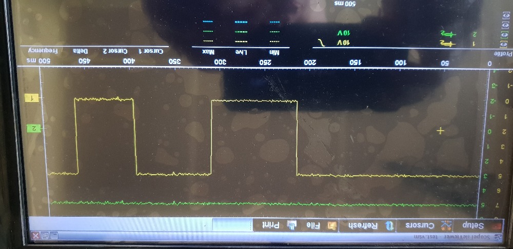

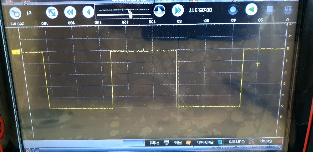

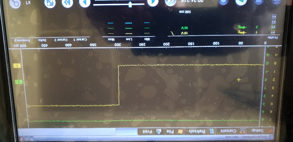

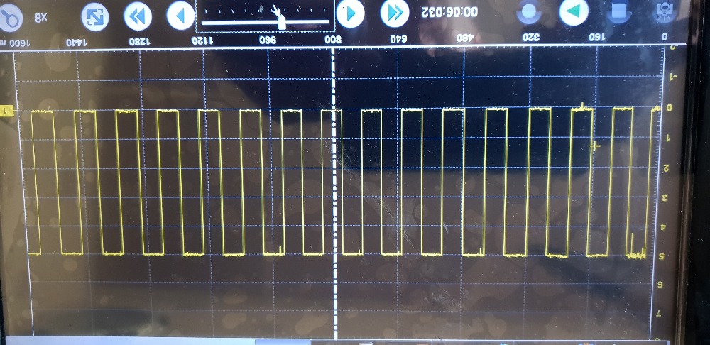

Although check out the cam waveform is this bad? Because when i have been on the freeze frame data for the cam fault the rpm shows 256rpm and iv just noticed now on the cam waveform as i started the car theres some noise in the wave form iv attached the pics for the first few frames as i started it, the yellow is the cam signal and the green is the cam power wire
  • sam12301
7 years 11 months ago #23468 by sam12301

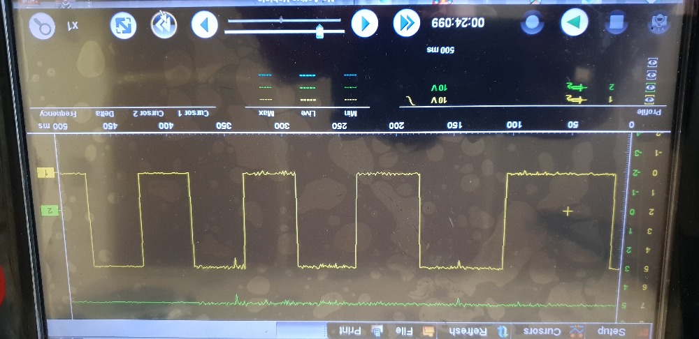

It does it on each startup iv just looked further back in the waveform where i did another startup and it also has noise
7 years 11 months ago #23476 by Paul P.
Replied by Paul P. on topic Crank sensor waveform help
Can you Post an AC Ripple pattern photo? Check any(all) other 5v feed outputs from the PCM and see if that noise is there. I'm thinking too much AC Ripple, Power and grounds to pcm, and pcm 5 v regulator.

Replied by graywave on topic Crank sensor waveform help
Cam signal looks good, the little bit of noise you see if perfectly fine.
Crank sensor waveform looks OK. I have seen crank sensor waveforms with a slight curve to them and cause no issues. Maybe the sensor is a little sluggish but I wouldn't tread that way just yet.. It is true that some vehicles will set a cam code for a crank sensor and visa-versa
Can you get set you scope to 100ms or 200ms and start recording to capture the cam signal during cranking and at idle. Stop the capture before the buffer starts to overlap. 100ms and 200ms should give you more than enough buffer to hit the stop button. This will tell us if the cam sensor is not picking up the tone ring during cranking. You can then zoom the waveform out to see repetition but you are able to zoom in for detail as well.
Does the code set every single time during cranking?

As others have stated, both sensor waveforms look completely normal .The noise while cranking is probably caused by the high starter current, nothing to worry about.

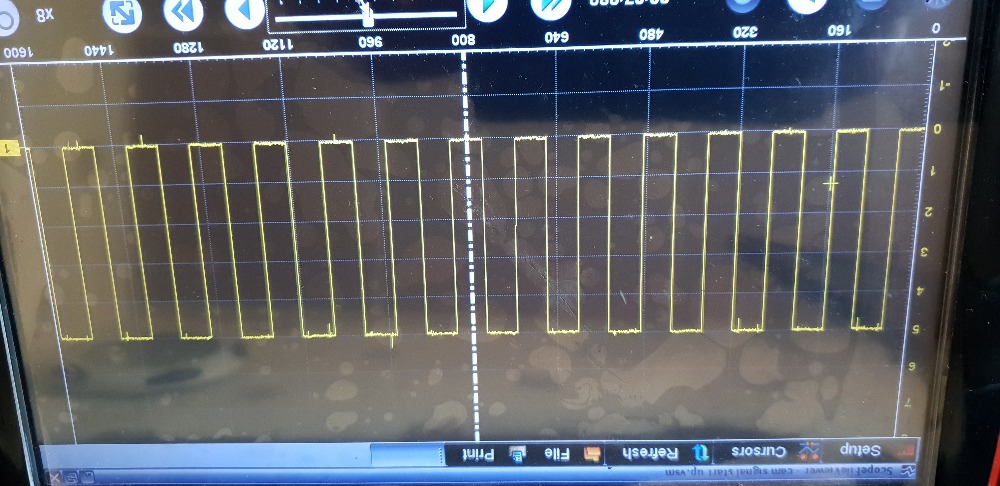

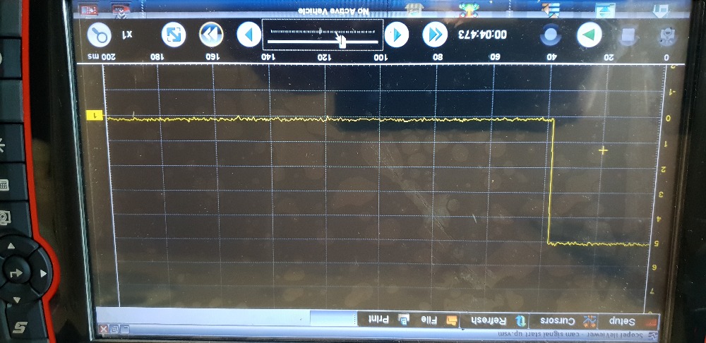

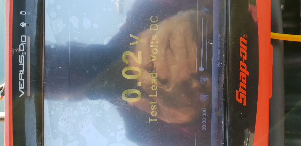

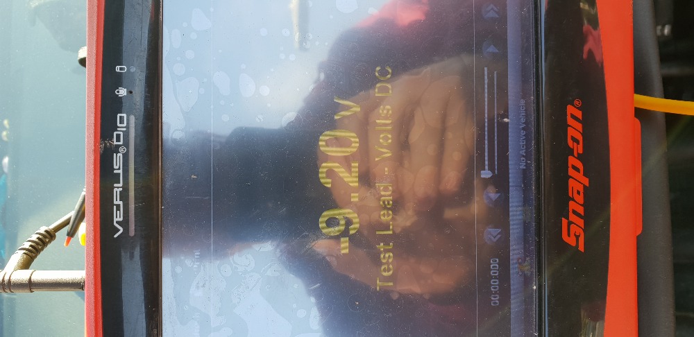

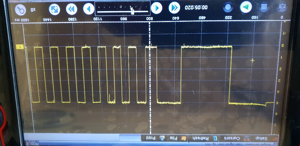

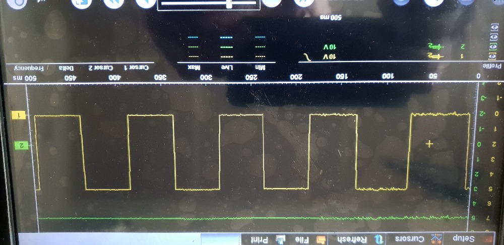

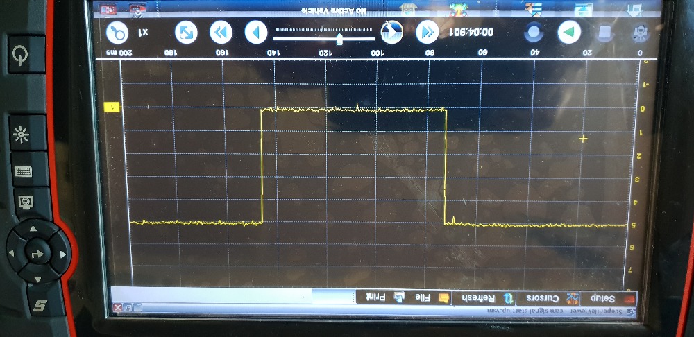

Right so iv done a voltage drop test with KOER on the cam power and the cam gnd and iv attached some pics of each of them and also iv done an ac ripple test on the batt gnd to batt + because the alternator post was difficult to get on without pulling things apart and iv attached pics of that, and my other test iv done was the cam signal with the scope set to 100ms and then cranked the car and let it idle so iv also attached them pics.......
So the 0.02v was the voltage drop from sensor gnd to batt gnd
The 9.2v was the voltage drop from sensor power to batt +
  • sam12301
7 years 11 months ago #23565 by sam12301

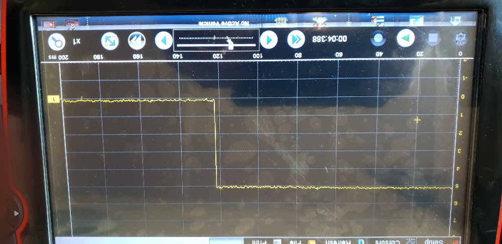

More cam signal pics iv showed the zoomed out pics aswell and as you can see the square waves are not perfect squares theres like little tiny spikes all the way along

7 years 11 months ago #23655 by Paul P.
Replied by Paul P. on topic Re:Crank sensor waveform help
The ground drop looks good. However the 9.2 volts is interesting....
Firstly, to drop test the power feed, it would be from the sensor connector backprobed, to the PCM backprobed. Circuit Loaded.
Lets make an assumption... assuming your KOEO system voltage is 12.6 volts.
12.6-9.2=3.4 V : IF, your PWR Feed was 12V this is way too much drop.(This drop also includes a lot of circuitry)
However, if the feed is 5V PWR, 12.6-9.2-5=-1.6 or 1.6 volts of drop which is still way too much.
Your original photos showed 2 small spikes about maybe 1/2 a volt. Those spikes should not be there.
Never stop Learning.

7 years 11 months ago - 7 years 11 months ago #23659 by Paul P.
IMO, it can be two things, signal wire could be picking up voltage from somewhere else, OR the sensor itself can cause that small spike.
But before you condemn the PCM, scope and volt drop all sensors on the 5v regulator excluding thermistors, Vdrop PWR and GND to the PCM.
Sorry, but I just read your reply about the other problems
Unfortunately you've got lots of checks to do.
That one Cam pic with the spike really bugs me, when the signal is high, something is trying to pull it down to ground by that 1/2 volt.
