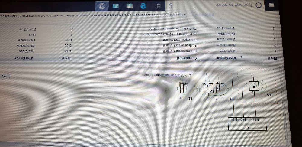

So my best plan of action is to voltage drop all other 5v sensors and also voltage drop the pcm power and grounds?
- sam12301
- Posts: 31
7 years 11 months ago #23662
by sam12301
Replied by sam12301 on topic Re:Crank sensor waveform help

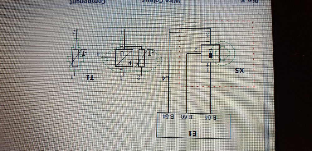

The cam sensor ground also shares with the MAP/air temp sensor and also shares with the coolant temp sensor, iv attached a pic of the diagram, the cam sensor is the one with the red box around

Replied by Paul P. on topic Re:Crank sensor waveform help
We need to know circuit design here. Your cam sensor photo had the spikes I didn't like on both green CAM PWR trace and Yellow signal trace and they are in sync with each other!, Judging by the scales the voltages are being pulled down during this spike event.
So, with KOEO is the cam signal high or Low with the sensor disconnected?
If its High, its pull-down design, then you will want to make sure nothing else but the sensor is pulling the signal to GND
If its Low, its pull-up design, and you will want to make sure no other voltage source is contacting the signal wire. (such as the reference voltage in the same harness) or any other for that matter.
That spike event tells me something has tried to pull voltage down. To pull voltage down you need an intermittant GND in your case.
My next step would be to determine circuit design and perform by-pass test with the scope, where you are being the sensor. IF you can re create that small spike, youve got a wiring issue, my guess would be Grounds.
If you can recreate a nice clean signal, replace the sensor.
Since were on the topic of possible grounds, unplug the cam sensor, unplug the cam signal at the PCM and ref voltage at pcm, Attach your test light to B+ and check the signal and pwr FEED. The test lamp should NOT light up here. IF it does you got some wiring to repair.
Vice versa attach to BAT GNR, rechech those wires for a presence of voltage while all unplugged/ The lamp should not light. if it does you've got voltage that should not be there.
Feel very free to wiggle the wires vigorously as possible while using the test lamp.

The circuit is a pull down so with KOEO and the cam sensor disconnected the sensor is at 5v.
Ill use my test light with the signal wire scoped and touch on and off and see ifi can create some nice smooth square waves like you said.
After doing that if i manage to create them nice square waves ill replace the sensor with a VW OEM cam sensor because the current cam sensor is an aftermarket one.
If i dont manage to get the nice square waves ill proceed to do the other test by disconnecting the sensor and also disconnecting it at the PCM and do the test light test for wiring integrity.
