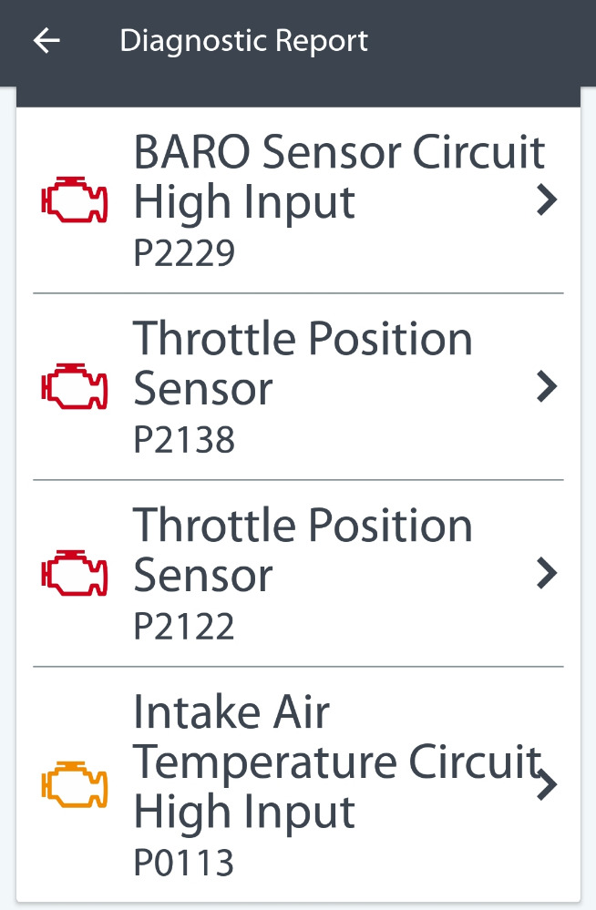

I can't seem to be able to upload the images. Here's the list of codes:
P2229--BARO Sensor Circuit High Input
P2138--Throttle Position Sensor
P2122-- Throttle Position Sensor
P0113-- Intake Air Temperature Circuit High Input

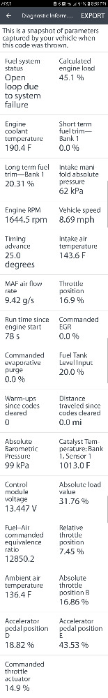

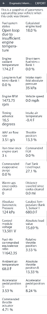

7 years 11 months ago #23637 by danield
Ok, cleaned all body connected grounds, went and cleaned all the sensors and harnesses again, cleaned the throttle body as well just in case. Nothing... Cleared codes and the P2138 was the only one that came back. Here's the data from that code. I'm so grateful for your time, I'm in Puerto Rico and I find it hard to find data analysis in my area. THANK YOU!!
  • danield
  • danield's Avatar Topic Author
7 years 11 months ago #23638 by danield
  • danield
7 years 11 months ago #23639 by danield
BTW, I'm almost sure that data came during the test run as soon as I floored the pedal and the fault code activated. This wasn't at idle with the car parked.

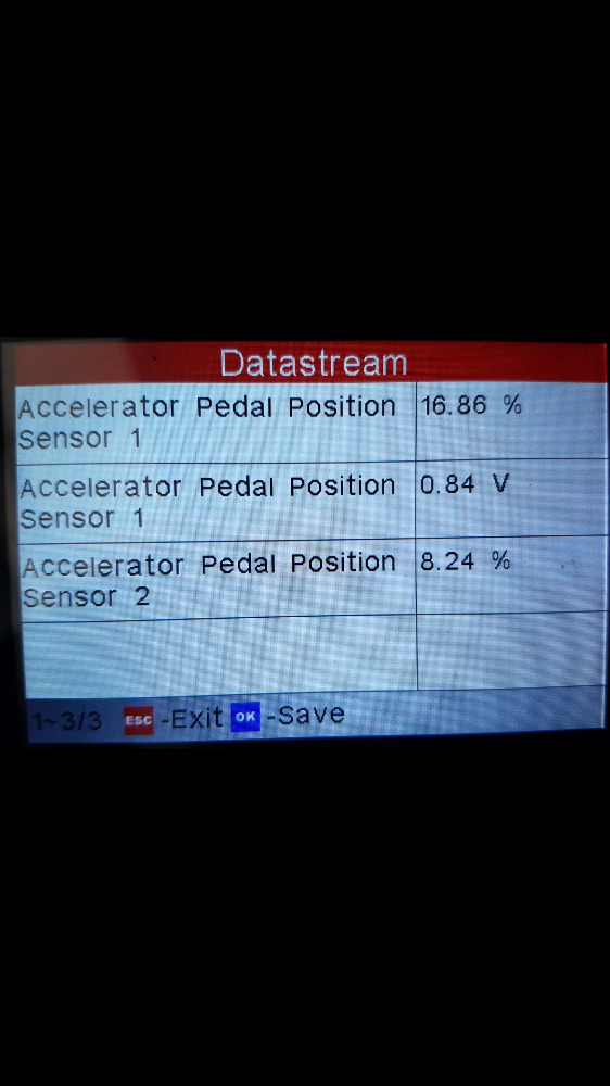

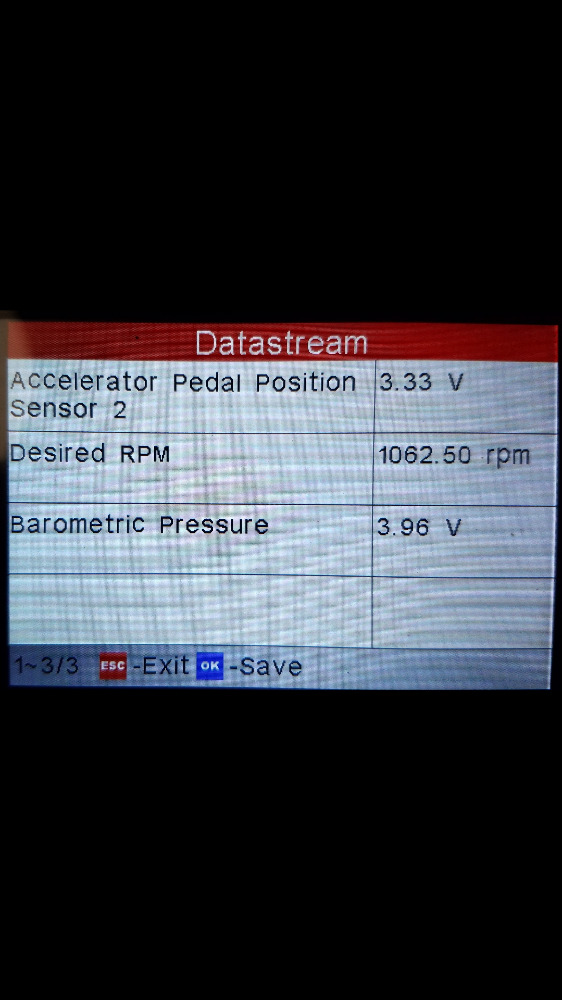

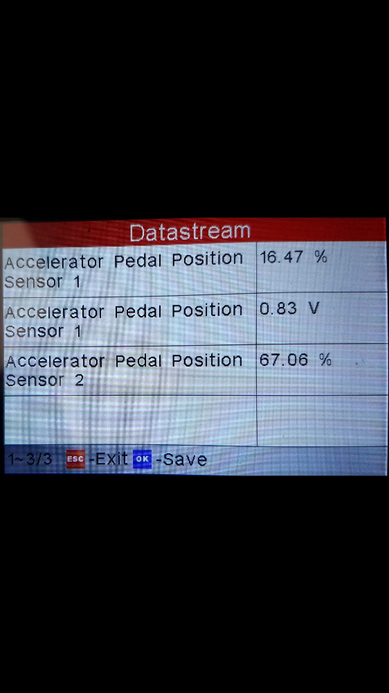

7 years 11 months ago #23642 by danield
Hello Ben, thanks for the input, here's what I have.
  • danield
7 years 11 months ago #23643 by danield
This live read is with Key on-Car off pedal at top. This next read is with the pedal all the way down.

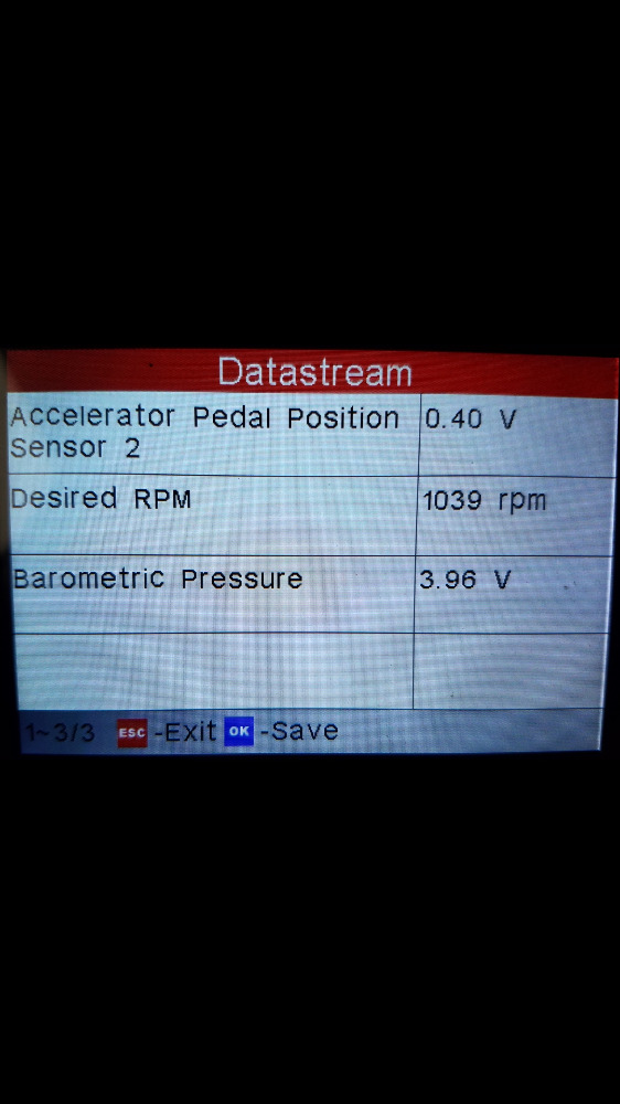

  • danield
7 years 11 months ago #23644 by danield
This capture is with the car on and pedal all the way down.

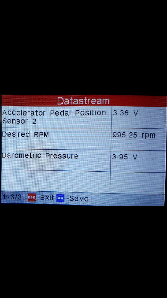

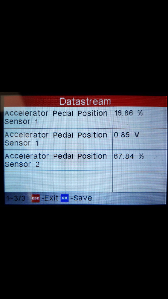

7 years 11 months ago #23651 by Tyler
If that data is accurate, then it appears that both potentiometers in the APP sensor are barely moving. :unsure:
Try observing your scan data again, but while slowly sweeping the pedal all the way down and all the way up. There should be SOME kind of change.

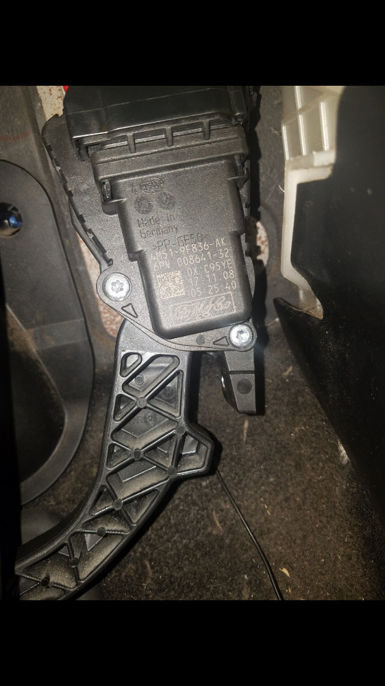

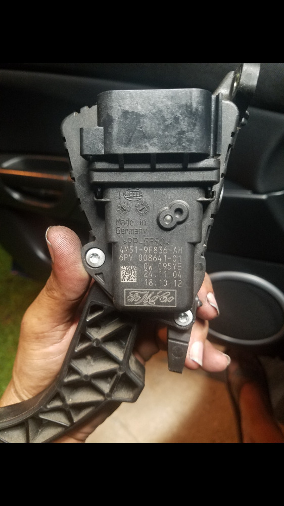

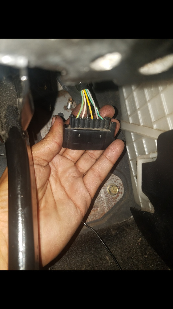

Hi there Ben. Yes, I did the test at the APP. I actually went further, I found another pedal from a 2011 and measured that one as well, there's no difference in pedals that I can see but maybe its different. I'll post pictures. This are my readouts:
At the harness:
Green/Yellow= B+
White= 11.7v
Black= 0.0v
Yellow= 5.0v
Grey= 0.0v
Green/Grey= 5.0v
At the APP (oem pedal):
Green/Yellow= B+
White= 1.1v
Black= 0.0v
Yellow= 5.0v
Grey= 0.0v
Green/Grey= 5.0v
At the APP (Extra Pedal):
Green/Yellow=
White= 1.0v
Black= 0.0v
Yellow= 5.0v
Green/Grey= 5.0v
After clearing codes and restarting the car, the problem went away for a couple minutes and the signal disparity spiked again. Could it be the PCM or Throttle Body Sensor? Don't know if the bad signal creating the issue is bad coming from the PCM or throttle body sensor. Either way, the numbers I got differ from Tyler's. Don't know where else to go here, very frustrated.
*OEM 2005 Pedal = Ending in -AH
*OEM 2011 Pedal = Ending in -AK
