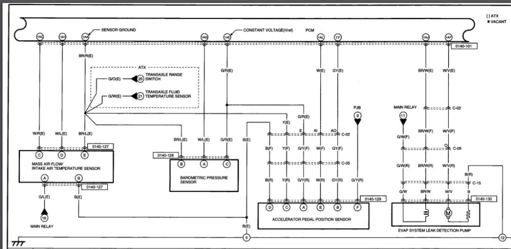

My biggest issue is the 5V reading on the Yellow wire. I've double checked the diagram, and this is definitely supposed to be a sensor ground circuit. :huh: Your picture of the APP connector matches up with the pin positions on the diagram, so I believe it's right.
I don't believe it's chance that the 1AA circuit is shared with the MAF sensor. It's tempting to suggest grounding that circuit, but I think you'd be better off doing a couple more tests first. One, disconnect the MAF and recheck the yellow wire at the APP. Second, with the MAF and APP plugged in, check the brown/yellow wire at the MAF. Like the APP, it should be 0V.

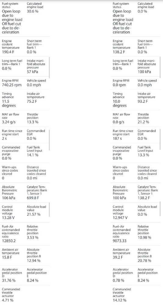

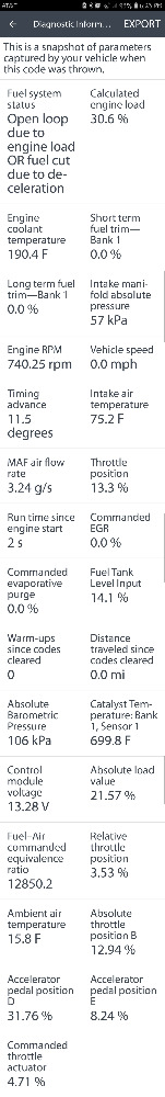

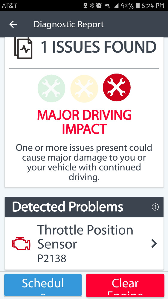

7 years 10 months ago #23768 by danield
Mr. Tyler, here's another one. I hooked a different scanner to the car and it registered code P2138 by itself. I'm going to include screenshots of the Freeze Frame data, temperature looks wrong here as well.
7 years 10 months ago #23770 by Tyler
danield wrote: For some reason the "Ambient air temperature" continues to read -40°c and the "Intake air temperature" sometimes it reads -40°c and sometimes 38 to 45°c, which is normal. The -40°c is puzzling since I'm in Puerto Rico. The MAF/IAT sensor is brand new from yesterday, I replaced another brand new one with this one just in case it was faulty.
That's interesting, because the APP and the MAF/IAT share a sensor ground, according to the diagram. -40 represents 5V at the sensor signal wire, either due to an open signal wire or an open ground.
Thank you for getting those readings at the APP! .2V on the yellow is still a bit high, but definitely better than 5V. :lol: Would you mind trying something for me? Grab a jumper wire and go directly from B- to the yellow wire at the APP (with a backprobe in the connector). Clear the codes and see if the P2138 comes back.

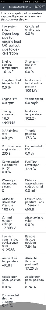

Mr. Tyler, here's what happened. The data on the left is with KOER after I cleared the codes that showed up after our test. The data on the right is Freeze Frame with KOEO after codes came and with the Y to B jumper on.
  • danield
  • danield's Avatar Topic Author
7 years 10 months ago #23789 by danield
Picture order wrong. The single Data Frame is from another test. The picture with two Freeze Frames in it is the one described in the last post.
7 years 10 months ago #23790 by Tyler
Ah crap, same code came back? Ah well, worth a try anyway. :lol: Thanks for giving that a shot.
