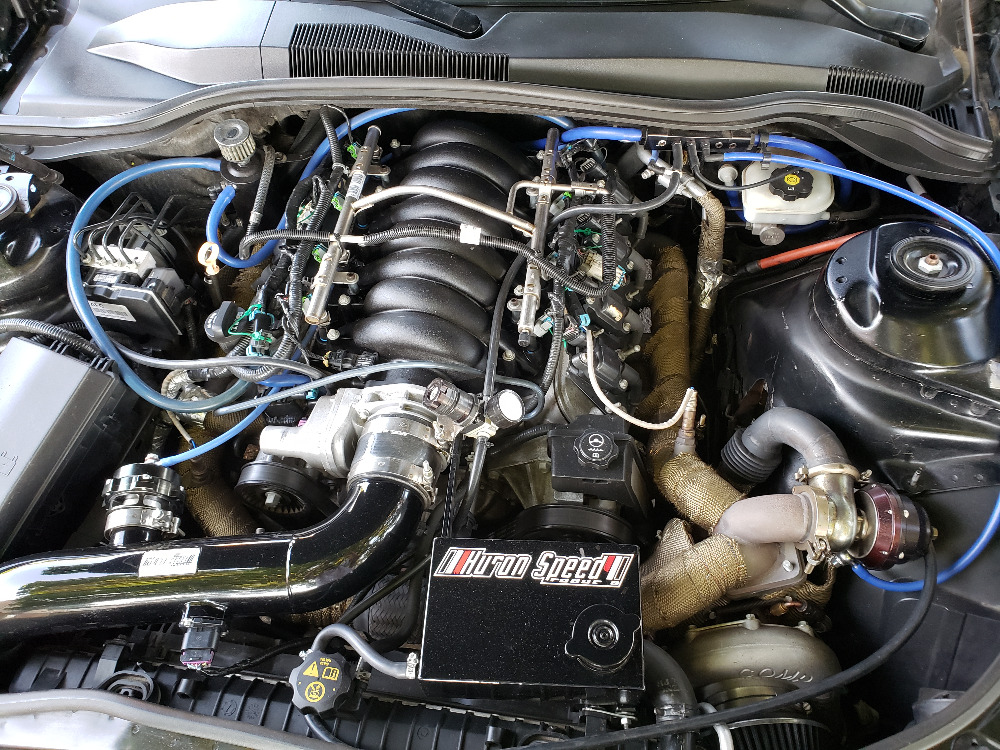

hello, first post but i read a lot around here. so i bought and am driving around a 2011 Camaro 2SS ls3 stock with a Huron single turbo already tuned to 8 lbs of boost. so i decided to change plugs and wires, taking off a plug and the heat wrap on the headers just disintegrates...so, the project begins! i pull the headers and cross pipe and re-wrap them looking around the engine bay and reading around the internet, I thought it would be smart to throw in A.R.P. head studs and LS9 head gaskets. so i put it all back together and went to start it and notice my fuel tank is reading empty and i have 3/4 a tank of fuel then i get the code u0100. did a double check on all my grounds and connections and am not sure what i am missing?
so yesterday i went found all 3 fuse boxes pulled and checked all pcm tcm bcm fuses and now my tank reads again. but i still have u0100 code
so what i think i am up against is a break in a data wire? when i bought the car i started doing some research on the turbo kit and saw mechanic and individual post expressing burnt wires so i bought a lot of high temp shielding but may have broke a wire while installing the shielding? any suggestions would be greatly appreciated!! thanks so much!! also if there is a scannerdanner type mobile electronic repair guy in the Englewood, Denver metro area i would be willing to hire to help me

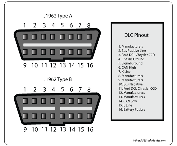

You can also check for network integrity and activity at the Data Link Connector. First, leave the key off for two minutes. Find pins 6 and 14 at the DLC.
Switch the multimeter to ohms and gently probe 6 and 14 at the same time. What is the reading? We want to see around 60 ohms.
While at the DLC, turn the ingition on and switch the multimeter to voltage. Connect the meter to B- and check pins 6 and 14 separately for voltage. What are the readings?

My map sensor reads 7.7 volts and and I am ranging 30 to 40 mv with pins 10 and 6, and 10 and 14 and with the key off I have 0 ohms between 14 and 6
7 years 10 months ago #23761 by Tyler
Replied by Tyler on topic u0100 help with troubleshooting
You're sure about that 7.7V reading at the MAP sensor? :huh: The 0 ohm reading between 6 and 14 is strange, too. I dunno how your code reader got the U0100 if the network is shorted to ground...

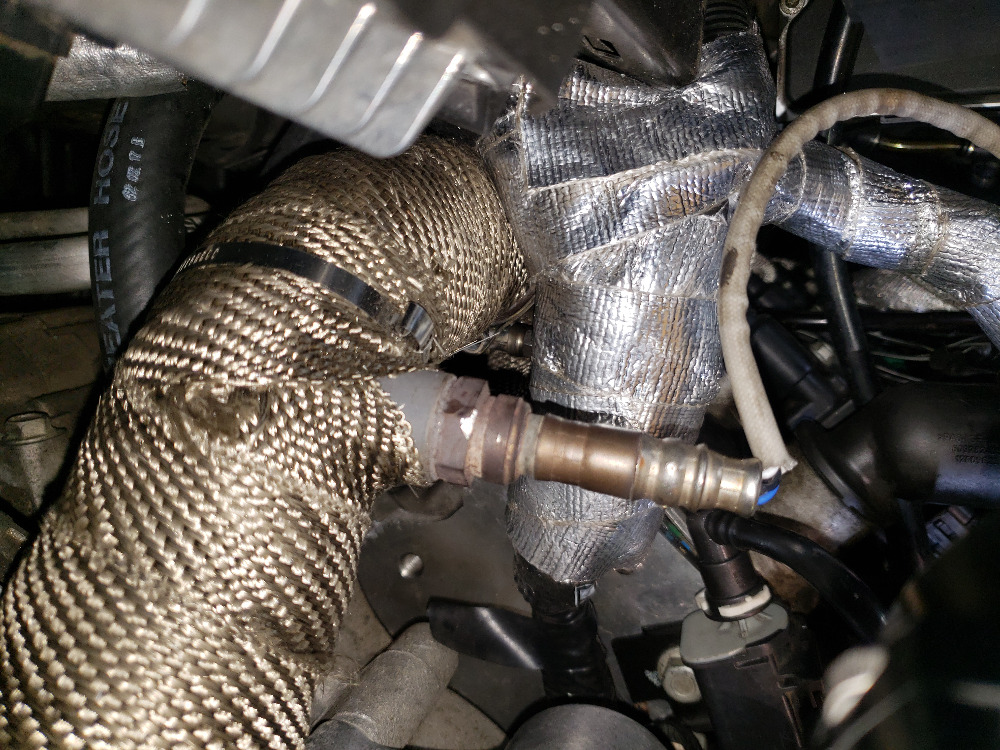

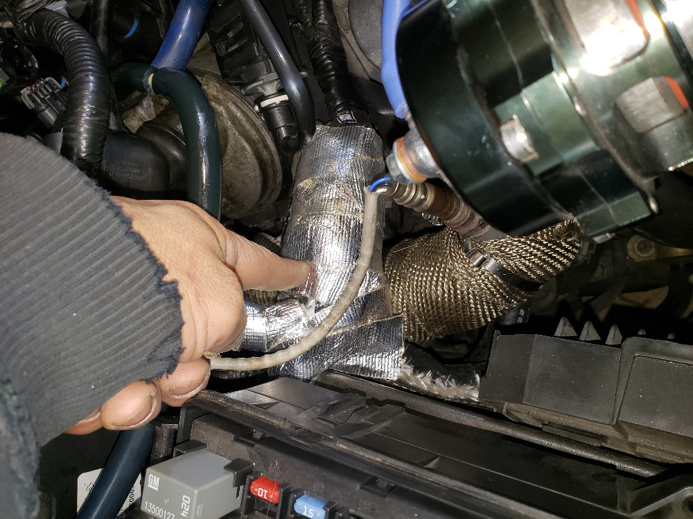

7 years 10 months ago #23815 by 3 Gens
Replied by 3 Gens on topic u0100 help with troubleshooting
This morning I went back and did the check again with the same results. So I decided to take some photos to show where I've done the most bending to add insulation and when doing so I was adjusting the wire harness to sit better and I heard a click of a relay then I heard my fuel level low alarm meaning I have no tank reading again. So I might have found the ballpark area of my break. Or one of them.

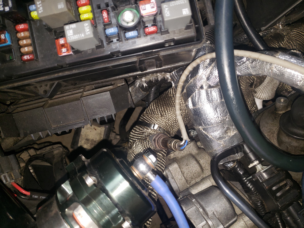

7 years 10 months ago #23816 by 3 Gens
this area here i added firewrap 3000 and reflectant . see how close it is to the exhaust.
  • 3 Gens
  • 3 Gens's Avatar Topic Author
7 years 10 months ago #23817 by 3 Gens
and herer you can see how close the ecm is to the exhaust
7 years 10 months ago #23818 by Tyler
3 Gens wrote: ...and when doing so I was adjusting the wire harness to sit better and I heard a click of a relay then I heard my fuel level low alarm meaning I have no tank reading again. So I might have found the ballpark area of my break. Or one of them.
You're onto something! :woohoo: Perhaps that wiring was heat damaged before you owned it, and manipulating the harness caused some insulation to flake off.
While manipulating the harness, you could rig your multimeter to watch the 5V reference circuit (which was abnormally high last time around). When the readings start changing, you know you're onto something.

7 years 10 months ago #23950 by 3 Gens
big update thank you for you guidance i went into the harness where i said and found a major ground that when i tightened it it turned and broke i reconnected it and my car started right up no issues to show. i have to say that scannerdanner you tube videos made me feel like i could go in there and find it i am so grateful to you Tyler for walking me through it all. again thank you so much

7 years 10 months ago #23971 by 3 Gens
it was a major ground at the from of the block passenger side because i had put extra heat wrap i didn't notice when i tightened it down it turned and ripped apart inside the sheilding so it looked ok and the heat wrap made it look good as soon as i removed the heat wrap the i could see the head of the wire just flopping around this is also why i kinda had connection.unfortunately i didn't take a pic of it till i fixed it. again i cant thank you enough
