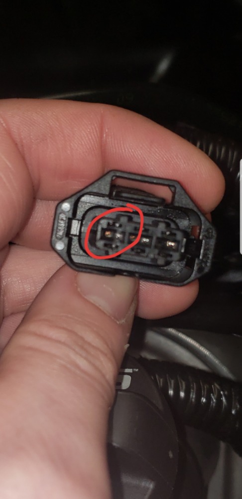

Dylan1214 wrote: But i'm getting the codes and a loss of power steering, Also the majority of my readings (RPM etc) aren't pulling up or being read on HP tuners...
Are these symptoms constant or intermittent?
I check the voltage on my MAP sensor and its reading around 4.7 ish volts, BUT I just checked ohms between pins 6 and 14 and its ranging from -75 to -85 ohms (I'm guessing this is an issue?)
When was the HSLAN resistance reading taken, exactly? Abnormal readings like that may be normal if you took the reading with the engine running or the key on.
Also, which pin were you on when you measured MAP voltage? Engine off or running?
Again sorry for bringing up and old post but i've been throwing myself at this for over a week with no avail, I just wanna drive my finished project :/
No worries! In the future it'd probably be better to start a new thread so anyone else searching for fixes in the future will have an easier time finding it. But for now, let's fix your project. :cheer:
Last edit: 7 years 7 months ago by Tyler.
7 years 7 months ago - 7 years 7 months ago #28094 by Dylan1214
Replied by Dylan1214 on topic u0100 help with troubleshooting
So I get that reading (-750 - -850 ) when I check right after opening my door with motor off and key out, However I check again a couple mins later with door still open, key and motor off and it reads 002
And I checked the first pin of my map sensor which currently reads 4.93 volts
Last edit: 7 years 7 months ago by Dylan1214.
7 years 7 months ago #28100 by Tyler
Replied by Tyler on topic u0100 help with troubleshooting
Dylan1214 wrote: So I get that reading (-750 - -850 ) when I check right after opening my door with motor off and key out, However I check again a couple mins later with door still open, key and motor off and it reads 002
Interesting. B) Is the ECM easily accessible? If so, leave your DMM connected across pins 6 and 14, and unplug all three connectors. Key out, door closed, wait a couple minutes and recheck the meter. Hopefully, it'll be close to 120 ohms.
