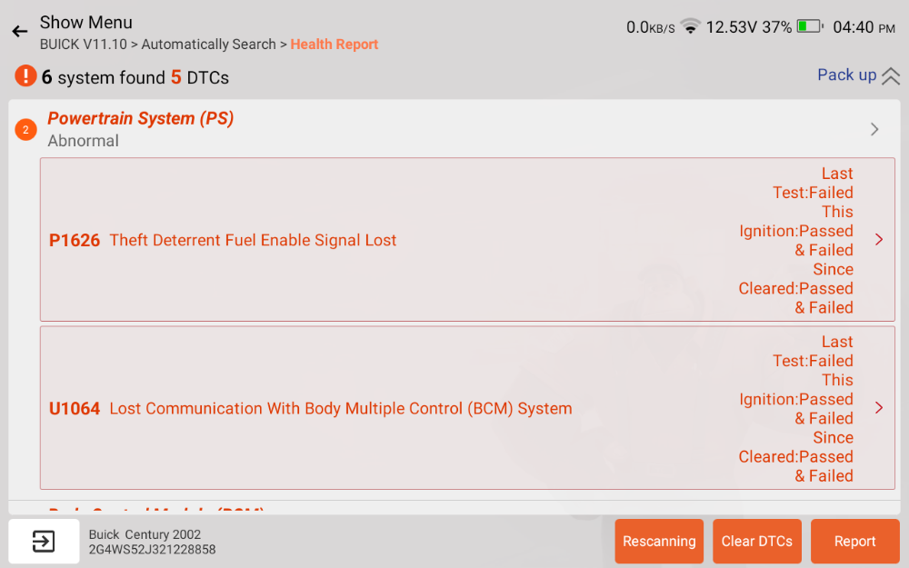

Back at this pia.. I finally got the missing spark located and sorted out and it fired right up and it will run for 30sec or so before shutting off.

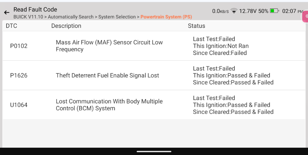

So now it'll throw a code or two.
Current:
PCM codes: p0102. MAF (was disconnected for ECU access)
p1626 BCM theft deterrent
u1064 loss of a class 2 module communication.

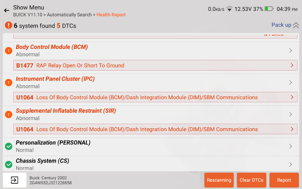

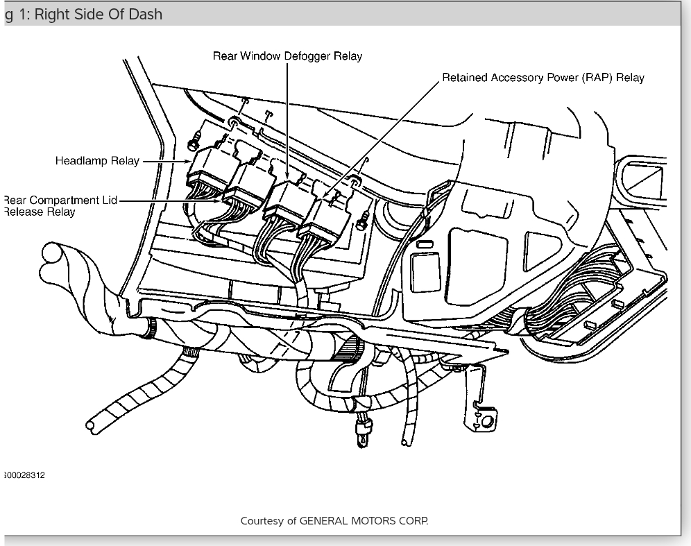

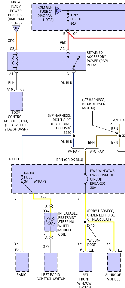

The one that comes back after clearing them that has me totally confused is B1477 a missing RAP (or Retained power) relay communication.
I had to look for a while before finding it hiding behind the glove box and that's when I got lost.
The data shows it's location but that location is empty... An empty slot on the metal relay mounting bracket but no wiring harness, connector or relay to be found.
I have ordered a new one and an Rlink J2534 to program it with but don't really want to open either package if I can find a way to prove it's not* the BCM wanting to talk with a relay that's not even present on the car.
Any suggestions would be helpful.. hopefully.

1 year 3 months ago #92059 by Noah
The p1626 refers to the fuel enable status for the theft deterrent system.
Like Tyler suggested in your previous repair question topic, it would be wise to watch to fuel enable and theft status PIDs during the stall.
B1477 refers to RAP or Retained Accessory Power. This is when you turn the ignition off after a drive and can continue to use the radio and power windows before you exit the vehicle.
Most likely not related to the issue at hand.

1 year 3 months ago #92060 by StepSide88

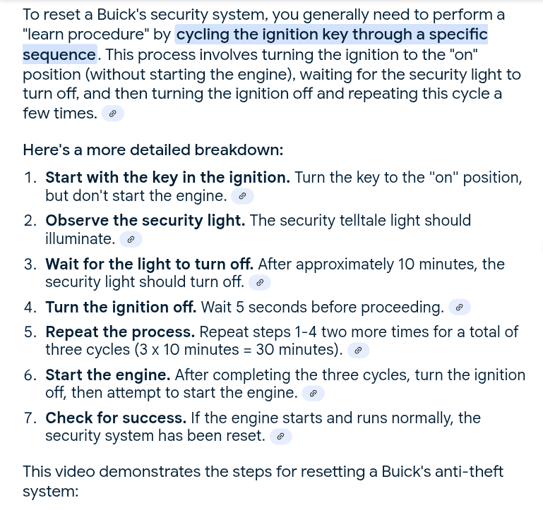

Thanks for the reply, in looking up info on VTD system I saw a theft deterrent reset option and it went nowhere fast. (See pic)
The security telltale remains long after 10 minutes so the next step seems unable to process further.
Pids.
VTD during key start showed Yes to the PCMVCM in VTD fail enable ' pid
and Inactive for the fuel disable and automatic learn timer pids.
The Class 2 DTC check shows dtc's present in all the modules connections except
PCM/BCM
BCM/BFC/DIM/SBM/TBC
IPC
ABS/TCS
and the supplimental inflatable restraints.
The IPCluster shows a U1064 loss of comms with BCM/DIM/SBM
The Chassis has lost comms with the PCM and reports the class 2 malfunction
It sure seems the BCM is the common denominator to me but I'd love to be wrong about it. Any more suggestions?

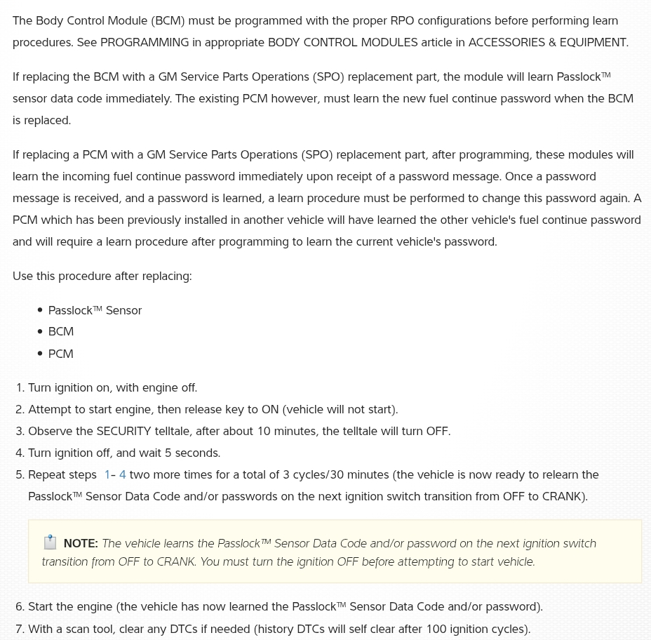

1 year 3 months ago - 1 year 3 months ago #92061 by Noah
Find attached the location and power distribution diagram for the RAP relay.
As you can see, the diagram shows that, if equipped, the RAP relay is power for the sunroof and windows.
Also find attached the Passkey relearn procedure as outlined by General Motors in service information.
Google or whatever AI isn't exactly the most reliable source of information. There a few variations of the relearn procedure and they must be followed exactly as outlined or will fail. I know from experience that 10 minutes means EXACTLY 10 minutes. If you let it sit 10min and 10sec, you need to start the process over. If you accidentally turn the ignition to the Crank position instead of the On position, you need to start over.
Some of them want the ignition turned to Crank initially and some of them want the ignition turned to On initially. If this step is not followed correctly, you need to start over.
It's very easy for this "30 minute relearn" to run well over an hour.
This alone seems to indicate an issue with the security system. As I I recall, the indicator should illuminate momentarily for the bulb prove and then go out.
Yes it should go out but it stays on so do I wait for it to go out or turn the key off at 10min regardless? also fwiw service engine light is on.

I understand the RAP isn't that important but the why* it's being coded still confuses me.

-IF the car consistently starts, and then stalls, this is typical of an anti theft issue on that generation GM.
-IF when the car starts and stalls, it then sets B1626, this reinforces the idea that there is an issue with the theft deterrent system. This idea is further reinforced by the report that the theft system indicator lamp never goes out.
If I am interpreting the symptoms and course of events correctly, then I would say that you should perform the VTD key relearn exactly as outlined by service information.
To answer your question about this test: I would turn the ignition off after exactly 10 minutes had elapsed if the indicator went out or did not.
Typically, it will go out after 10 minutes if the process has been properly initiated. There have been instances when I have done this procedure and the light did not go out after 10 minutes. I find it best to continue on as instructed.

That method is faster, but it is not necessary. The 3x 10 minutes relearn is an alternative to the factory scan tool method.
I think at this point buying a J box and service information subscription may be an unnecessary expense, but that's completely up to you.

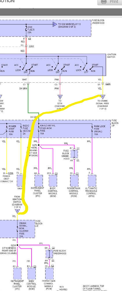

After my cousin suggested that and I checked the BCM ohms readings one of the first vids to show up on my YouTube recommendations was one of your VAT resistor replacement vids for a 98 buick. Still not convinced I need to go there to fix my issues with spark.
Fuses and relays haxe been my focus when not installing replacement garage doors and stuff, and I did find a circuit to investigate,
The IP panel fuse for Crank, BCM ,Cluster and the one for the Heated mirror have no voltage going to in from the under hood fuse box 30A Ignition main fuse which is good and powered up.
So that seems like the best place to look.
Again..any insight is appreciated.
Thanks.
1 year 2 months ago - 1 year 2 months ago #92087 by Noah
If that fuse does not have power key on, or in the start position, but the 30A fuse under the hood does have power, then you should investigate the circuit from the ignition switch, or the ignition switch itself.
Tell me if I'm looking at the correct fuse on the diagram.

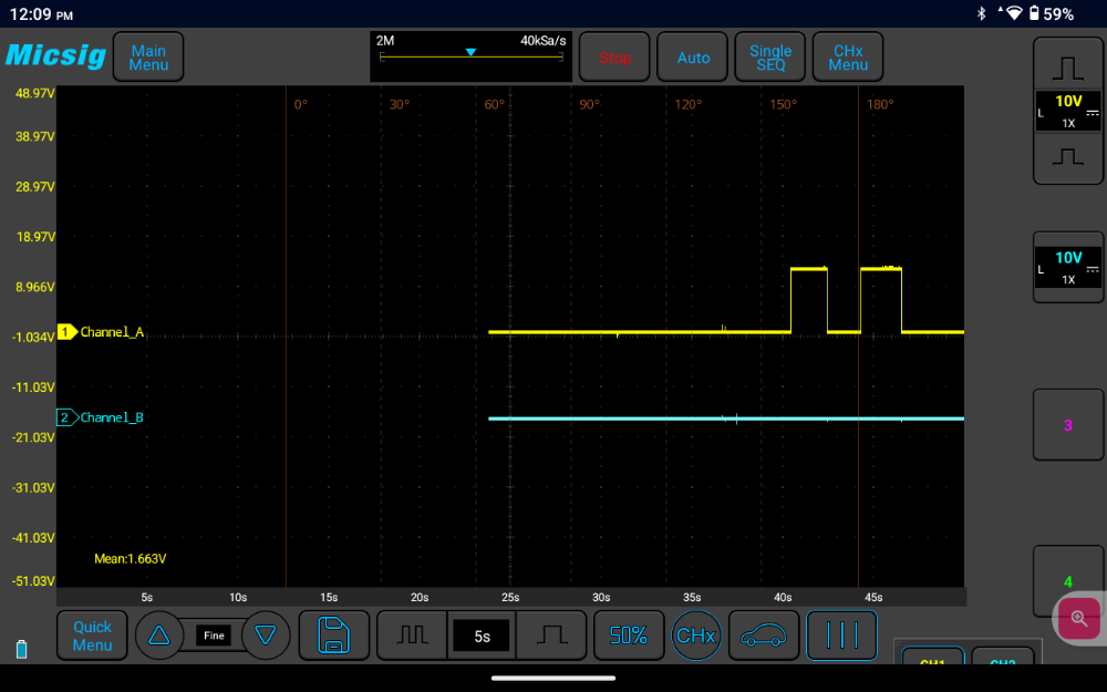

1 year 2 months ago #92090 by StepSide88
To busy to do much but did get this..
Fuse out and scope was hooked to leads from the fuse box terminals,
IP panel fuse A_3 & 4 (Crank signal, BCM, Cluster) channel A = 3 and B = 4 you can see the KI + KO prior to Start event (2x) so why is the supply from H (your line) is missing in the run position or does it stay on if the A_4 side of the fuse send a signal through the CAN bus?
Any particular events or tests you would like to see let me know.
Thanks again
1 year 2 months ago - 1 year 2 months ago #92092 by Noah
I don't see in the diagram what you are referring to? There will be no CAN bus signal transmissions through these fuses, this is strictly power distribution.
If there is no power at the yellow wire that is labeled H in the diagram at the interior fuse panel with the ignition switch in the start or run position, then you must check for power on the yellow wire labeled D1 at the ignition switch with key in the on position, and with the key in the start position.
Missing the power here with the key in the on position and in the start position only would indicate an issue with the ignition switch (assuming the power feed to the ignition switch on the red wire is intact.)

I ran tests on the key switch circuits between the IP panel and the harnesses 8745 and  85929 feeding up into the column.
8745 comprised of 8 and 10 gauge wire leading me to think those are the power supply from the battery etc.  I found all but the Dark green wires in that bundle.
There were 2 drkgrn in 85929 one 12gauge the other 14. My screenshot is the 12g one.
I'm  also running the AD diagnostic test for the ICM communication with the ECU rechecking all the connections are in the right order etc.. looking for the missing spark. But the fuse seems like the priority problem to me.
From what I can tell I think the next step is trying to run a trace from the IP panel fuse terminal back to the column and see what I can find out.
(Photo label describes the test in detail.)
Under col = tested harness there... Otherwise @ the IP panel terminals.
