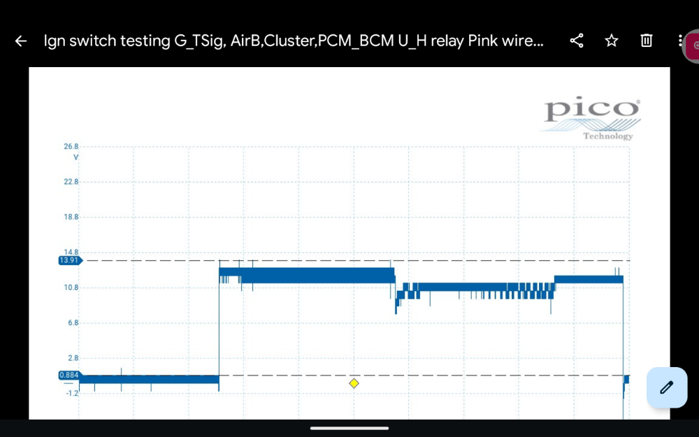

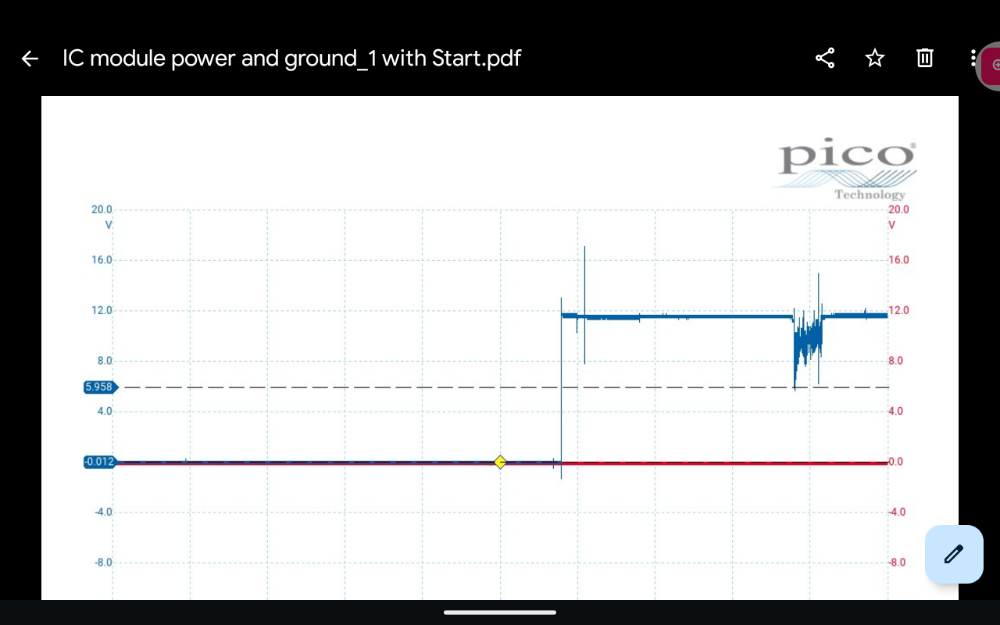

Here's what I have for today..
Bottom line no power to IP panel A3&4 ( or 5&6)
And H works in Start but no voltage at Run.
Still have the  P1626 in the PCM and B1477 in the BCM..

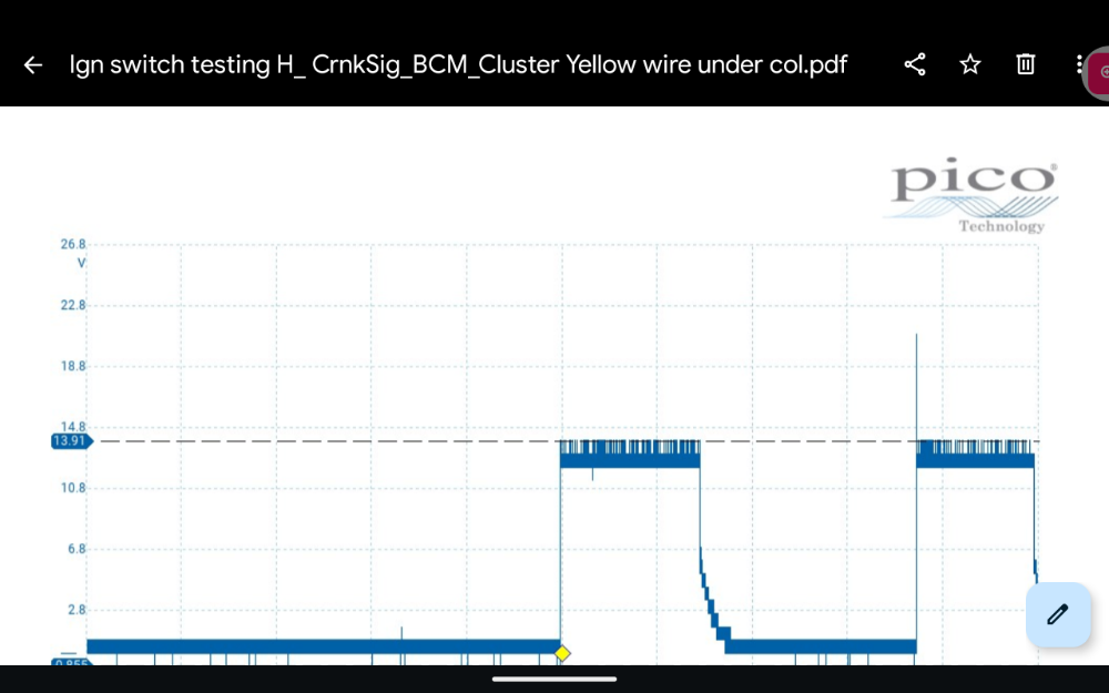

1 year 2 months ago - 1 year 2 months ago #92126 by Noah
If you are back probing this yellow wire directly at the ignition switch connector and only have power while cranking but not in the Run position, then there is a problem with the ignition switch.
Last edit: 1 year 2 months ago by Noah.

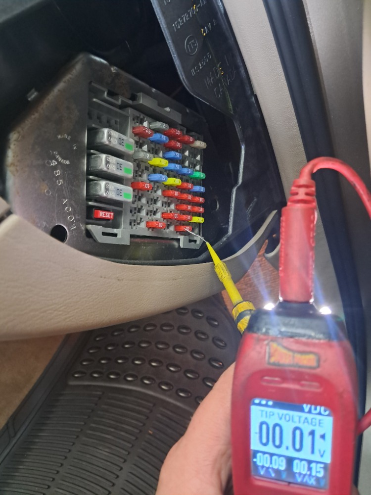

1 year 2 months ago #92152 by Noah
All of the testing I have recommended was to be done at the ignition switch connector, back probing with the connector plugged in. I really cant make that any more clear.
You're not proving anything we don't all ready know by continuing to test at the fuse panel.
You know there's no power at that fuse, that's why you need to move further up the circuit and check the source.

1 year 2 months ago #92158 by StepSide88
Back pinned the new switch and same results on the yellow wire.
0.0v @ Run
12v @ Start

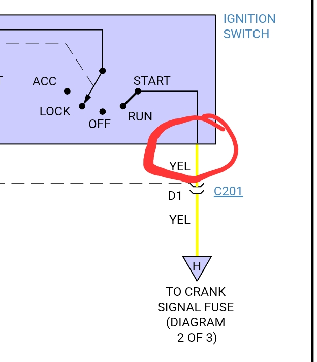

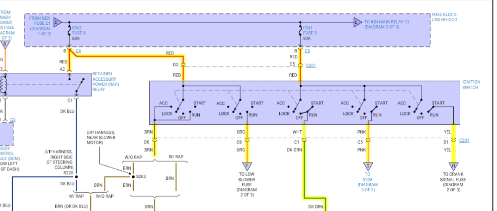

1 year 2 months ago - 1 year 2 months ago #92161 by Noah
It defies logic that both switches would fail in the exact same manner, but like I mentioned before, we have to trust that you are performing the tests correctly.
According to the diagram I have attached earlier, the yellow wire labeled D1 on ignition switch connector c201 should be hot in run or start.
Assuming the diagram I have attached is correct, which I believe it to be, and assuming source voltage from the fuse is good (which it must be to have power in Start) with the ignition switch in Start (being engine cranking) or with the ignition switch in Run (being the position the switch defaults to after releasing the key from Start) there should be power on the yellow wire labeled D1 while back probing the ignition switch side (not the body side of the harness so as to rule out a terminal issue in the connector) of connector c201. It is a straightforward switch circuit, the only fault can only be the switch itself. There are no more trouble shooting steps for no power on D1 in Run and Start.

1 year 2 months ago #92167 by Noah
So maybe we're not exactly on the same page, I have the Buick in the shop right now for front end work and decided to poke some fuses.
If this is the fuse you are saying has no power in run, then that appears to benormal. The car is running right now.
  • StepSide88
  • StepSide88's Avatar Topic Author
1 year 2 months ago #92168 by StepSide88
That is the fuse. I guess I can check the BCM for it's power at B9 .. as that's where the codes are seemingly being generated.
