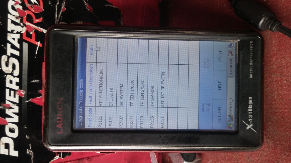

It's back sentra lack of power with codes p1122, p1121, p507, p0223, p0123, p2135 and p0731. With all these codes where should I start? The last time I replaced t/b from juck yard. I did not like that the car had no power on a slop sometimes but the customer said it was good and she took it. Now it's back and I'm coming here first before I do anything.
I Thank you for your help.

Gotcha. So, most of those trouble codes return at the same time as the lack of throttle response?
I figure the P1121, P1122 and P0507 are symptoms of the TP position codes. I'll have a look at the wiring diagram in a moment...

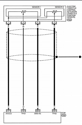

Had a look at the diagram:
5V and ground are shared between the two potentiometers. Because P0123 and P0223 are listed as 'circuit high' codes, I'd tend to suspect a ground problem. How's the pin fitment on the throttle body connector?

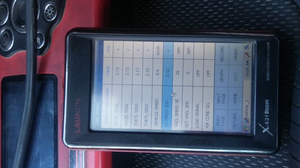

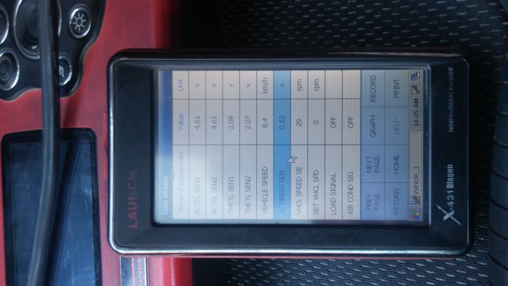

Hey Andy thank you for your responds brother here are some pic. of accel sen1 and 2 with thrtl sen 1and 2. On the scanner I get a respond but on the throttle nothing. At idle it does get a signal cause it revs just fine just under a load nothing. Today I put a known good t/b and same thing so I guess I now have to chase wires.
Thank you.

Tyler the plug looks good, so you saying to check ecm grounds 5 at t/b and 66 at ecm?

gilbert wrote: On the scanner I get a respond but on the throttle nothing. At idle it does get a signal cause it revs just fine just under a load nothing.
Wait, so KOEO the throttle will sweep normally? :huh:
