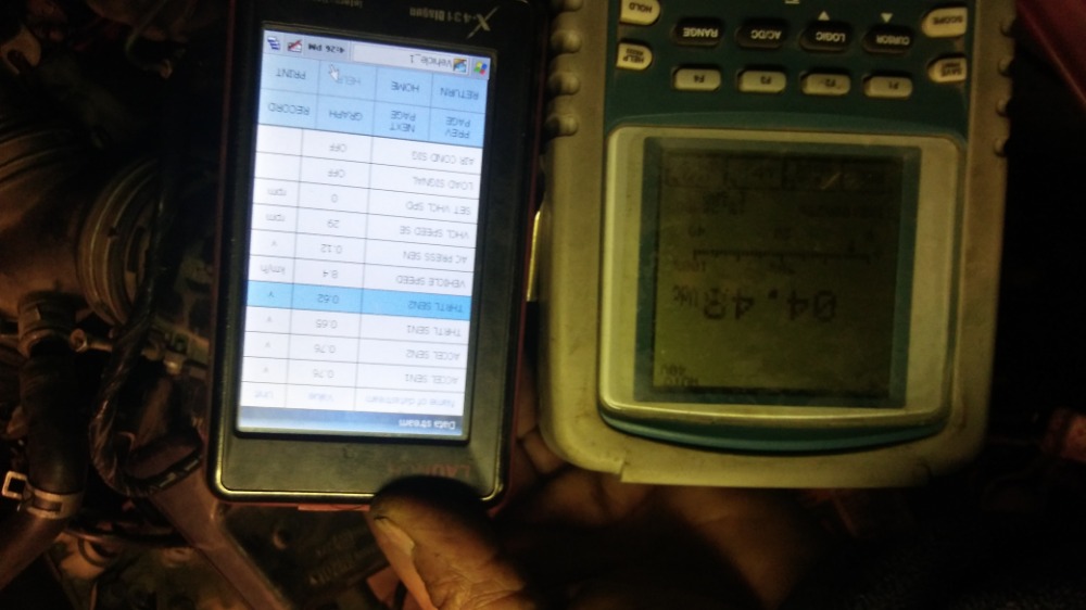

Mr. Andy .MacFadyen said it might be a charging problem so I took a closer look at the system put the voltmeter on the batt. and got 14v car on.
Next I went to the alt. batt, cable at alt. 14v at alt. plug the grn/ blk wire reads 14v and the wht/red reads 12.30v is that a bad alt.?
I also checked voltage at every wire at the T/B blu. wire reads 165mv at idle and at 2500 rpm it reads 1.5vlt. the pnk wire reads 1.7vlt and at 2500 rpm.
Grn wire TPS 2 I get 4.47, red wire 033mv, wht wire 665mv, blk wire 5v. Question here is what should the TPS 2 wire be reading.

Hey Tyler I forgot to mention that as I was checking the the voltage on the T/B that on the grn wire TPS2 I was reading .62mv on the scanner and on the voltmeter I read 4.47v.

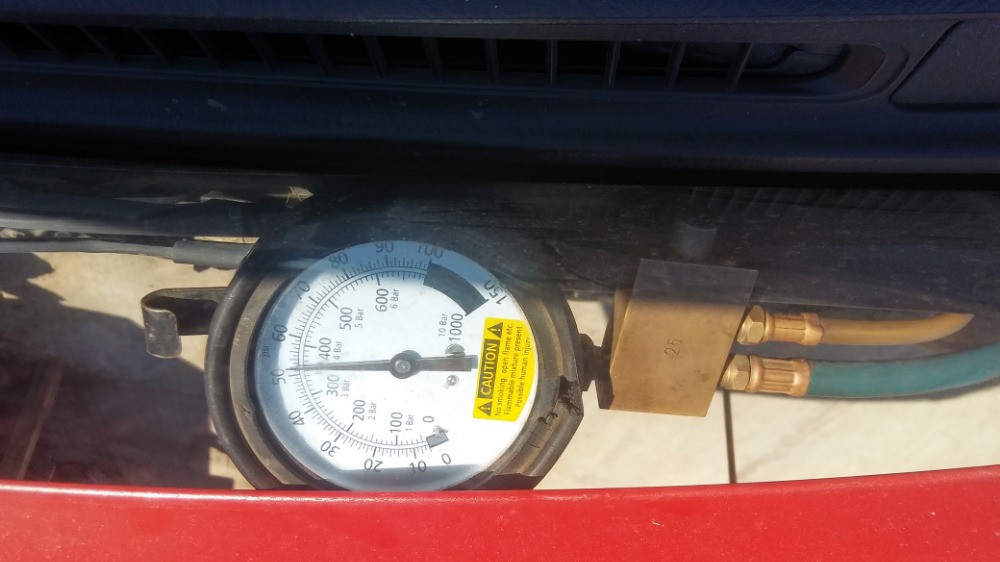

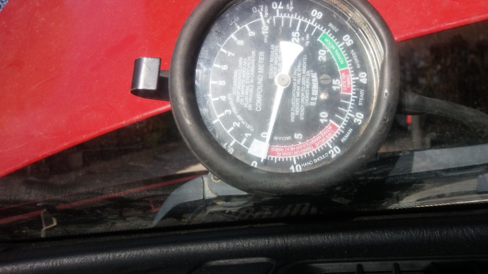

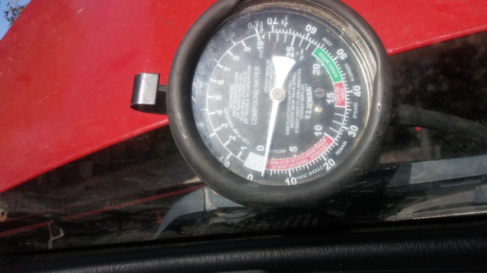

You pulled the o2 up top correct? The one in the top of the manifold/cat assembly? Even so I would feel better about seeing numbers while this is going on. Back pressure testers aren't very expensive but take it from someone who knows....don't buy one with a rubber line and try to drive it around much. :lol: Also, how is the fuel pressure while it's occurring?

What do you think of the grn wire reading at the T/B plug and the reading on the scanner grn wire being tps2. As you can see there are two different reading scanner does not match voltmeter.

Busted Knuckles brother I did do the relearn and it's the same. I just did the fuel under load and her is a pic. The back pressure i.o.u I can't fined one. I live in Ti Juana México and my local store doesn't have one. The fuel pressure does not drop it remains around 52psi and rpms about 900. This was done in reverse. The car acts the same in drive that is the reson I don't think it's a trans problem. The trans code I get is a 1st gear code but like I said in reverse it does the same.

Busted Knuckles God is good I went to the flee market and I found a gauge so here is back pressure test pics.
One pic is at idle and the other is at 3500 rpm they both look the same s I think it's good.
