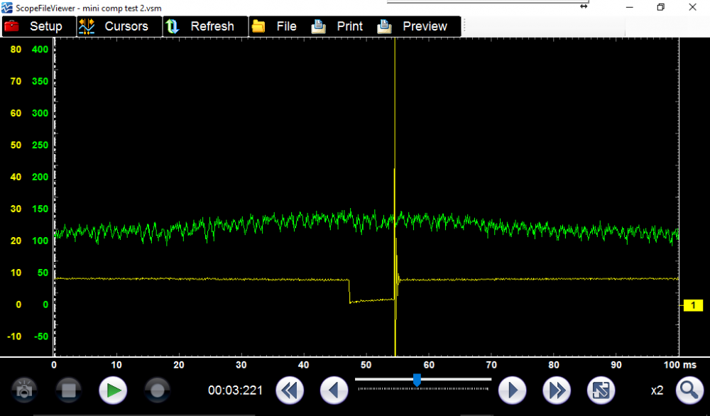

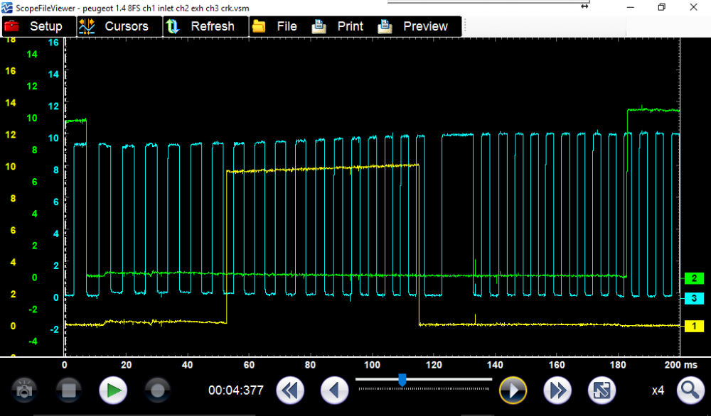

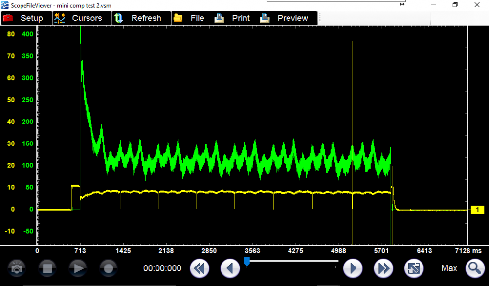

9 years 11 months ago - 9 years 11 months ago #3652 by steve
Replied by steve on topic Crank no start, no spark
Just been looking through some of my old files and I have a mini one 1.4 vti compression test with ignition sync.
Looking at the trace it seems the transistor is inside the engine ecu
I have also attached a good Peugeot vti cam/crank waveform
File Attachment:
File Name: peugeot1.4...3crk.zip
File Size:753 KB
Last edit: 9 years 11 months ago by steve.
