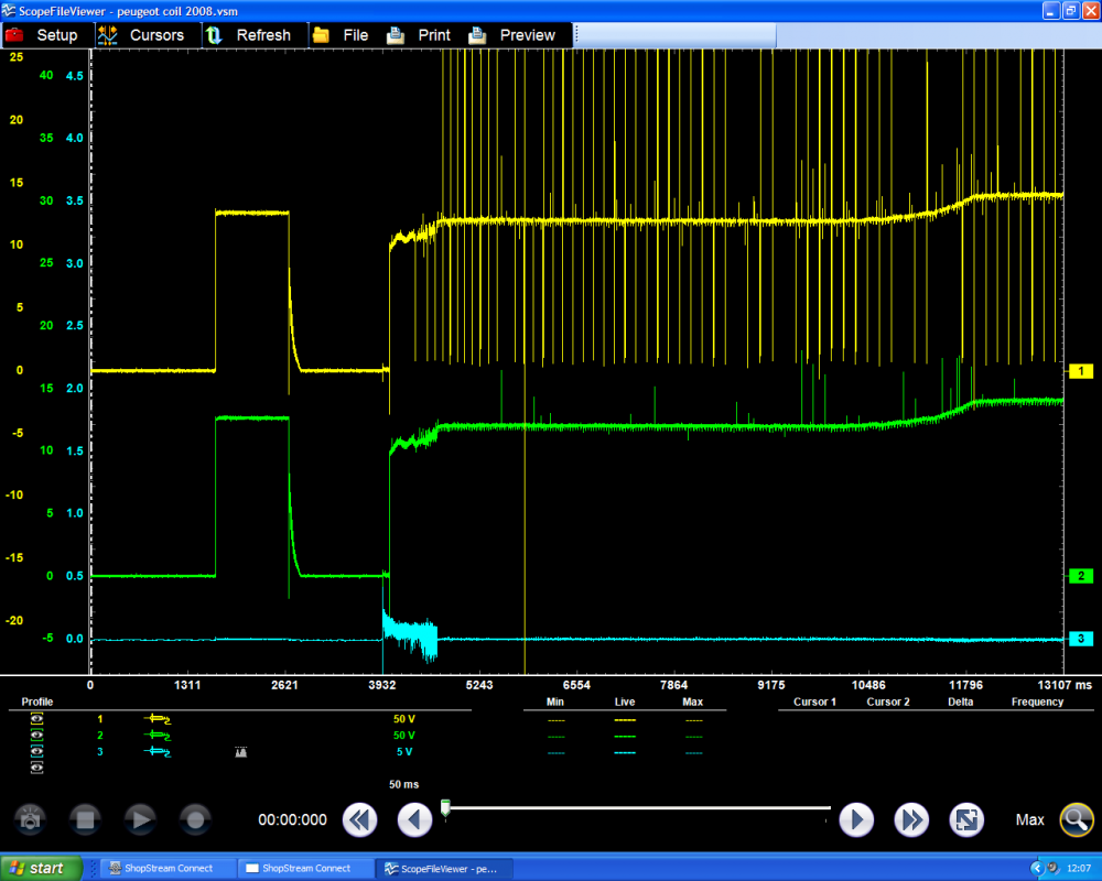

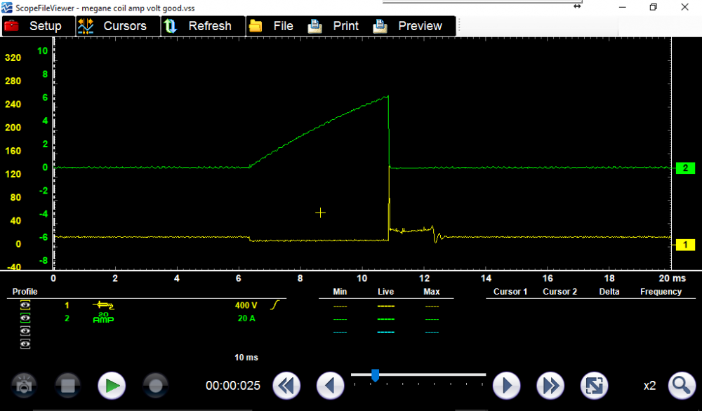

Wow it does look like the transistor is in the PCM judging by the second waveform. Interesting. Why the 3 wires on the coils then... constant power, constant ground, and a computer controlled wire. I would like to know what the voltage is on the middle pin of the coil.
9 years 11 months ago #3663 by borntoroll
Replied by borntoroll on topic Crank no start, no spark
Thanks for the waveforms. Flyback voltage spikes make it looks like the driver is in the PCM and it controlls ground side. So the primary must be 1 and 3. When computer commands 1 to be ground it energises the primery coil. When it switches off we see spark and flyback voltage spikes. seems legit ^)

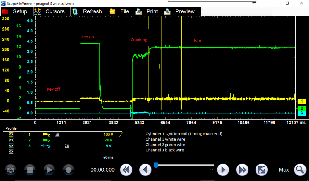

Right, had one of these in for mot today so grabbed this for you
Back probed the coil in cylinder 1 (timing chain end, what the French call cylinder 4)
Last edit: 9 years 11 months ago by steve.
The following user(s) said Thank You: jonathandean, borntoroll
9 years 11 months ago #3689 by borntoroll
Great info. Wish the yellow channel was a bit close to the green scale.

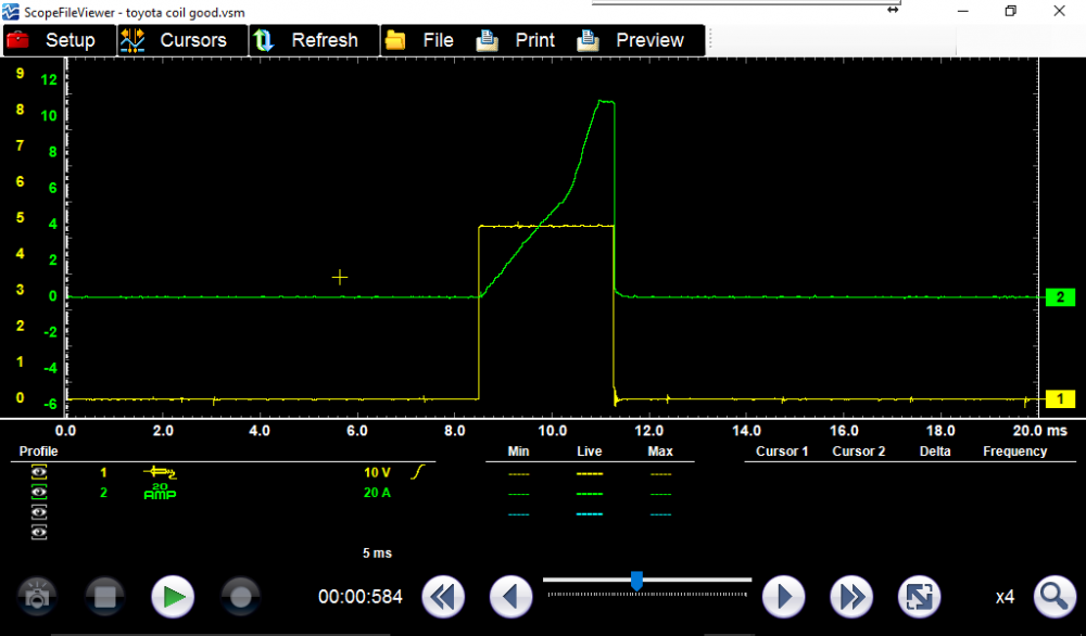

Hi, Just a question if you don't mind, what tells you the transistor is inside the ECU? Thanks Jonathan
9 years 11 months ago #3808 by steve
Replied by steve on topic Crank no start, no spark
You can tell by what you see on the control wire
If you see coil negative
Then the transistor is in the ecu
If you see a square wave then the transistor is in the coil
Here's a good video
