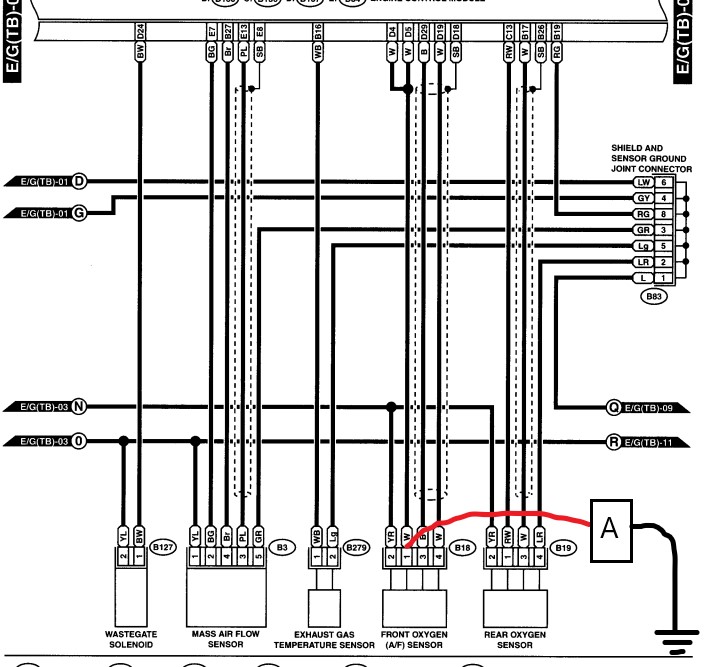

No I have not tried to manually ground. Where would you suggest I add the grounds?
I guess I could back probe a wire directly from the sensor's bulkhead connector, running the wire to chassis ground.
Last edit: 7 years 6 months ago by lottadro.
7 years 6 months ago #29240 by guafa
Yes, that could be a good point.
Make completely sure is ground pin where you are. Otherwise if you ground heater power, you will blow a fuse or something else (general speaking).
7 years 6 months ago #29241 by guafa
To be safe, you can add a 10 amp fuse in series.

Ok, something bizarre happened. I added the ground from the bulkhead connector at the sensor.
I checked voltage on this new ground and it read within spec. .5V.
However, starting the car gave me the p0031 code, heater circuit low. I removed the ground and back probed at ECM connector D4 D5 again, and started car, during operation the pins showed between 7-8Vs. However the idle cleared up, my AFRs were not hunting all over the place. Additionally, a new code appeared p1139, heater circuit not within range. I am not sure what to make of this bizarre situation.
Last edit: 7 years 6 months ago by lottadro. Reason: code correction

I like guafa's suggestion about manually fielding the stock AFR sensor heater. As an alternative, you can also use the ammeter function in your multimeter to act as both a fused jumper wire AND measure the current of the circuit. I'd expect one amp of current, likely more if the sensor is cold. If you see good current flow, then you know the heater and the wiring is good. ;)
As noted, double check which wire you're grounding. Isolate the ECM if you have any concerns.

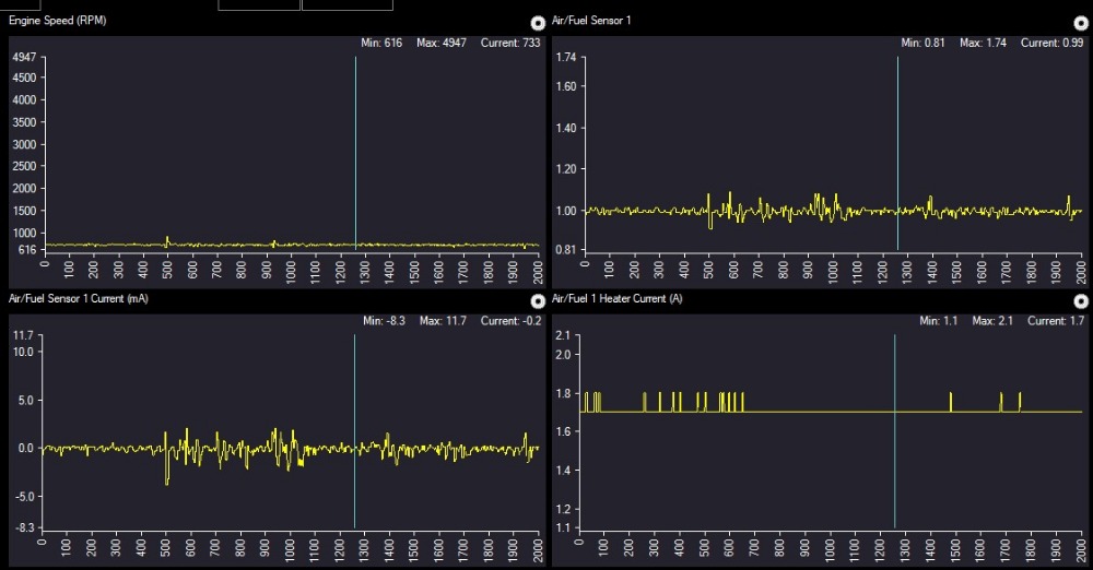

When the o2 is plugged in I get p0301-4 and p0037. Unplugged p0031 & p0037. P0037 pertains to rear sensor, which has been defeated in tune, however will reappear when there are other codes thrown.
Recently when I had that ground manual inserted at front bulkhead connect at AFR sensor, I was getting p1139 and p1130. I went through the diagnostic steps outlined in the FSM for both of those which ended by saying swap out front AFR sensor.
Proceeded to do so, and am back to square one of rough idle and misfiring. Additionally, a torrential down pour started along with thunder. So, today seems to be shot for working on it anymore.
Also I havent had the rear o2 in for a while. The wideband does show swings to lean when it misfires though.
This folder contains both a video and image related to both plugged and unplugged and are labeled accordingly, the image shows the codes I am pulling corresponding to the state of the sensor.
