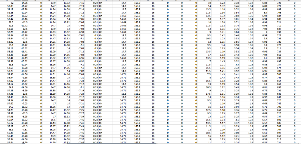

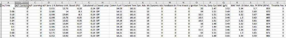

Tyler, attached are a slice of the datalogs I had sent to the tuner. I couldn't upload the whole excel file because of format restrictions on site. This is the car at idle. One picture you can see the title of the columns and the other a slice from farther down. You can see the hunting AFR and the fuel correction going wild.

lottadro wrote: Tyler, attached are a slice of the datalogs I had sent to the tuner. I couldn't upload the whole excel file because of format restrictions on site. This is the car at idle. One picture you can see the title of the columns and the other a slice from farther down. You can see the hunting AFR and the fuel correction going wild.
I didn't expect to see that. :silly: :blink: If I'm reading it right, the trims are going negative at the same time the AFR is showing lean. Why would the PCM see a lean mixture, then take more fuel away?
Would you mind sending me the whole file? wrenchturnsyou@gmail.com Does my interpretation of the data make sense to anyone else?

7 years 5 months ago #29332 by Tyler
Got your e-mail, thank you. :cheer:
I see the fuel trims and AFR is actually swinging both rich AND lean, but I'm guessing it runs the worst when the trims are negative. Also definitely seems to be happier off idle. Much happier off idle. :huh:
You can also 'see' the AFR cycling back and forth in the data, just like in your video. Like the PCM can't get into fuel control. AFR systems don't typically chase their tails in this way.

From looking at the data file, I can see this issue happens in closed loop only. Open loop makes the engine happy. When the issue is happening at idle, the AFR says lean, but the trims are negative. This is an inverse reaction, and suggests the PCM isn't able to control fuel correctly.
Why? Is the AFR not measuring it correctly? Based on the first video lottadro posted, I'm saying no. His added downstream AFR agreed with the stock upstream AFR, more or less.
The only way this makes sense (to me, anyway) is a false rich condition. PCM sees rich, takes fuel away. Only, there is no rich condition, and now the engine doesn't have enough fuel to run correctly. :angry:
This is my understanding of the situation, anyway. :silly: I welcome any criticism you or anyone else may have.

Tyler wrote: [When the issue is happening at idle, the AFR says lean, but the trims are negative. This is an inverse reaction, and suggests the PCM isn't able to control fuel correctly.
Leaky injector? I honestly have no idea, I feel way over my head on this. The trim starts a negative trend almost immediately and doesnt really recover, if an injector was leaking fuel would that be enough for the sensor to be constantly needing to reduce the trim but not being able to? Thus creating a lean condition within its AFR but seeing the fuel and reducing trim? Does that make sense?
