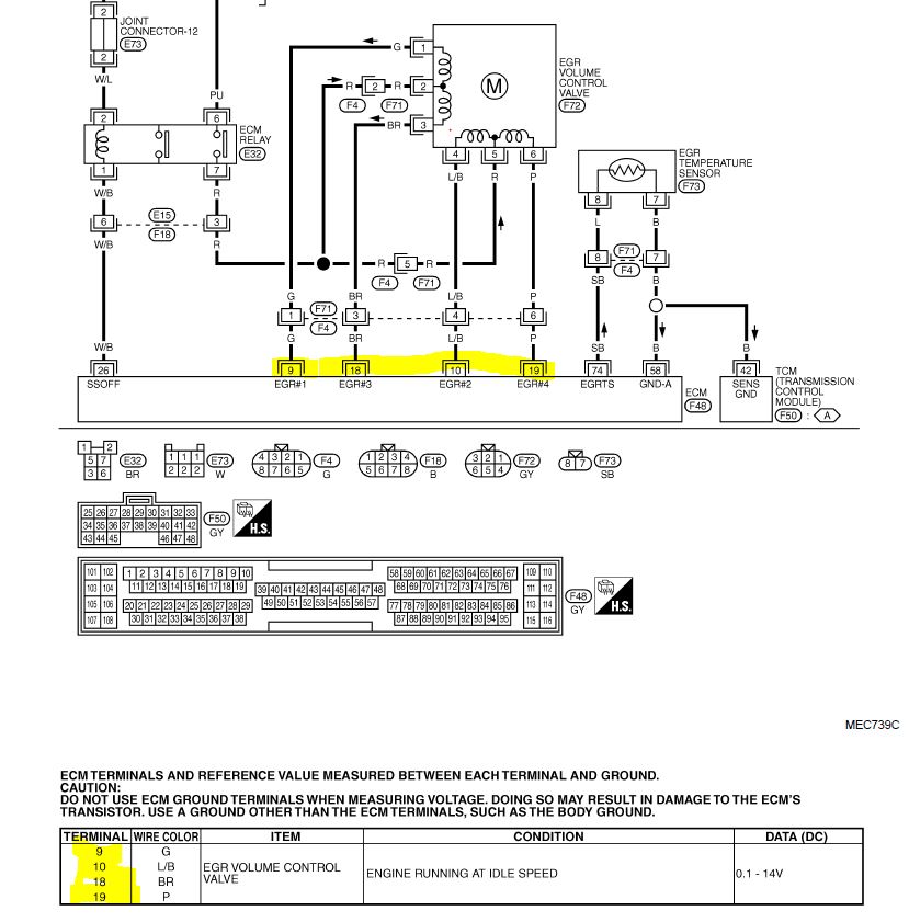

The one test that was off was the the signal from the ECM at Idle. See below diagram.
It says I should have 0.1-14V at idle speed on those terminals coming off the ECM. Terminal # 9 was 0.14V with no change when RPM was revved. Terminal # 10 had 0.02V at idle but jumped up to 0.1V when revved. Terminal #18 & 19 were 0.00V both at idle and revved. What do you call these signals? the voltage reference? why is it 0.1 - 14V though instead of commonly 5V.
Based on trouble shooting above, do I need new ECM? What other test to isolate this possibility. I was thinking about back probing the connector while it is plugged in and monitor the voltage changes under expected EGR actuation based on engine load and speed, but what that mean is I need to O-scope, which I don't have. Is there a decent troubleshooting OBD 2 that can do bidirectional test and show these feedback that doesn't cost as much as the car itself?
I would call them ground side control wires that get pulsed by the ECM. Assuming EGR relay is energized you will have 14v (assuming alternator working), at each of the 4 wires going to the ECM. When the ECMs wants to move the EGR valve (which should NOT happen at idle) the control wires will drop low, if using a slow DVOM, but really it's just a really fast pulsed ground provided by ECM.
Rig up a test light that's connected to battery positive, taped to your dashboard. The other end would be connected to one of the control wires. If the ECM driver is good, the light should turn on when EGR is commanded by appropriate driving condition. Test all 4 control wires this way. But really, find someone with a bidirectional scanner.
If one light or more fails to light up you might have to consider that a shorted coil inside the EGR took out ECM driver or maybe an intermittent short to power near control wires cooked the driver.

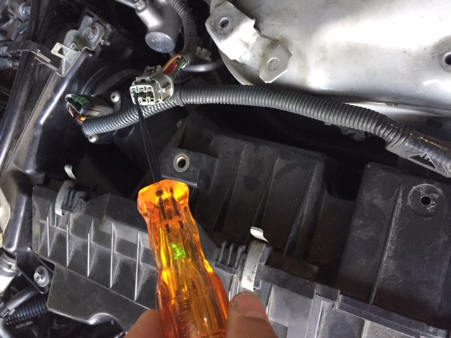

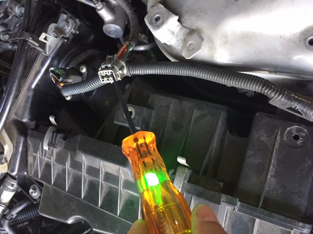

So, while the engine is idling, I disconnected the EGR plug and using test light connected at positive battery, I got Terminal # 9 lit up green and the 10,18, and 19 only dimly lit.
Terminal # 9
Terminal 10, 18, 19
So I don't think its open since the green LED lit up (circuit is close to ground). It indicates what my VOM did which is higher voltage in Terminal #9
For Short to ground test, I unplugged the ECM connector and probe the 4 terminals at the EGR connector with test light connected to the positive battery. no green light, which mean no short to ground either.
This basically proof that the harness have no short to ground condition and the first test proof that it's not open either, right??

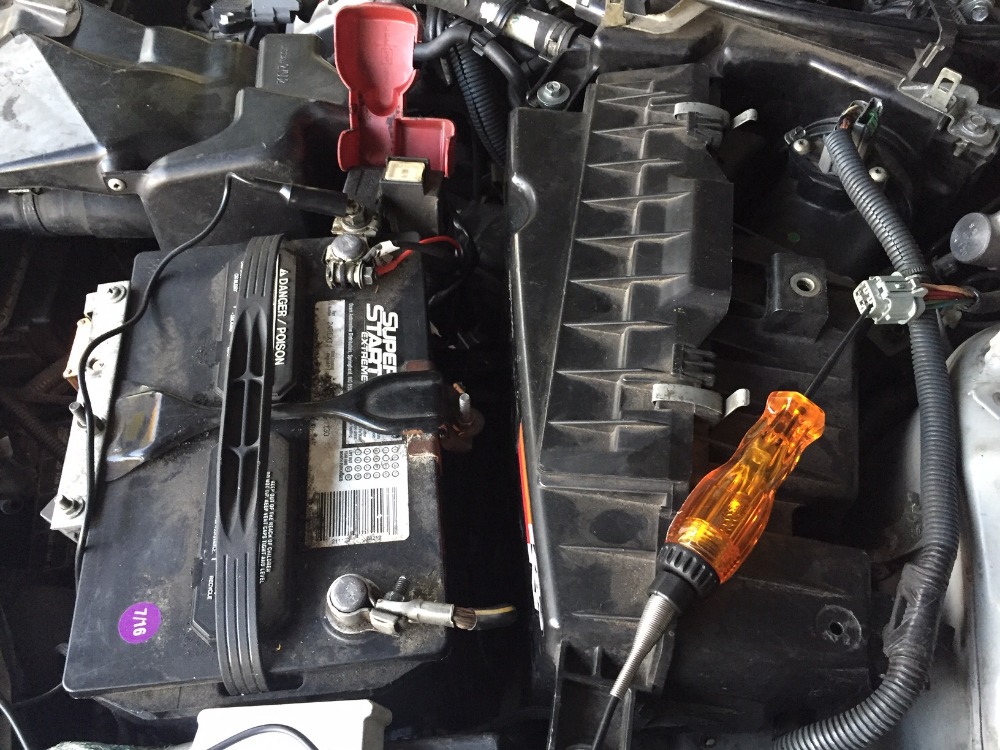

I swap the EGR to the IACV connector and the EGR actuators cycles fine, while the IACV didn't cycle.
Looking at IACV resistance, it IS indeed the same as the EGR resistance. IACV not moving indicates bad ECM, bad wire, or maybe IACV doesn't work with control signals MEANT for an EGR valve (I don't know lol).
I would be fine with a 1 amp light, it doesn't have to be exact by the way. Just hold it for a few seconds and move on to next wire.

Finally had a chance to rig up test wires for backprobing the EGR connectors. It's such a tight space on there that I'm not comfortable using T pin to probe the back connector. I ended up splicing the connector with splice connector and running all 4 signal wires out. Signal wire are # 1, 3, 4, and 6. # 2 and # 5 are 12 V at.
Wit the engine running, I measured V across between each terminal and ground. Terminal #4 & 6 started at about 14V at idle then went down as I revved the engine.
With the engine off, I cycled the ignition on/off and got the same reading pattern as above. # 3 seemed to stay dead, while #4 and #6 behaved similarly.
It looks to me that terminal # 3 could be the issue? I guess the next step is using test light to check for open coil on the selenoid, or short to ground on the harness or ECM
