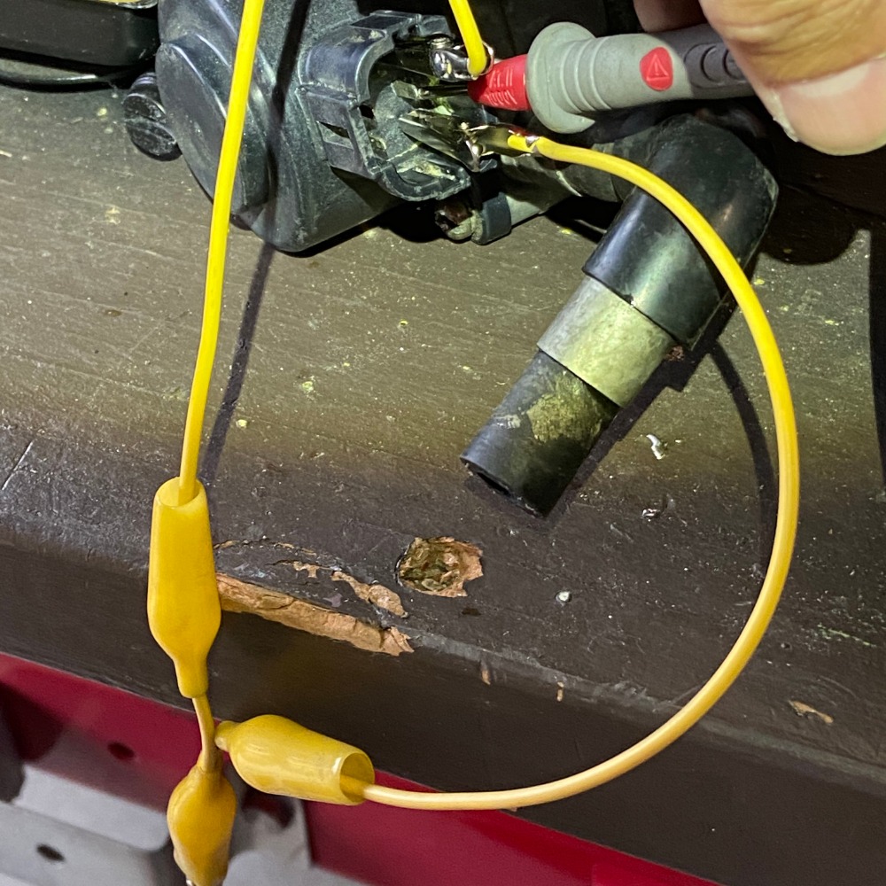

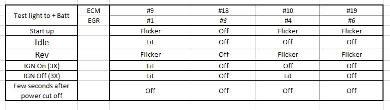

So, while the engine is idling, I disconnected the EGR plug and using test light connected at positive battery, I got Terminal # 9 lit up green and the 10,18, and 19 only dimly lit.
and now in the video you have terminal #18 with no light anymore. Is this because you had the engine idling as opposed to cycling the key on and off? Reproduce this to confirm.
( To anyone else following along terminal 18 is the ecm connector. In the video when Genes1s says 3, that's at the egr connector. It's the same wire. )
My thinking is leading me toward heat being an issue here. Can you get the car nice and hot and check the resistance of the circuit. You have a very nice setup there with the EGR connector backprobed light that. I'm thinking if can hook up the DVOM to the correct load side of the relay, you can do a resistance check with the EGR valve hot.

So as far as # 3/#18 terminal, it is all flat lined both at cycles and idles.
Here is the summary. The steps are in sequence. Engine cold, IGN on, Engine Start, Idle, Revs, Engine off, Ign/on/off, key removed. See video also.

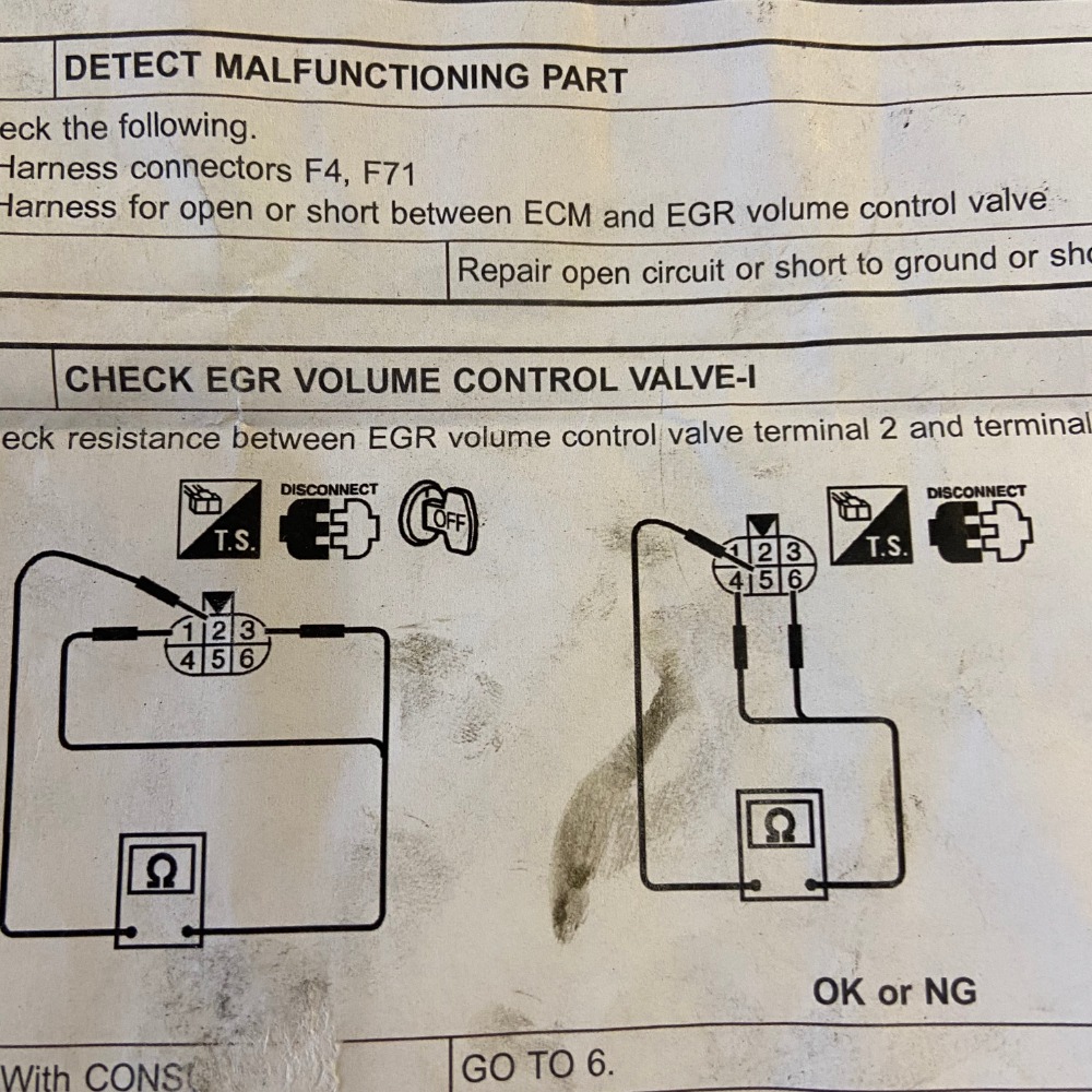

I would need to isolate the harness from the ECM and EGR to confirm short to ground at harness or ECM, or open EGR coil. When I tested the EGR resistance, it is too spec (at cold).
Perhaps you're on to something about the heat. I really wish I have 4 ch scope, I can just run wires inside the car and have it live.

Replied by jreardon on topic P0400 due to Faulty ECM?
Okay this makes sense now. It's obvious the driver in the ECM is bad (no ground provided by driver). What killed it though? I think testing resistance of EGR when it's hot is only way to confirm. Or swap #3 control wire with a working control wire (harness circumcision required) or re-pinning at the harness connector, to see if good driver gets cooked. It's also clear the EGR coil is open since you're not reading battery voltage at the control wire.

I can confirm these again but there is no open coil condition since the EGR unit was working fine when plugged in the IACV connector ( I could see the shaft/solenoid movement at start up) and the resistance is within spec. Also I had disconnected the EGR hardness from the EGR and ECM and the harness has no short to ground and no open. I checked short to ground using test light. I checked open circuit using DVOM connectivity function.

Assuming you have good contact on the #3 control wire, one thing is absolutely certain from your videos, #3 control wire does not get grounded because your light never lights on that wire. I am assuming this is an abnormal condition because the other control wires do get grounded. If the control wire doesn't get grounded it must have battery voltage on it. In your videos your multi-meter showed 0 volts on that wire. That means the #3 coil inside the EGR valve is open.
I believe what happened is the coil got shorted first, cooked the driver, and now the coil is open but only opens when it gets hot. That's the only way I can explain why it's working in the IACV harness. Mr. Danner says in his videos on ohm testing, something like, "if it ohms good it can still be bad, if it ohms bad, then it's bad." It's the only way I can reconcile those two facts. It's either that, or that control wire got shorted to power somehow. The driver doesn't die for no reason.
I would check for driver functionality backprobing at the PCM, just to double check. Redo the tests you did at the EGR valve but focus on just that one wire at the PCM since we know the problem is there.

It has been 160 miles since I reset the CEL and did that testing. The CEL has not been on since then and when I did the same test on #3, I got signals just like the # 6. It was flickering at start up and revs and off at idles and on/off cycles.
This is super weird. I didn’t do anything else other than adding those jumper wires and resetting the CEL. Usually the CEL came back on after 80-90 miles, but this is almost double the miles and it hasn’t came back and I got signals on a terminal that was flat lined before...

When I compared the resistamce value between new and old, they were all identical and to spec. So, pretty sure old EGR is all good.
How do I energize the stepper? I have computer power supply that I can use to supply 12 and 5 volt. Doing in the car with ignition on and off doesn't do anything unlike the IACV motor which I can tell it cycles during ignition on.
