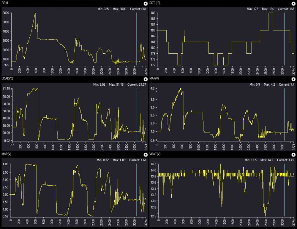

Monitoring PIDs with my Encore, the TB and APP are operating properly according to the info that I have. MAF, MAP, IAT, ECT, O2's, all check out okay. I've checked for intake/exhaust restrictions, vacuum leaks, connections, grounds, fuses, relays, etc,.
Things that stand out that I've used for direction:
1) Engine Load PID shows ~35% at idle! Here, I'm expecting closer to ~18%. When I am able to get the revs up, the Engine Load climbs to +50%.
2) MAF g/s show to be 4.2g/s when I'm expecting closer to 2.5g/s.
3) Using Global OBD the up and downstream O2 performance is normal. O2's are new with the swap. (Using the factory module on the Encore, the O2's do not show up as active.)
4) Fuel trims show the ST at ~0 and LT on the high side at -20. This does not surprise me though given use of the 2.5 injectors. Fuel system is in closed loop shortly after a warm up and engine reaches operating temp normally.

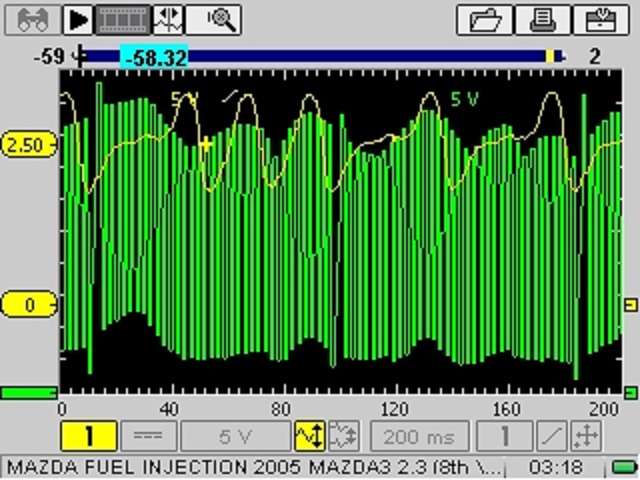

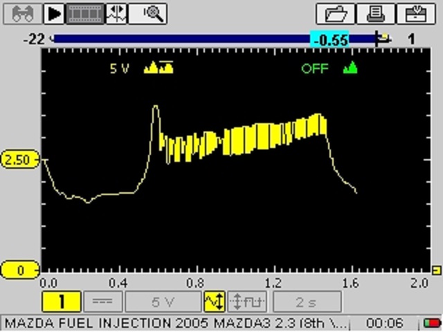

1) Sensor related issues such as MAF/IAT and MAP. Looking at the MAF signal with the Vantage I get the expected spike with a throttle snap but then the signal flat lines. However the MAF checks out good.
2) The O2's. Everything checks out good. With a throttle snap or some pedal pumping, the upstream goes rich and then lean after decel. Downstream acts accordingly. During idle, upstream and downstream appear normal and within the expected range.
3) TB & APP systems. TB responds to APP inputs. APP fails according to a Vantage component check in the following respect; Measuring duty cycle and voltage per the Vantage at the pedal I see that the duty cycle stays at zero till the voltage gets to a minimum of .8v and then goes right to 50% duty cycle. Continuing, as the voltage climbs the duty cycle hits 100%. Closing the throttle, the duty cycle drops off at 50% right to 0% right after dropping below the .8v point. Swapping the APP sensor gives no change. APP voltage levels measured at the ECM are in spec. Otherwise, I can't find any faults.

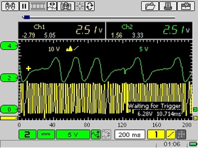

I have an OTC Encore that I've been using. When I use it in the enhanced Mazda mode, the O2 sensors do not show up as being active at all. If I switch over to generic OBD the O2's show up as functioning normally. I'm not sure what this means, however, the more I think about what this problem could be, the more I think that O2's could be a big part of it. Along those same lines, the enhanced data shows the system in closed loop but generic OBD shows the system in open loop. Based on performance, generic looks like it's correct here. But, since the upstream O2 is functioning and ST is active, that can not be correct! ugh.
Both O2's are new since I also put in a new cat. Today, I'm spending some time looking at them more closely.
Update: Upstream O2 is functioning normally. Signal at ECM is present and looking good. Using the Vantage, I monitored the upstream O2 and an injector. Watching both while enriching the mixture (brake clean) the injector pulse width decreases and O2 voltage increases. All seems to be working well here.

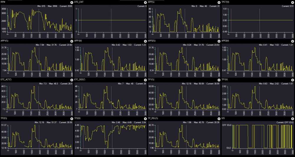

9 years 10 months ago - 9 years 10 months ago #4438 by Tyler
Replied by Tyler on topic 2005 Mazda 3S - Throttle Response Problem
Hey John! Welcome to the forums! Always love to see members posting up their test results, makes everything easier :cheer:
My first thought is to stay with the throttle and the lack of response. I see that you've already tried swapping the throttle body from the 2.3L onto the 2.5L intake manifold, good move! I'm really interested in how the ECM's command of the throttle motor behaved:
I'd be interested to know how the throttle butterfly itself behaves while stepping on the APP, key on engine off. If the same hesitation can be observed in the butterfly movement, then I'd say we stay with an electronic throttle issue, and move away from other inputs. If the butterfly responds normally with the engine off, but misbehaves with the engine running, then let's go towards another input.
I'm looking at the Troubleshooter, and this APP sensor is weird :blink: APP1 really IS a duty cycle signal, while APP2 is a conventional potentiometer. WTF Mazda? From the Troubleshooter:
KOEO, with throttle fully closed
APP #1 Duty should be 8%
APP #2 voltage should be 1.0 VDC
Just based on this, it kinda sounds like both are misbehaving at closed throttle, as the APP2 signal isn't high enough, and APP1 should be showing a duty cycle off zero :unsure:
I dug up some scan data off another '05 Mazda 3 with a 2.3L (not sure if it's a VIN 3) that had a dirty throttle body. I didn't look at the APP sensor directly, but I did end up with some decent captures of scan data at idle and on a test drive. It's somewhat confusing, since the data shows an APP1 voltage, but your scope testing shows that it's NOT a potentiometer signal... Maybe an interpreted value? Anyway, the 8% at idle figure from the Troubleshooter holds up:
www.scanshare.io/share/dKswIboQmkW-wRdKxESnnA
www.scanshare.io/share/5iXHgKNHq0ut-JBkq5RXZQ
To view the ScanShare PIDs, just hit "View PIDs" on the upper toolbar.
If possible, compare this data to what you see on your Encore, see if there are any glaring differences. The IVS PID would be especially interesting. I believe it stands for Idle Validation Switch, and I think it's a calculated PID based on other inputs, not an physical switch.
Sorry it took us so long to get back to you, hoping this helps! Let us know how the KOEO throttle test and the scan data looks, and we can go from there.

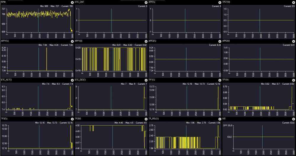

9 years 10 months ago - 9 years 10 months ago #4451 by jcascel1
Replied by jcascel1 on topic 2005 Mazda 3S - Throttle Response Problem
Hey Tyler,
Happy Holidays to you and yours! Thanks for the response, given the holidays, I’m happy to hear from someone this soon. Yes, if for no other reason than the moral support this sure helps!

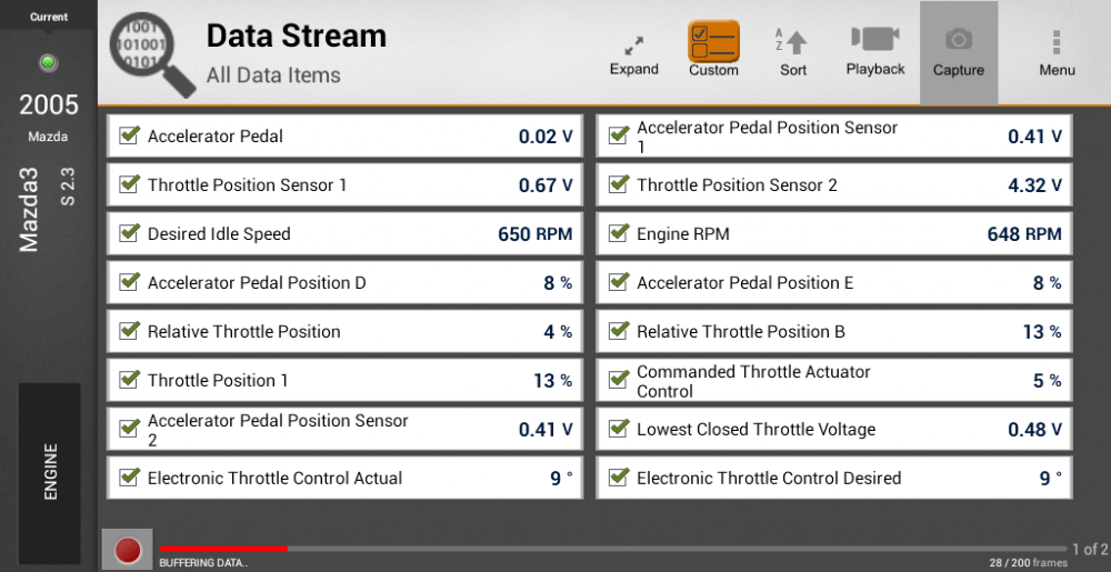

“I see that you've already tried swapping the throttle body from the 2.3L onto the 2.5L intake manifold, good move!”
The 2.3 TB has been on the entire time. I’ve never used the 2.5 TB. I did swap the 2.3 since I had a spare. No change in throttle response however.
“I'd be interested to know how the throttle butterfly itself behaves while stepping on the APP, key on engine off. If the same hesitation can be observed in the butterfly movement, then I'd say we stay with an electronic throttle issue, and move away from other inputs. If the butterfly responds normally with the engine off, but misbehaves with the engine running, then let's go towards another input.”
KOEO, the throttle butterfly responds to the APP perfectly. Even the slightest application of APP moves the butterfly. Fully closed to WOT looks good.
“I'm looking at the Troubleshooter, and this APP sensor is weird APP1 really IS a duty cycle signal, while APP2 is a conventional potentiometer. WTF Mazda? From the Troubleshooter:
APP #2 voltage should be 1.0 VDC”
Recalling my checks with the Vantage at the APP, I saw:
APP1 throttle closed = ~0%
APP2 throttle closed = ~0vdc
APP1 WOT = ~100%
APP2 WOT = ~4.5vdc
During this test, pressing down on the APP shows the voltage at APP1 increasing steadily with APP2 showing 0% until the APP1 voltage hits .8v at which point APP2 jumps to 50% and then they climb together to ~100%. Slowly closing the throttle shows the voltage slowly decreasing but the APP2 % remains high at ~95% till the magic .8v point and then % drops off to zero. However, this is not what is seen KOEO when looking at the TB butterfly! There is no dead spot and butterfly movement is right on and linear with pedal position.

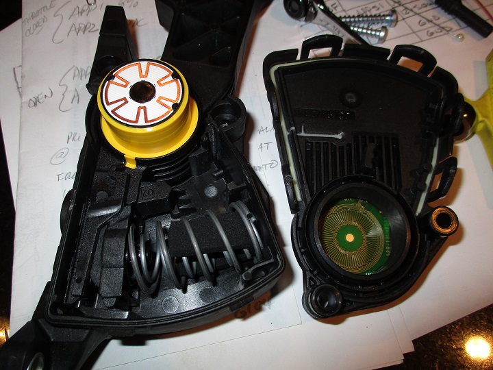

I have swapped the APP and performance is the same. I’m not sure what the SO troubleshooter is getting at but I’m not trusting it based on what I’ve seen so far.
“If possible, compare this data to what you see on your Encore, see if there are any glaring differences. The IVS PID would be especially interesting. I believe it stands for Idle Validation Switch, and I think it's a calculated PID based on other inputs, not an physical switch”

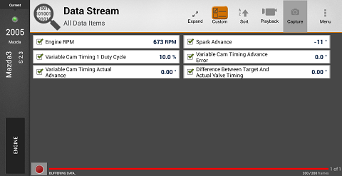

I didn’t see any major differences, EXCEPT with the IVS. Monitoring the IVS, (Idle Valid Switch) engine at idle, the PID shows OFF. The slightest touch of the gas pedal and the switch toggles to ON. Release the pedal and it goes OFF again. This is totally repeatable. In the photo below, the IVS PID is missing however my foot is off the gas and it shows as being OFF.
Disregard the earlier coil image. Clearly I obtained it incorrectly. Sorry.

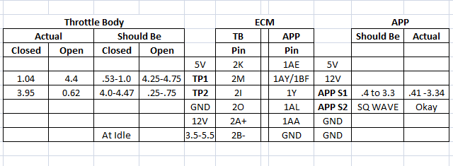

Tyler, I found my notes from the Vantage Pro's APP check. Disregard my earlier info above. Very, sorry for the confusion.
I'm apologizing in advance for my rather scatterbrained posts. Been at this 2 weeks now and it's becoming a bit of a jumble at times.
This was the data that I gathered when I discovered that at .8vdc the duty cycle jumps from 0% to ~50%.
KOEO. Measured at the APP.
Throttle Closed:
APP1 - Should be 8% Actual 0.0%
APP2 - Should be 1.0vdc Actual .31vdc
Throttle Open:
APP1 - Should be ~66.5% Actual 99.7%
APP2 - Should be 3.3vdc Actual 1.93vdc
Below are my TB and APP checks at the ECM. 5 & 12vdc were good. APP square wave was present, levels good, and no dropouts detected.

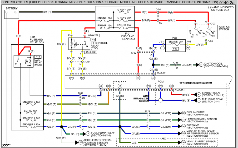

During my troubleshooting I saw that Mazda employed an Electronic Throttle Control relay. Per the FSM control system guide:
At the ECM:
Pin 1AY should have B+ with key off. However, it measures 0v. I verified this at the relay terminal.
Pin 1BF should have B+ with key on. This measures okay with battery voltage. I also verified this at the relay terminal.
At the ETC relay:
Load side has B+ on one terminal at all times.
Control side has B+ with the key on only.
I don't have the experience or circuit design knowledge to know the exact role of this relay in the circuit. So, I have not been able to understand the impact of the missing B+ at 1AY with the key off.
Thanks,
John
9 years 10 months ago #4512 by Tyler
jcascel1 wrote: Tyler,
At the ECM:
At the ETC relay:
From what I can tell, it seems like you did a great job testing this relay circuit! B)
Really, seeing 12V at pin 1BF alone tells you that the relay circuit is working. Seeing the throttle blade open and close fully backs this up, too. What I don't understand is why they told you to check for 12V at pin 1AY with the key OFF :blink: The power for the control side of the relay comes from a fuse fed by the Main Relay, so there's no reason to expect 12V at that pin with the key off... Confusing flow chart is confusing :angry:
Whatever, I'm happy with the results you posted. My understanding here is that the PCM is controlling the power feed into the PCM, that ends up going back out of the PCM to the throttle actuator. Perhaps there are times that the PCM will want to shut off power to the throttle for safety reasons?
Good stuff right here. This by itself pretty much clears the APP/TAC system for me. There's DEFINITELY more to this APP signal than I understand, but I really don't believe that the throttle would work this well if there was an input problem. The behavior of the IVS data PID backs this up, too.
I guess my last thought on this would be if the throttle continues to play nice during that first 1/3 of APP travel, during the lack of engine response, with the engine running this time. If the throttle works well KOEO, but not KOER, then we can figure out what changes in between to cause the problem.
If the throttle still works corrected KOER, then I'm kinda wondering about some kind of engine breathing problem? We might start with a simple vacuum gauge reading if we go down that path. I see that the 2.5L intake is installed - there's no kind of manifold runner actuator, swirl control, or anything like that? I don't see it on the 2011 Fusion diagram, but that doesn't mean it isn't there.
No worries about being scatterbrained over this one, that's how troubleshooting goes sometimes! :lol:
I can't tell you how glad I am to hear you say that. I thought I was going crazy as I tried to work that one out in my head.
Took a junk yard APP apart just to verify if it has a switch internal or external. The answer is no switches of any kind that I can see inside or out.

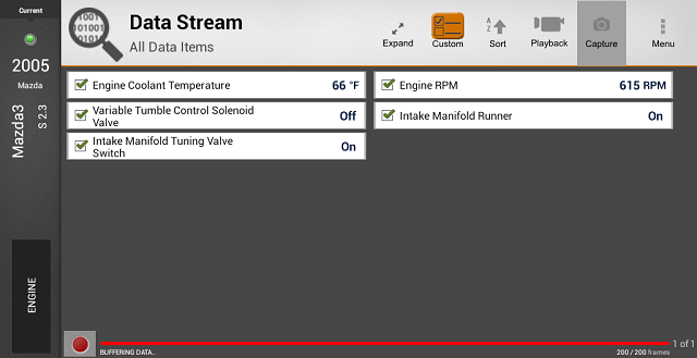

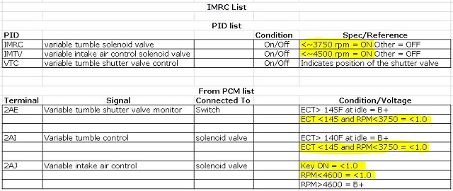

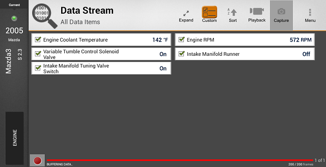

“I see that the 2.5L intake is installed - there's no kind of manifold runner actuator, swirl control, or anything like that? I don't see it on the 2011 Fusion diagram, but that doesn't mean it isn't there.”
No IMRC’s or gadgets on the 2.5L intake. The 2.3L had 2 IMRC’s; Variable Tumble and Variable Intake Air (two solenoids/two actuators. One actuator has a position switch (variable tumble shutter valve switch.) Per other 2.5L swappers, the 2.3L solenoids are still connected to the harness. The one actuator that has a switch on it is also connected to both the harness and a vacuum supply (actuator arm moves freely so ECM think it’s working.) By doing this, there are no related CEL’s.
During startup, the connected actuator retracts under vacuum. As engine warms I see that the arm moves to the released position. Status PID changes accordingly.
Terminology is confusing on the PIDs and scan tool descriptions. Per the list below, at warmup, actuator position should change. ON during warm up and low RPM and then OFF after temp goes above 145F. Have not checked signals at ECM yet. The tuning valve switch PID does not change. Don’t know why right now. Either way, there isn't anything in the manifold to cause problems! Plus, FWIW, other 2.5L swappers report no issues with this setup.

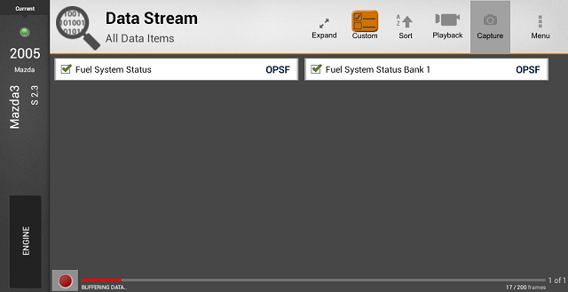

As I was playing around today, I saw that the fuel system status showed OPSF with engine fully warmed up. Any idea what that stands for? Open System Fault maybe?
Picking up a vacuum gage tomorrow in case we decide to look into it. Also, working on a video for you to watch so you can see/hear this thing for yourself. Who knows, it might help. lol Thanks!
Clever! OK thanks for answering this one. I knew that Mazda loved their intake tuning valves, but wasn't sure if the 2.5L had anything similar.
I've never seen that PID before, but that sounds like a good guess to me! Unfortunately, all the Mazda 3 captures I have don't show loop status :( But, you did mention previously that the long term trims were at -20%, and the short terms were near zero. If the short term trims were switching at that time, then it IS going into closed loop operation at some point.
Disregard that. Looks like that was due to my attempts to run the engine with the intake snorkel mostly disconnected to check TB butterfly response.

Below, a rather depressing Vantage capture of the MAF during a WOT blip:
Thanks,
John
Last edit: 9 years 10 months ago by jcascel1. Reason: Corrected mistakes.

9 years 10 months ago #4583 by jcascel1
I don't see anything wrong here. Although, I don't know what the allowable amount of error is.
Thanks,
John

Also, I love that MAF capture! You can totally see how the engine is struggling to gain speed the entire time. All the noise in the trace after the throttle first opened suggests that the airflow is 'stacking up' in the intake, and not flowing smoothly as it should. I mean, we kinda knew that already, but it's still a cool visual. B)

9 years 10 months ago - 9 years 10 months ago #4604 by jcascel1
I was going to ask you about timing, but then I saw that the correct tools were used! I gotta say, I've heard of other Ford engines of this design with timing issues, and they also had poor idle and glowing catalyst symptoms :unsure: The trouble is that, on this design, only the intake camshaft is monitored by the ECM. It's possible that the exhaust cam is out of time, and the PCM won't know it. Unlikely, since it sounds like the timing was set up correctly, but possible.

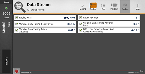

I looked over the timing again today. I did not put the pin through the block to check crank position since I just wasn’t in the mood to pull the axle. Granted that is not satisfactory but that said, everything looked good.
Pulley alignment bolt through the pulley and into the timing cover.
9th tooth of the crank timing wheel aligned with center of CKP sensor.
Intake/Exhaust lobes near gears pointing towards each other.
Timing tool in place at the end of both cams.
VVT notches aligned even after multiple engine rotations.
Chain tension good but there was one spot where it was just a tad looser.
There is one thing I need to verify regarding setting the timing. My guess is that only a Mazda/Ford tech can answer the question. It has to do with the crankshaft position relative to the timing pin that goes through the block. One side of the cylinder 1 crank weight has a depression in it and the other is flat. I can’t recall if one side is BDC and the other is TDC (does that even make sense?) We used the depression side. Guessing though that the thing just flat out wouldn’t run if it was indeed BDC. Probably thinking wrong but I sure would like to hear someone who knows for sure verify it for my own peace of mind!
How sensitive are these things to timing? Who knows, but the keyless crank sure doesn’t help to inspire any confidence. What a despicable design.
I did a sloppy Vantage grade cam/crank correlation and compared it to my other 2.3. Looked good but I don’t have Pico grade tools with which to compare them. First pic is known good and second is my 2.5.
I'm still wondering about the EGR valve being stuck open, as this would definitely cause idle problems, hesitation, and skewed fuel trims. How much work is it to get to the EGR?
Very easy. Just took the cover (solenoid) off and pressed on the valve by hand. Ran poorly like always with the cover off. Pressing down (opening) on the valve killed the engine instantly. Even the slightest opening of the valve had an effect. Valve moved freely.
I like to call it, Volumetric Deficiency! Would Paul be proud of me? Probably not! Lol
Timing,/intake/exhaust: Thoughts...
Timing according to PID’s, cam/crank correlation, and visual inspection looks good (pending crank weight verification.)
Intake could use more scrutiny for a gigantic vacuum leak that I somehow can’t hear or see! Finally, there is the PCV valve but boy that is a long shot especially since this engine is in such good shape. Reading indicated that very erratic vacuum gage readings could be PCV related. A stretch though.
Brand new cat and exhaust remains questionable but not a show stopper.
So, what’s next? Tomorrow I guess I’ll pull the intake off and just have a look. Also need to go back and revisit using the 2.3 injectors per my comments with Noah.
Thanks,
John
Last edit: 9 years 10 months ago by jcascel1. Reason: Added notes on the pics.
TRUTH. This setup is just asking for problems. I do know that these are very sensitive to timing issues, but I don't see any indication of a problem so far. Everything you've noted looks good.
I don't know for certain about the timing pin in relation to the crank weight, I can do some research on that tomorrow. I suppose, if you wanted to, you could use a long screwdriver/extention/whatever in the #1 plug hole to verify where the piston is when the marks line up?
No worries about the Pico, these are good captures. It looks to me like the lowest valley of an individual CMP pulse lines up with the very last tooth on the CKP before the sync notch in both captures. I compared this to a known good on iATN, and it agrees with yours.
Swing and a miss for me :( Thanks for checking that one, anyway! Side note, I didn't know you could operate these manually. Good to know for the future.
:lol: :lol: :lol: :lol: I dunno if Paul would be proud, but I like it!
So, with this (horrible) timing design, it's possible to have the cams line up with each other, have the cam and crank tone wheels line up with each other, and still have the crankshaft out of time, correct? This would possibly result with the pistons being out of time with the cam events, and still not detectable by the PCM. Am I understanding this correctly? :huh:
One thing nobody has commented on is in my very first post. The engine load at idle shows to be ~35%! Throttle blips move it to almost 50%. Isn't this noteworthy in some way? Sensors are working properly. Mazda FSM states that at idle it should be ~18%.
Wow, 18%? That's way lower than I usually see on import engines. Anyway, I didn't initially speculate on that since I regularly see idle Engine Load above 30% on known good vehicles. This seems counterintuitive, but it's how they run :blink:
But, I think the MAP sensor may possibly explain the 35% reading? This system has both a MAP and MAF sensor, and we know already that the engine runs the same way without the MAF. With the engine showing 9" inHg at idle, the MAP is reading the same, and relaying this to the PCM. Lower vacuum means more load, which is probably driving the Engine Load reading up. This may also account for the skewed MAF g/s reading, if that PID is calculated between the MAF and MAP readings.
I was digging some more, and I see that this thing has a MAP and a BARO sensor? Where's the BARO sensor, physically? I'm guessing the MAP sensors is on the intake, correct me if I'm wrong. Also, I see that the MAP sensor has four wires? :blink: Strange and more strange, Mazda.
Just for curiosity, I dug up some data off the same Mazda 3 I posted earlier. Indeed, the idle Engine Load is lower:
What I wish I had was some captures with the BARO PID in them. :angry: No offense meant, but I'm wondering if there's a way for the BARO to be hooked up incorrectly, confusing the PCM.

Regarding timing. The Fusion engine intake cam has a tone ring (timing gear) on the intake cam that has 6 teeth on it. The Mazda 2.3 intake cam has a tone ring that has 5 teeth on it. This was true for the 2004 and 2005 models and Mazda changed it to the 6 tooth design in 2006. So, I pulled the 5 tooth ring of f of my 2.3 intake cam and pressed it on the Fusion 2.5 intake cam. R&R was done by auto enthusiast machinist and I’m totally satisfied with the alignment/position of the ring on the 2.5 intake cam. Plus, no cam codes. Just mentioning this for full disclosure. Anyway, nothing points to a problem in this area.
Yes, it’s a BARO, MAP, and MAF system. Yes, four wires. BARO is external and right next to the MAF by the air box. Regarding the elevated load, I suspected MAP, MAF, BARO too. Like you, I initially suspected the MAP as the culprit for the load problem. Originally, I used the 2.3 MAP. Although it Vantage tested good, I got curious and tried the 2.5 MAP. No change. I believe that they are the same part number anyway. MAP and BARO readings generally agree from viewing PID’s.
Just for curiosity, I dug up some data off the same Mazda 3 I posted earlier. Indeed, the idle Engine Load is lower: What I wish I had was some captures with the BARO PID in them. :angry: No offense meant, but I'm wondering if there's a way for the BARO to be hooked up incorrectly, confusing the PCM.
Connector looks good. No other wiring changes. Again, BARO PID looks normal. Generally matches MAP reading. I have a spare BARO sensor. Have not tried to swap it out as I saw no reason to.
Ah, good to know! I think you're right, though, I see no reason to suspect a problem here. If there were, then the cam/crank correlation would be off, or the cam timing bar wouldn't have lined up. The issue with the crank being out of time is still possible, but I don't know that I want you to pull the axle without more evidence to justify it.
