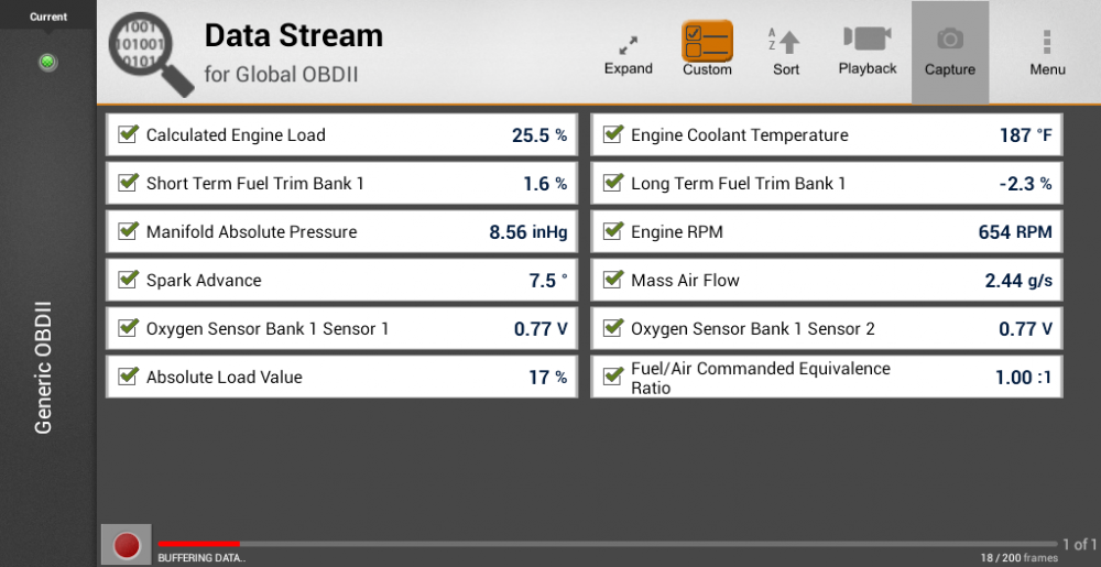

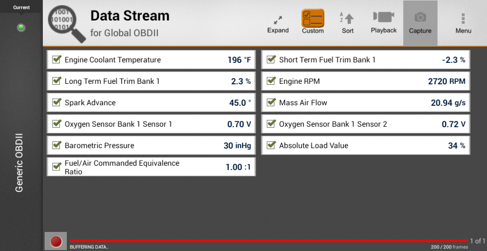

Good news guys. The crank pulley timing is complete and the engine is running perfectly! What a huge difference. Once I timed it and then put things back together, it started and ran perfectly and I was immediately able to take it for a drive. All PID"s are normal and there are absolutely no problems to report. :)
I videoed the entire timing process. I had hoped for it to be a tutorial however it ended up just being me talking to myself as I worked my way through the process. It's torture to watch so I probably won't post it here although it will be on my YT channel in case it might help someone. At the 10 minute mark I took a look, pre-adjustment, at the cam timing relative to TDC since someone here was curious as to what it looked like. If you want to spare yourself the torture of listening to me babble to myself, you can skip to the last clip in the video to see the rather successful outcome of the timing process. BTW, engine vacuum now measures 21inHg.
Configuration is:
2011 Ford Fusion 2.5 long block.
2.5 intake manifold
2.3 injectors
2.3 TB
2.5 to 2.3 intake to TB adapter
2.5 coils
2.5 egr valve
2.5 OCV
5 spoke intake camshaft timing wheel off of the 2.3 transferred over to the 2.5 intake camshaft
Below are some PID's at idle and tooling along at around 55 mph.
Thank you ALL so very much for your help and encouragement. I consider my interaction with you guys one of the most satisfying parts of this entire experience.
Thanks,
John
Last edit: 9 years 9 months ago by jcascel1. Reason: Added vacuum and configuration info.

Sweet! :woohoo: VERY happy to hear that this one worked out, sir.
The vacuum reading and the scan data look excellent. Those fuel trims are tough to beat B) I really like that the Engine Load is much closer to the 2.3L data I posted earlier. Also, I hadn't noticed the Calculated AND Absolute Load PIDs on the Global side... :huh: Gotta look that up. Wondering how/why they calculate them differently.
Couple conclusions I drew from this, for my own purposes, up for debate:
1.) No TAC codes, no problem. I really hate broad generalizations like this, but I've never seen a TAC problem that didn't have associated codes, and this Mazda just reinforced that trend. The only exception I can think of would be dirty throttle plates. Really, the only reason I went down that path in this case was due to the engine swap. But overall, I say that if there's no codes, then the throttle is doing what it's told to do.
2.) No P0340? Skip the cam/crank. All the research I did on this 2.3L (iATN, Mitchell, ect.) said that, if the tone wheels were out of time, then you'd get a P0340 code almost immediately. The tone wheels were lined up in this case, so the PCM was happy. For me, the short answer is if there's no P0340, then the tone wheels are lined up. Period. That doesn't mean that the engine is mechanically timed correctly, it just means that I know to skip the cam/crank and go directly to another test.
Seriously, congratulations on making this swap work! :cheer: None of this was easy. On the bright side, most other timing belt/chain jobs are gonna look like cakework after this :lol:

Tyler:
“Those fuel trims are tough to beat B) I really like that the Engine Load is much closer to the 2.3L data I posted earlier. Also, I hadn't noticed the Calculated AND Absolute Load PIDs on the Global side... :huh: Gotta look that up. Wondering how/why they calculate them differently.”
I know, ST/LT trims = ~0% with this mishmash setup - holy hell! I surely wasn’t expecting that. Otherwise, other PID’s are to spec including engine load at ~18%. I’d be interested in knowing how/why load is calculated differently as well.

I'll be honest, I have an in-cylinder transducer, and I'm still not great at spotting timing problems with it. :unsure: I have a '12 Equinox with an intake cam out of time at the shop, was gonna experiment with it tomorrow before disassembly.
Well, I’m conflicted about it given the current ~0% LT/FT trims. Could it be any better? This wasn’t a performance build I’m embarrassed to admit. I’m impressed by the Mazda PCM’s ability to adjust to this mishmash setup. Naturally, I’m curious and might give the 2.5 injectors a try since the PCM might be able to optimize them as well.
Same, I'm VERY impressed with how well this worked out. I initially thought the higher displacement would screw everything up, but I think the PCM just accounts for it with a higher MAF reading.
I don't know that the 2.5L injectors would make much of a difference? 'Cause the PCM is gonna see the extra fuel the bigger injectors provide, and just trim it back out. Right? :huh: :lol:

Double check me here, but I believe that the ACTUAL crankshaft is advanced of the balancer (TDC #1 happens before the ninth tooth on the balancer), and therefore advanced compared to the camshafts.
I've been thinking about this and must confess that I can't say. Well wait, yes, maybe I can. With #1 at TDC the actual crankshaft is advanced of the balancer by two teeth, so 20 degrees advanced of the camshafts. TDC happens at the 7th tooth. (See video just posted.)
But the MAF at idle is the same, ~2.4g/s.
Well, we saw at idle, pre timing fix, that the LTFT was -20%. STFT was around 0%. So, yeah that's what I'm thinking too, PCM will just trim it out. Wondering now though, what difference there would be with proper timing and efficient combustion? Hmmm.
