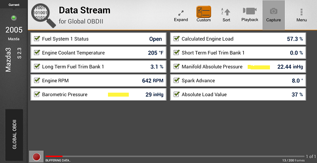

Checked this just a few minutes ago. Yes, BARO here correctly reads 29inHg at all times. MAP changes. Cold engine, KOEO, MAP reads 29.53inHg. Idling warm, MAP reads ~22inHg.

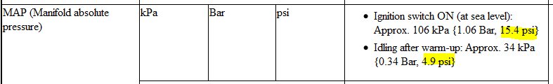

Mitchell online service manual states:
MAP should read – KO 15.4psi / Idle 4.9psi.
MAP actually reads – KO (29.53inHg ) 14.5psi / Idle (22.4inHg) 11.0psi!
I thought that a measure of the correct operation of the MAP is that it matches the BARO cold engine off. I used that as one of my checks but missed this difference at idle.

Screenshot showing BARO vs MAP warmed up at idle. Also shows drastically improved fuel trims with 2.3L injectors.

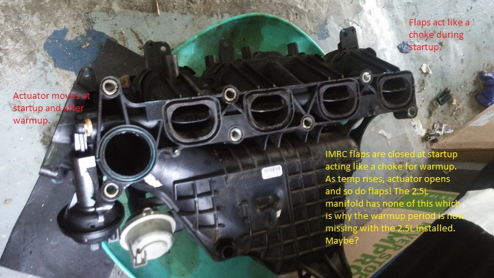

But, I think the MAP sensor may possibly explain the 35% reading? This system has both a MAP and MAF sensor, and we know already that the engine runs the same way without the MAF. With the engine showing 9" inHg at idle, the MAP is reading the same, and relaying this to the PCM. Lower vacuum means more load, which is probably driving the Engine Load reading up. This may also account for the skewed MAF g/s reading, if that PID is calculated between the MAF and MAP readings.
Just speculating here based on your excellent observations. Way out of my league but worth a try. LOL
So, on one hand, I’m wondering if the flow dynamics of the 2.5L intake are so different that it impacts the MAP/MAF reading enough to double it? Although Mazda’s IMRC system only seems to operate briefly at startup and high rpm’s, overall the flow might be much different.
On the other hand, given that the IMRC operates at startup (recall me mentioning that the IMRC actuator withdraws under vacuum moving the flaps at startup until the engine warms) this in effect acts like a choke. The Mazda PCM might expect very different inputs even though I still have the actuator/solenoid connected. It works, but the PCM still isn't seeing other inputs that it expects relative to flows. That is to say, slowing the air flow down.
This might explain a problem that is new with the 2.5L installed. The startup/warmup routine is missing. By this I mean that the 2.5L does not seem to recognize that the engine is cold. At cold start the rpms go to around 1000 for a second or two then just drop and the engine is left at sub idle till it struggles through the warmup period. The 2.3L PCM is counting on the flaps at startup (choke effect) but they aren't there to slow or affect air flow.
This IMRC effect is totally missing on the 2.5L manifold.This startup routine may be accounted for by the Fusion 2.5L PCM's open loop strategy since they wisely have no IMRC flaps to rely on! The Mazda 2.3L PCM doesn't know what to do without the flap system and the different air flow dynamics.
Hmmm, could the 2.3L intake be the key?
Thanks,
John
Last edit: 9 years 10 months ago by jcascel1. Reason: Added more speculation...

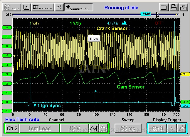

I compared this to a known good on iATN, and it agrees with yours.
Thanks very much for taking the time to do that! It's a great relief to know it's good.

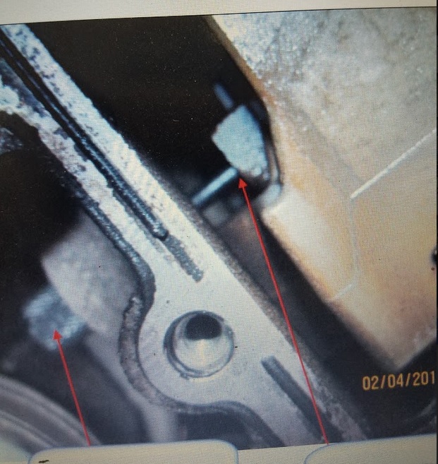

FWIW, I'm calling the timing tool manufacturer tomorrow to ask about the notch in the 2.5 crank weight. Although my correlation waveform checks out good, I'm curious about that notch and what it's for. Might help to know.
Uhm, no luck. He said, "no, the sides of the weight should be flat. Never seen a mark of any kind on the weights. Sounds like a spot where they may have done some balancing work. You know, like the mark that a drill bit would make?"
God damn it, NO! And it just happens to line up absolutely perfectly with the timing peg when it's installed in the side of the block and the number one piston just happens to be at TDC! No friggin' way!
The mystery notch. This swap just keeps surprising. Ugh.

BTW, if you still care to take a shot at ignition waveforms, we'd be happy to help you make sense of them. Your Vantage Pro should handle primary voltage waveforms perfectly.

jcascel1 wrote: Uhm, no luck. He said, "no, the sides of the weight should be flat. Never seen a mark of any kind on the weights. Sounds like a spot where they may have done some balancing work. You know, like the mark that a drill bit would make?"

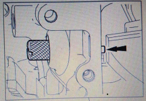

I found a decent picture of the way this weight is supposed to look, while reading about timing setup on a 2.5L. I find it tomorrow and post it here.
  • jcascel1
Nice find. I couldn't find one at all today.That Mazda timing document you shared was amazing. However, nowhere in it does it mention the tensioner or a single thing about eliminating chain slack between the gears before putting the timing cover back on! Kind of shocked me as a diyer but probably is a no brainer for a pro.
Definitely at some point. It would be great to have some backup on interpretation. I'm not convinced that the single cylinder ignition setting on the Vantage is best to use. Confusion here is that the FSM states to set the scope up at 10v/div and expecting around 40vdc. Really!? The Vantage setting sets the scope to 50kv/div. That's why I think I got those crazy waveforms earlier. Maybe not? So, scope on DCV, one lead to coil, other lead to battery ground. Unless you can recommend a better Vantage option?
Ah yeah, I understand your confusion here! I think the Mazda material is talking about scoping the primary ignition waveform, while the single cylinder ignition preset on the Vantage is for a secondary ignition trace. The Vantage preset is actually just a converted voltage scale, probably around 5V or so. That's why your waveforms never look good.
Your lead connections are perfect. Just turn the DCV scale up to around 100V total (or 10V/div, whatever) and trigger as needed. The 100V is a good starting point, and may require fine tuning depending on the height of the inductive spike.
So, I got some phone pictures of the crank weight, hopefully they make sense:
It looks to me like both show the crank weight machined down so it'll come up flat against the timing pin. If your crank has been drilled into, then WTF?

Yes, I'm familiar with that. There is a video on YT which actually gives a very nice view of the timing peg/crank weight relationship. The guy has a 2.3 with the timing cover and (i think) oil pan removed. Thanks for the photos.
Uhm, yeah, I think WTF sums this swap up rather well. Never did I imagine that this would be happening. I was being so careful and, I thought, thorough.
I did not set the timing on this engine. I went out of my way to pay someone, who has done it before, to come and do it for me. It was worth it for me to let some one else do it in order to avoid problems. I watched the guy do it. He insisted on using an impact to tighten the crank bolt. He insisted that the impact would tighten the bolt to even higher torque than the recommended manual method. Hell, he even left the timing tools in place when he tightened the bolt! Compounding the issue, the plugs that came with the engine were frozen in place. The carbon must have solidified over time as the engine sat. I tried to get them out to no avail. They cam out instantly once the engine ran for a bit however. Point is that I was not able to pull a plug to verify TDC after timing was set. Although I think he got it right it would have been nice to have seen TDC and all the other timing clues.
So, my theory is that he did not tighten the bolt enough with the impact. I never did feel good about it. The timing must have changed at first startup. FML
My timing check video is almost uploaded. I'll post it here shortly thereafter. You guys can watch it and hopefully tell me that I am mistaken and the timing is actually fine. After, you fail to tell me that, I'll give you my final thoughts on the 2.5L keyless crankshaft engines and how utterly useless a cam crank correlation is on an engine of that design!

After thinking about it, it would appear that a cam/crank correlation waveform is useless on these engines.
Looking at the Mazda timing technical document it is clear that during the timing process you are not actually timing the crankshaft, rather, you are actually timing the crankshaft pulley! The crank can still be off even if the pulley is timed correctly - 9th tooth at the center of the CKP sensor.
Insane as it seems, as far as the PCM is concerned, as long as it sees that the CKP sensor is generating a signal based off of the timing wheel and that the CMP sensor is also generating a signal off of the cam timing wheel - and they are in sync, then it's happy. So what if the crank has shifted and the #1 cylinder isn't actually at TDC!!
Otherwise, How is it possible that scan data can show the timing to be set properly at exactly the specified 8 degrees BTDC when the crank isn't actually at #1 TDC?
No timing related codes. The only give away is that the engine runs like crap.
Am I crazy, Or is this a legitimate possibility?
Thanks,
John
