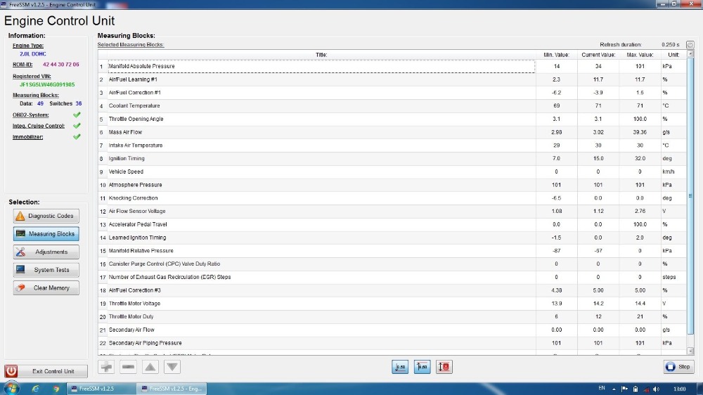

I meant 32-34 kpa at idle. So 9.44959 inHg.
I'm have trouble at work and i was busy fixing some bugs on a new website that we launched early because of someone else's ambition.
And i didn't receive a notification for whatever reason for you replys.

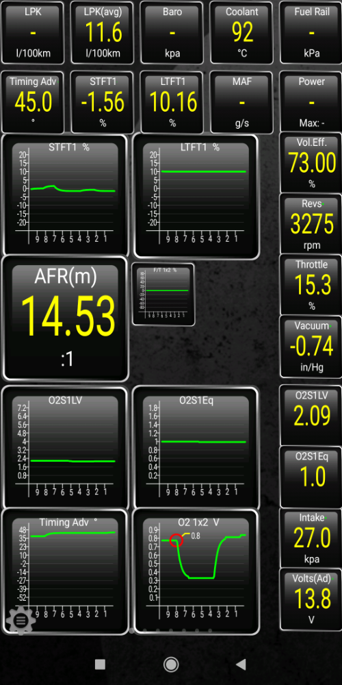

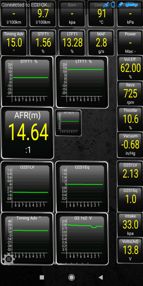

I attached a screenshot at idle. Here's a gdrive link in case the photo it's not uploaded photos.app.goo.gl/978ZLHvWNyPDtBtH9
And this photos.app.goo.gl/Y7sQgi99Ykv6a3oB9 is a screen recording while driving. Maybe you can see something that is obvious to you.
I will sneak today and do a reading of map at wot.
Last edit: 6 years 11 months ago by vladislav.
  • vladislav
  • vladislav's Avatar Topic Author
6 years 11 months ago #35161 by vladislav
Replied by vladislav on topic Positive (10) ltft all rpm

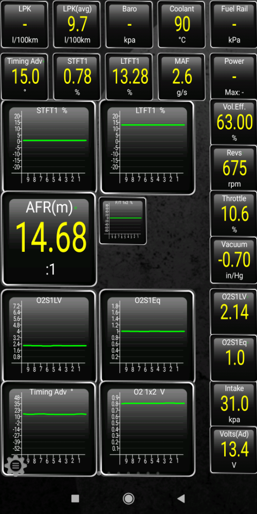

So i snook and i cleaned throtle body and egr valve.
They weren't that dirty.
Throtle position got from 11.4 to10.6 at idle.
And egr doesn't leak vacuum.
Also fixed a heatshield that was rattling and caused ignition time pulling.
I reset the ecu and still fuel trim at idle is 10-14.
Map reading at wot is exact same as atmosferic pressure.
I'm out of ideas.
Here are some screen shots

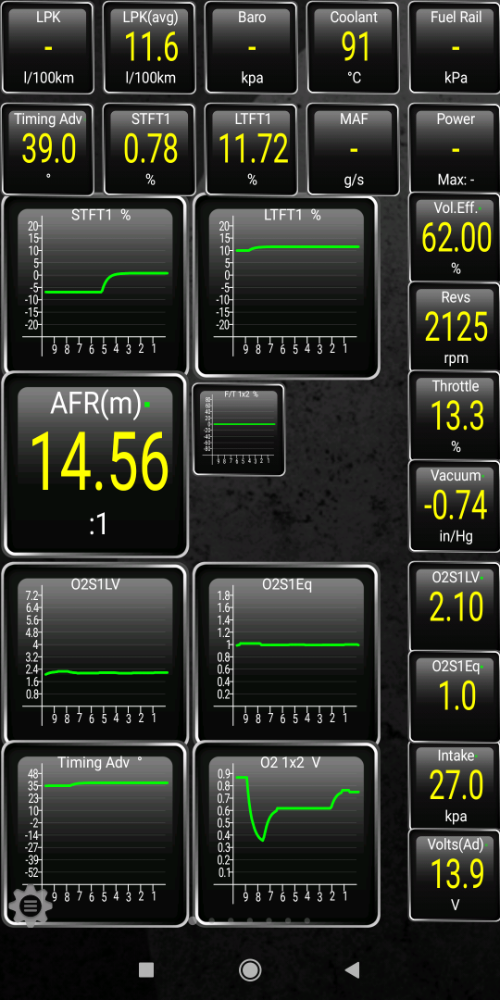

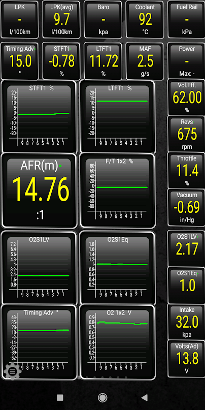

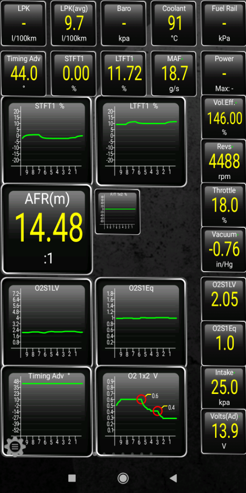

In reviewing your live data... your STFT and LTFT get better with increase in RPM. This indicates a vacuum leak.
I know you checked, but I would recheck for a vacuum leak. I would do a smoke test at this time. The leak might be small and hard to find.
Also check your fuel pressure readings. At idle and WOT. Do a snap throttle test, the pressure should increase approx 10% then drop back to idle pressure. Also check the pressure after you turn off the engine. Does the pressure stay or drop. Watch the pressure for 15min. Does the pressure drop and if so, how much.

It varies a lot when i'm driving. But at steady rpm it's the same ltft. See the pics. Like i said in the title.
I don't think it's somenthing wrong with fuel pressure. Fuel trim should increase with rpm.
Also vacuum leak should get better with rpm increase. Even to be totaly ignored at 4500 rpm.

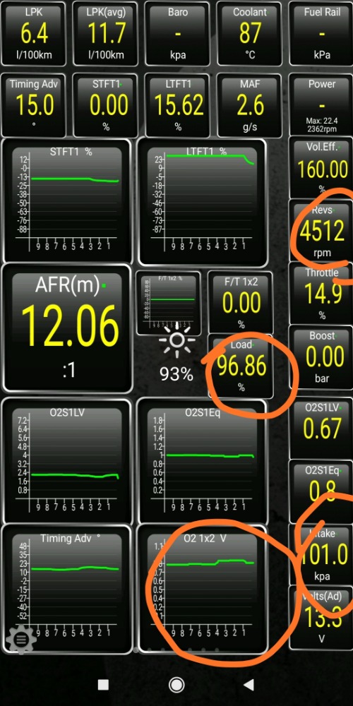

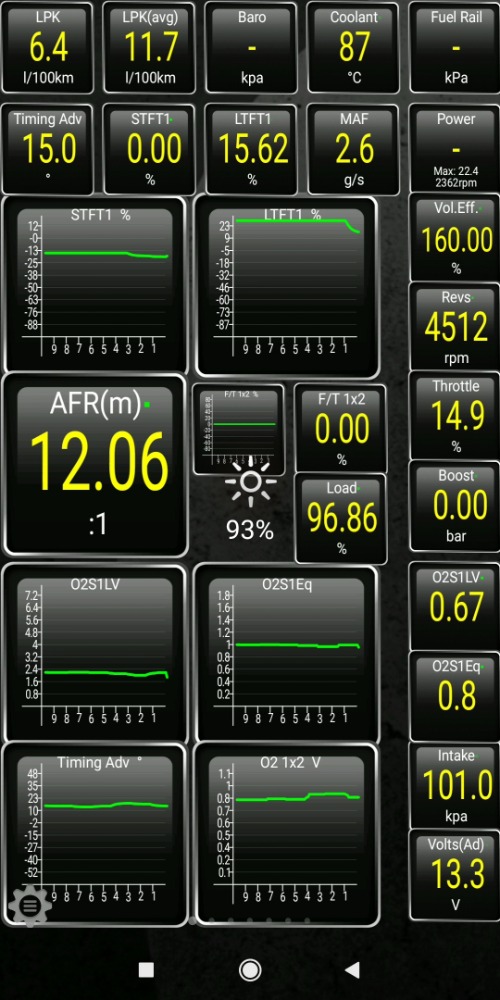

6 years 11 months ago #35172 by Paul P.
Replied by Paul P. on topic Positive (10) ltft all rpm
Your Intake Pressure is 33 kpa @ 725 rpm
Your Intake Pressure is 25 kpa @ 4488 rpm, this is NOT good, it should be 1-2 kpa close to WOT.
This clearly shows the Intake Manifold pressure is not dropping like it should when the throttle plate is opened. Only 2 things can cause this, Intake Restriction or an Exhaust Restriction.
You need to monitor three PIDS O2, Calc Load, and MAP.
@ WOT
Rich O2>Low Calc. Load>High Map>>>>>Restricted Exhaust
Rich O2>Low Calc. Load>Low Map >>>>>Restricted Intake
Lean O2>Low Calc. Load >>>>> Air Measurement Issue
Lean O2>High Calc. Load>>>>> Fuel Delivery Issue

At wot the pressure is the exact same as atmospheric pressure. I think it's 101 kPa.
I will do the tests you mentioned.

It's like this
max load-max map-rich o2 .
the o2 drops after i release the gas.
it's scary this test.
