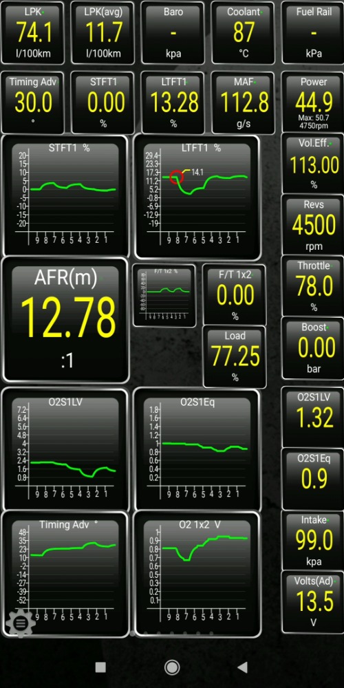

In those two pics you just posted , neither your throttle angle nor your mass airflow increased!
How is it possible to achieve 4512 rpm on 15% throttle?
Your Wot test should be done in a safe place with the vehicle in low gear. At WOT you should also be in Open Loop.
Looks like your MAP went to atmosphere which means you are not looking at an obvious breathing issue, and the O2 stayed rich which is good.
But that MAF reading can't be right 2.6 grams/s at 4512.
edit. Also, I looked over your previous posts and at 4400 rpm your MAF was only at 18 grams/s.
Your data shows your MAF to be reading very Low, try cleaning it, and retest to see if the numbers increase.
Either that or whatever your using for live data is giving you wonky readings, I can see its Android-based so you should be really limiting the Pids you view to make sure they update properly and provide relevant information that can be used to make a decision.

Well i didn't know i supose to do the test while driving. In gear.
That's what was scary. I reved the engine to 8k.

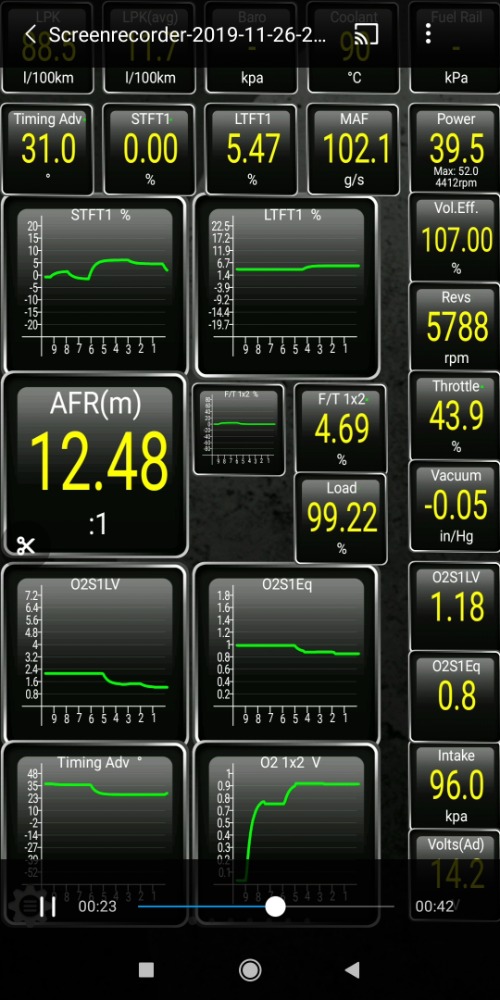

I did again the test while driving. Here is the screen recording
photos.app.goo.gl/3KB1KE66VvxU4Ho3A
At the end i was engine braking so o2 got lean.
Everything looks normal to me. Even the car drives normal. The power is there.
Aside from lean fuel trim and the stumble when driving off from still of course.
Also here's a printscreen

Those numbers look much, much better!
i still agree with scannerjohn, a vacuum leak for High LTFT at idle and improves with Increased rpm.
You could check the signal voltage of the TPS with a DVOM or scope even better to make sure there is no dead spot off idle., which can cause a hesitation as well.
Your Load should be near 100, its at 77, remember,
Rich O2>Low Load>High Map=Exhaust Restriction
You may have a culmination of things goin on here:
a. partially restricted exhaust
b. Vacuum Leak
c. Lower MAF readings due to partially restricted exhaust, which is why the load isn't closer to 100.

Hi!
I did another test and the load goes to 100. See the picture. It may look like the throtle it's not opened all the way but i asure you it is.
I needed to rev the engine all the way past 6k. I didn't know that previously.
So it seems it doesn't have an intake or exhaust restriction.
I don't have any leads again.
Thank you very much for your advices so far. And if you can't think of anything else i will leave it like that. Because i'm sick of it and i have to make peace with my mind.
What could be the worst if i leave it like that in the long term?
