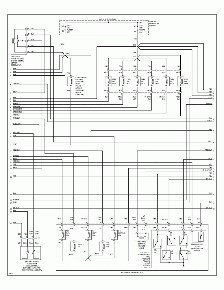

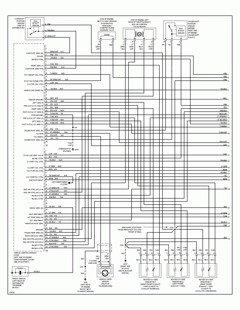

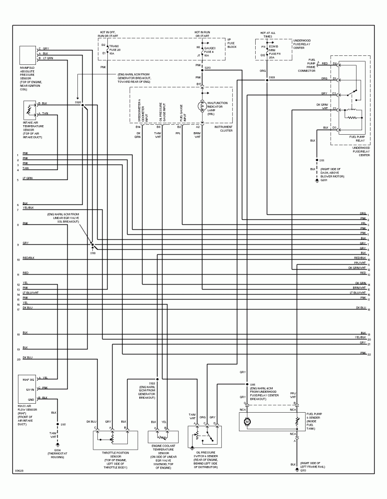

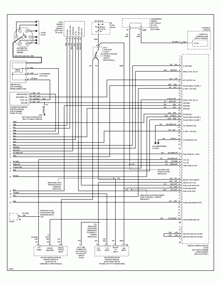

I'm using Mitchell1diy diagrams. There are 4 pages of diagrams and I'll try to link them here. Not sure if they will work. On page 4, at the right most portion of the whole diagram you can see the two 5v ref. pins (12 & 27). They are in the WHITE connector. There are 4 connectors on this VCM (WHITE,BLUE,RED,BLACK). This diagram(page 4) contains the WHITE (top)(pins1-32) and BLACK (bottom) (pins 1-24)connectors. Oh there is a 5th connector a 4 pin BLACK square, but it is just a loop through for the service circuit provider. Is that for a scanner connection??
<edit>I found a way to post the entire set of 4 diagrams. They should be laid out L to R(1-4) if you print them out. ;)
Page #1
Page #2
Page #3
Page #4

10 years 3 months ago #412 by Noah
If you're a premium member or if you have the book, there's lots of material covering the 5v ref circuit. This is part 1 of a 3 part series involving a Jeep which, although exhibits different symptoms, does not have 5v at the tps. It kind of walks you through Paul's thought process when the ref circuit is down.
I would start by checking for 5 volts on another sensor. If you still don't have it, time to look for a shorted circuit to ground with the ohm meter.
Of course powers and grounds at the VCM are suspect it the 5v ref doesn't check out, but your vehicle runs...
Those computers are notorious for connector issues and pin fitment problems. I've had to repin more than a couple connectors on that style VCM.
It's not popular with many Tech's, but if I don't find 5v at more than one sensor, I like to go ahead and cut the 5v wire coming right out of the vcm and check voltage there. If you got nothing, check computer power and grounds, (and check the connector for bent pins or corrosion),then if all that checks, it's computer time.
If you do have 5v at the computer after cutting the wire, then you need to start looking for a shorted sensor, or possibly a shorted out partly shorted wire to ground.

Ok, so some more work yielded not much progress, well maybe a bit. So, I checked for 5v ref. on other sensors. All are within 1/100 of a volt. Right around .12v. Measured this at every sensor(EGT,TPS,Fuel Gauge,MAP) on both the 5v circuits(I understand they are all really one, but with two outs of the computer). Measured TPS and has linear resistance with no hiccups in ramp up or down.
TPS- Gray(ref.) .14v
Black(gnd.) 100mv
Blue(sig.) .05v
MAP: Black(gnd.??) .37v
Lt. Green (sig.) .0v
Gray (ref.) .12v
I back probed and measured voltage on both reference wires at the WHITE VCM plug (pins 12 and 27 at the computer) and the low voltage is the same as is measured at each sensor. I unplugged each sensor and had the voltmeter watched...no change. 12.4 v measured TO the computer at the B+ input pin 21(WHITE connector orange wire). No evidence of damaged/corroded pins on VCM or expanded plug pins.
As mentioned above I have a spare computer. I installed it and all the measurements are the same. The odd thing came when I went to start it using this "good" computer. The engine barely sputtered, and would not run. I put the original computer back in and it runs and idles well, but not perfect(slight stutter upon revs). Hard P0122 still there and will not clear. 2 bad computers...broken differently??
I know you mentioned testing the reference line for a short with an ohm test. Forgive me, and I know this should be 101 type stuff, but exactly how do you do that? Embarrassed to say I don't know. I'm sure paul has a video of it somewhere..I'll look too.
As usual, thanks to all for any input. Very close to the nuclear option now...

10 years 3 months ago #461 by Tyler
Sorry I'm late to the party on this one, but is this the same Astro that was having short to ground problems and blowing fuses? We had a thread going on the old forums before we moved, couldn't move it with us :(
Given the voltage measurements you have at pins 12 and 27 at the VCM, I'm really surprised you only getting a TPS code right now! Like Paul said, having low voltage suggests a short, yet the van runs. I've clipped the 5V reference wire close to the PCM before, and I think it's perfectly valid when chasing problems like this.
I'm wondering if you're not chasing some green corrosion in the VCM connector, causing a voltage drop right at the VCM. Maybe have a careful look at the female pins in the connector, or even consider taking that pin out of the connector for a closer inspection?
