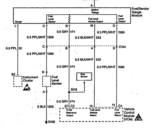

10 years 3 months ago - 10 years 3 months ago #540 by Noah
Attachment not found
Looks like it lives behind the DLC somewhere
Nice work, looks like you have some good direction now! Watch the 5v line on the grey wire and see if it comes to life when you unplug it. Of course check the connector for damage or corrosion while you're in there.
We came to a 4 wire plug( not the 5 wires shown on Mitchell) and unplugged there. 5v came back. Does that mean the short is between that point and the FSGM or could it be anywhere on the circuit??
Was it just a connector in the middle of the harness somewhere, or a box/module/component?
The short would have to be from that point forward---toward the FSGM, if not the FSGM itself.
Last edit: 10 years 3 months ago by Noah. Reason: didn't address the question

YOU ARE THE MAN! Where is that diagram from?? I have a complete set of GM factory books (for a '98 though) and they make no mention of it. Maybe they dropped it in '98 ??? I looked at that silly thing, and told my neighbor that it was the daytime running light box. :bangshead:
Yes, it was just a connector coming out of the harness. Lived behind the battery and went into the firewall and disappeared into a huge wire bundle and I guess out to that module. I traced all the wires from that S118 splice and marked them with colored tape on each end. That left the one gray that went over towards the firewall passthrough where there was a straight through connector but it only had 4 wires. Seeing the diagram you posted it makes sense now. The purple wire (the 5th one at the module) just goes FROM the module up to the gauge on the dash. That just never occurred to me when I look at that mitchell1 diagram. They need arrows on those damn things to indicate send/receive. LOL.
OK, so one more question. Why is it putting out a TPS code (p0122) for a gauge sender issue??

10 years 3 months ago #568 by Noah
Wow, so it WAS shorted. And here I was banking on high resistance, oh well. I still don't understand how this thing runs with the 5V ref shorted, maybe there's multiple regulators at work? Whatever, you're making progress!
Right Tyler? This this is die hard! Shorted 5v ref? Pshhh! 'Tis but a flesh wound!
Unplug your computer and put a test light connected to battery positive, and see if it lights when you touch the TPS 5 volt wire wile you monitor that same wire with a multimeter (to avoid a feedback variable).
Good tip GeorG! I like your thought process.
It's easy to get turned around reading those things. I do agree with tyler about factory diagrams. Not just for connector numbers, but also because sometimes the "simplified" diagrams can include TOO much stuff to look at, where as the OEM only gives you whats involved in running that particular component or circuit. (Sometimes that is).
As for the TPS code, I can only guess. Maybe that's just the most major player on that leg of the circuit and therefor has code set priority?
Don't quote me on that, just thinking out loud...

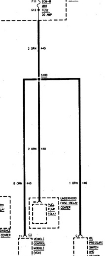

10 years 3 months ago - 10 years 3 months ago #664 by Tyler
Ah don't sweat it, man! Multiple failures is just part of the game. Any shop you'd take this to would be dealing with the same problems. Heck, they might not have even gotten this far yet.
Posting the diagram for reference:
So just to be clear, if you replace the ECM-B fuse, it pops immediately? I know that the test light is showing a short, but that may be because the test light is finding a ground through the VCM as it normally should.
I've seen shorted GM modules before, but usually they're BCM's that use higher load circuits. If you find that the ECM-B fuse pops immediately, then you could always try your other VCM. I know, it gives you a start/stall, but it'd at least prove out the failed VCM.
EDIT: Image uploading isn't working, I'll try later.

10 years 3 months ago - 10 years 3 months ago #689 by Westfalia
Replied by Westfalia on topic P0122 TPS GM 4.3 / Low voltage on ref. & signal
Tyler wrote: Ah don't sweat it, man! Multiple failures is just part of the game. Any shop you'd take this to would be dealing with the same problems. Heck, they might not have even gotten this far yet.
You know, my helper was saying put a fuse in and see if it blows, but I said "why? It's showing a short with the test light...see". I should listen to him more...ha.
So if I put the fuse in and it blows right away, then the computer is bad? I'll check with a fuse and the other computer though. Oh, not sure I mentioned it. The test lead to the fuel pump was shorted to ground too. Would an internal short in the computer do that? Guess I need to test the fuel pump relay too since it's on that circuit. I'll unplug the pump from the harness and try and power it with my power probe to confirm it still works.
What would make that ECM-B circuit fail just by unplugging a fuel sender module? Odd. Oh, can I send 12v to the computer to try and power it up independently, or will this fry it since it seems to be grounding out?
Just to be clear, could all of these multiple issues have one root cause? Or are they just issues I'm causing messing around with things? I know there is no answer without seeing it in person, but can a ground issue in lets say the fuel pump or the fuel level sender feed back through a circuit and cause issues within the computer? Grasping at straws now. Haha.
The original failure was so sudden and complete, you'd think it would only be one thing, and not cascading multiple faults. Is there a diagnostic I can run on the computer to test it?

10 years 3 months ago #708 by Tyler
If the fuse pops with the VCM plugged in, but doesn't with it disconnected, then that would indicate a shorted VCM. I still doubt this, but I see new stuff every day! I'm guessing that the fuse will be OK when installed.
I guess I should caution you (and others) about test light short finding. If there are any loads that are permanently grounded (like fuel pumps and VCM's) on the circuit you're testing, then the test light will light. This is why the test light shows a short when connected to the fuel pump test connector: It's finding a ground through the pump itself. Just FYI.
As for what caused the ECM-B fuse to pop, not sure? I'm inclined to revisit that later if the fuse pops again. It may be that there's more going on in this harness than we know about. I don't see a fuel pump ground or level sender causing fuses to pop like this, but please don't feel bad about trying to connect the dots! Sometimes we can connect multiple symptoms, sometimes not, but it's important to keep trying anyway.
The topic has been locked.
10 years 3 months ago #715 by Noah
That's a very good point, it's what I was thinking when I read this earlier.
This video actually illustrates this concept, just on a purge solenoid.
It's the same principle as why you would see power on both sides of a pull down type solenoid circuit until it is energized, only with ground not power.
Hope that makes sense

Tyler wrote: If the fuse pops with the VCM plugged in, but doesn't with it disconnected, then that would indicate a shorted VCM. I still doubt this, but I see new stuff every day! I'm guessing that the fuse will be OK when installed.
Gold star for you...again. You were correct, and the fuse did not burn out! We hooked the computer back up, jumppered the cut 5v wires at the computer put the meter on the circuit and measured the .14-.15v. I went and pulled the fuel sender gauge module and kaaabam 5V!! I guess we can call this solved :woohoo: :woohoo: With that said, I have a bunch of crap to put back together and then test, as well as going to the junkyard and finding a good module, but man I can't believe we found it. Why that circuit popped is beyond me...maybe when I pulled it the first time I left the key on or something and it overloaded that circuit. Does not matter now, but I'm still holding my breath till I get it back running and see if that P0122 TPS code is still there. Did not have time tonight to go through all of it.

Now there is no 12v+ to the CRANK circuit. Crank fuse has 0v. DLC pin 4 shows no have ground. That circuit gets power from the ENG-A 40 amp fuse. Power there. "Appears" there is an open on that DLC wire, but who knows for sure?? This floating problem is now just silly. I'm officially calling this thing the wack -a- mole. :angry:

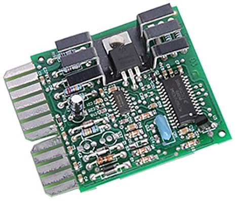

[UPDATE:8/6/16] Truck RUNNING smoothly! NO codes.
Sorry for the panic statement above. Turns out after taking a break and looking at it again, I had not fully seated the main harness connector at the bulkhead passthrough. Fixing that fixed the DLC. I also was measuring the CRANK fuse incorrectly. After thinking about it, I had a forehead slapping moment and realized that that part of the circuit is only energized when you are CRANKING the motor over. System is nominal now :woohoo: .
I also verified again that the module is what is drawing down the 5v ref. signal. I also checked all 6 wires going to and coming from that module as having continuity and not shorting to ground. Wires are good. Module CONFIRMED BAD.
Again, wish I could buy you guys a beer for all the help and hand holding. I appreciate it!
Steve
The offender:
www.amazon.com/dp/B007Q128PG/ref=nav_tim..._encoding=UTF8&psc=1
