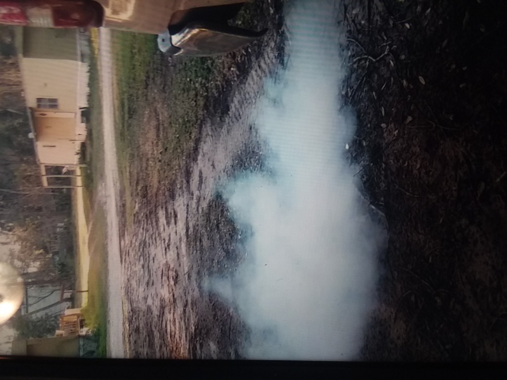

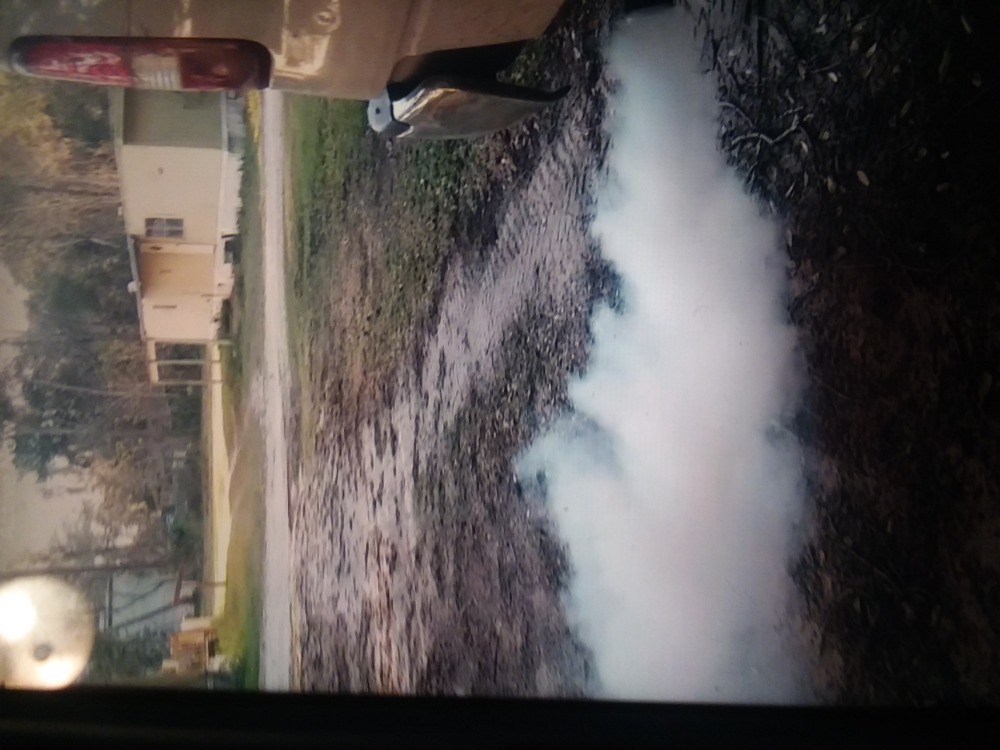

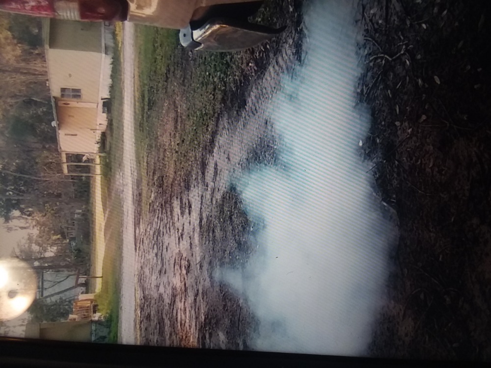

Ok, it wouldn't let me share a 6 second video, so here are some pictures of the exhaust smoke on a snap throttle after it's idled a few minutes

No, the exhaust smoke does not smell like raw fuel to me, comparing it to a V8 engine with no cats on a cold start up, its no where near as strong of a scent .but i could be wrong, and I am getting good gas mileage (15-18 mpg)
I changed the plugs (motercraft platinums) last year, and last week pulled all the plugs to see how they looked and they were all in great condition still new looking after 30,000 miles. (no black soot, or oil fouling) which i was very surprised to see, due to the exhaust smoke. I can pull them again and post pictures, but there was no signs of any excessive burning of anything.
Last edit: 6 years 6 months ago by Patrickreaves.

that white exhaust has to be addressed first... transparent white smoke is usually coolant, opaque white transmission fluid... blue is oil and black is fuel. what ever it is, if its getting on the 02's your going to have wonky readings.

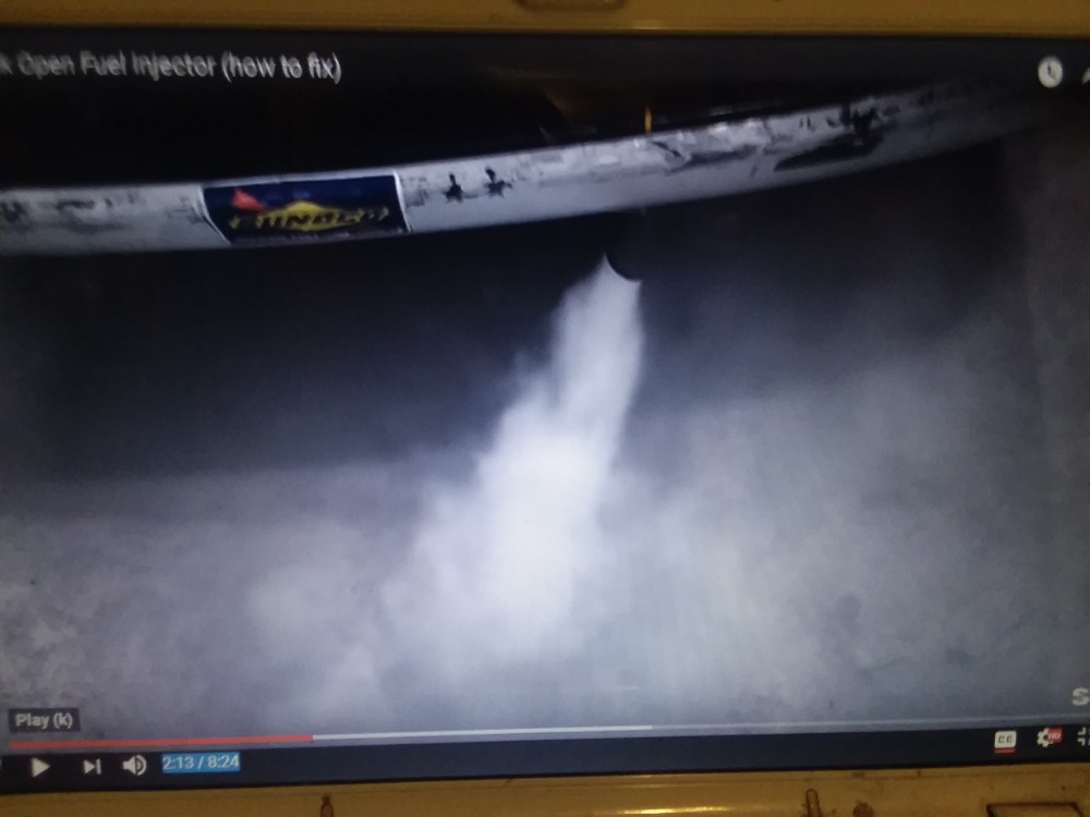

i have tried and tried to find the source of what ever is causing the white smoke. thought it was head gasket issues and have done compression readings multiple times, and each time, every cylinder had 205 psi across the board. have done leak down tests with less than 7% leak down on all cylinders. My research says 10% leak down is normal. removed coolant cap during testing and no bubbles at all, plus it doesn't over heat or need coolant added.
With the results of the above-mentioned tests, i attributed the smoke as un- burnt fuel. Then found scanner danners video ( titled -stuck open fuel injector ) and the smoke coming out of his car is identical to how mine looks, although his car was smoking all the time and mine only does it after idling for 5 minutes or more, but he described the smell as" being similar to dunking your head in gasoline"
so I am lost on this truck , and it has beat me up on this issue for a long time now. lol.
Below I posted a picture of danners white exhaust smoke in the video (stuck upen fuel injector ) and a picture of mine.

6 years 6 months ago #37312 by Tutti57
See if an injector balance test shows you a or some leaking injectors. It isn't impossible to have several. I bought a set of eight used ones for a BMW a few years ago and used to have a fuel injector test station where you could do numerous tests and watch them flow. One of the tests was a leak test and three out of eight were leaking.

6 years 6 months ago #37320 by VegasJAK
I'd go with the injector leak down test as well... with that heavy amount of smoke, I can't imagine why no fuel smell. Leaking injector/s will cause the neg fuel trims.

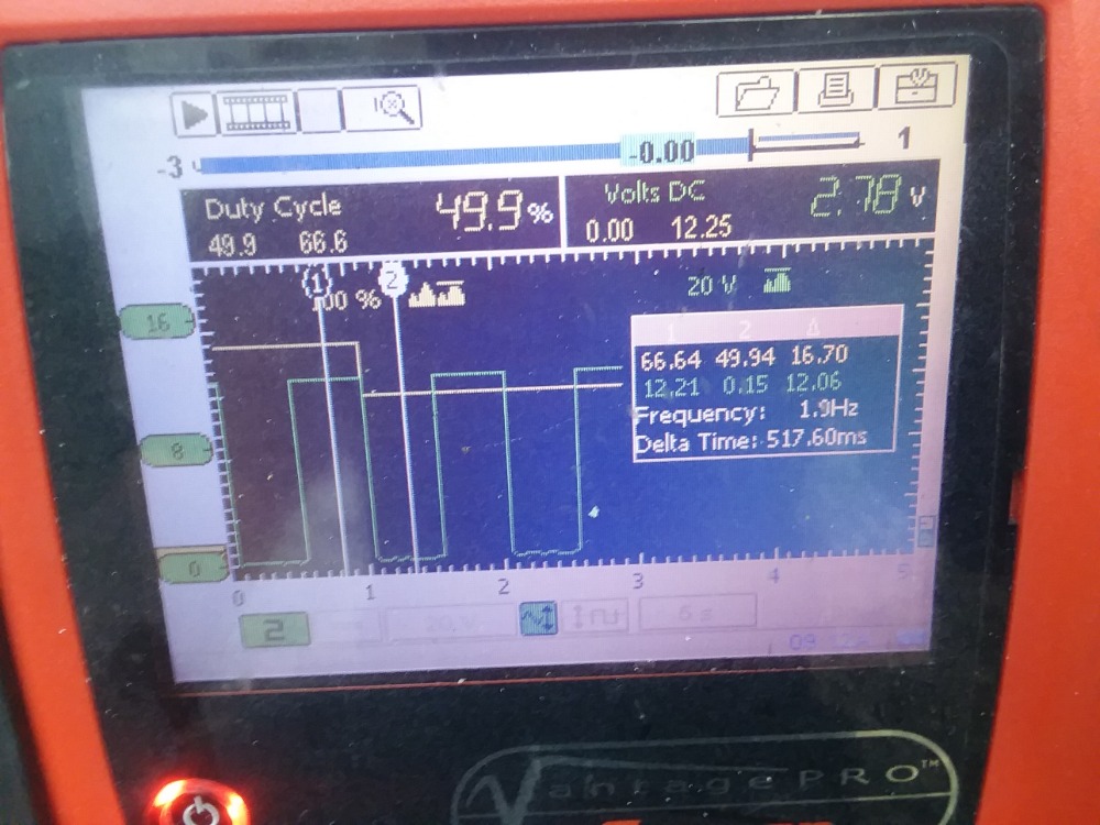

I did check duty cycle on the signal wire of the FPDM, (fuel pump driver module) with initial key on it read 66.6% and after start up it went to 50% D/C.
the (FPDM) lives on a cross member under the bed of the truck and while i was under there testing it is definitely very rich smelling, to the point of giving me a head ache, I had someone else smell it today and they say it stinks also, I guess in am just used to it.
And yes, the upper radiator hose is definitely hot
I discovered that i was on the monitored signal and not the actual commanded duty cycle control signal, i got this straitened out in comments down below this.

6 years 6 months ago #37334 by Tyler
IMO, the fuel pressure and the FPDM are not the issue. 40 PSI is 100% normal for these systems. The duty cycle that you're measuring isn't a good indication of what's going on at the FPDM, FYI. ;) That's the feedback signal from the FPDM to the PCM, and it'll only change if the FPDM detects an issue. An 'issue' results in the duty cycle going to zero or 100%. Both generate codes in the PCM in the P12XX range, which you don't have.

6 years 6 months ago #37341 by VegasJAK
If you get a chance and you can get a fuel pressure reading using a gauge, I would like to have it for my notes and study... your scantool FRP is 40psi and the voltage is 2.78 which is the voltage for 40psi, but you posted when you pulled vacuum you had 75psi on scantool. Reading are supposed to be same. Would like to know for sure.
