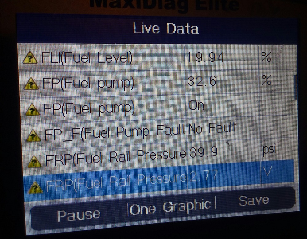

Tutti57, my engine runs great, other than the response hesitation / no power at a dead stop (Cant go up steep hills in 1st or reverse).its not misfiring at that time, just doesn't want to rev up. In park and After 10 mph, it has 100% power and very responsive throttle. As far as engine timing, my scan tool says that cam and crank signals are synced, plus no correlation codes. As to ignition timing, its all over the place, 6-12 degrees BTDC at idle and 25 degrees BTDC under heavy load (i believe) can recheck. I have checked it during the poor response and power symptom, but like i said its all over the place and i'm not sure what is normal. I even thought the knock sensor might be retarding timing and causing this issue but cant find the sensor to unplug it.(thought it was in the valley, but that connector goes to the cylinder head temp sensor.
Scanner John , After testing again , I found that pulling the vacuum line on the FRP sensor actually had no effect on the fuel pressure reading at all. it was when i unplugged the sensor that it went to 75 psi, (sorry about that). I'm not sure what the vacuum line is for, i thought it worked like a regulator, full-vacuum = Idling/no load, and no-vacuum=WOT/under load?? (I'm not sure) or maybe its a "clue", that my fuel pressure did not change when i removed it.

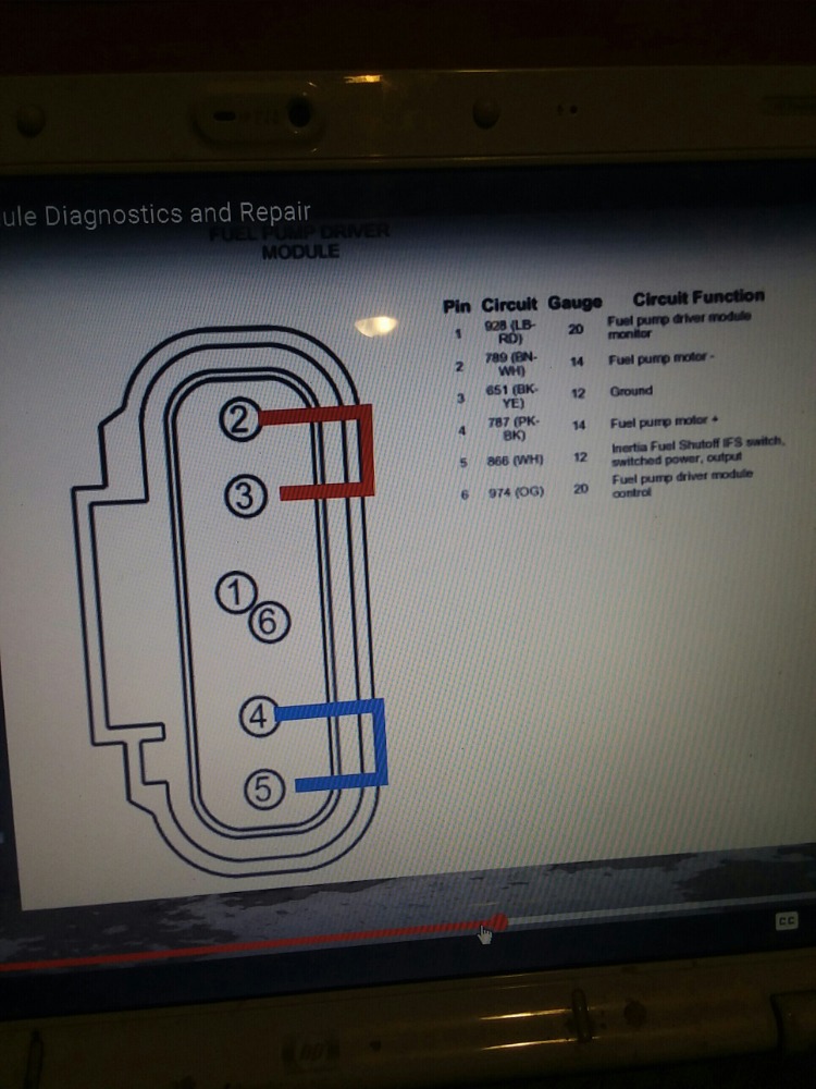

I watched Scanner Danner test a similar FPDM on a 2002 Taurus, titled (ford electronic returnless fuel pump), his readings were different than mine and more like you described. His 2 second prime was a 50% duty cycle , then went to 25 % after the prime was over, and back to 50% during cranking. His on/off square wave signal also matched the duty cycle reading. 25%=pump off/no ground applied, 50%=pump on/full ground applied, and his car was a no start so i don't know what the percentage would be with engine running.then on another ford video with the engine running (pic below) he guessed the on time /duty cycle to be about 20%. i did the exact test with the exact same scope,(vantage mt 2400) and my vantage pro. but my duty cycle command was 50 % all the time just like you suggested and the square wave signal also showed this and did not change (as Danners did). so maybe you are on to something. I will test again later. then going through my scan data pids, I found the data pid for Duty Cycle % and it read the opposite as Danners. It read, 2 second prime/cranking=50%, then after the prime was over/pump off=75%, engine at idle=32%, and WOT=50%

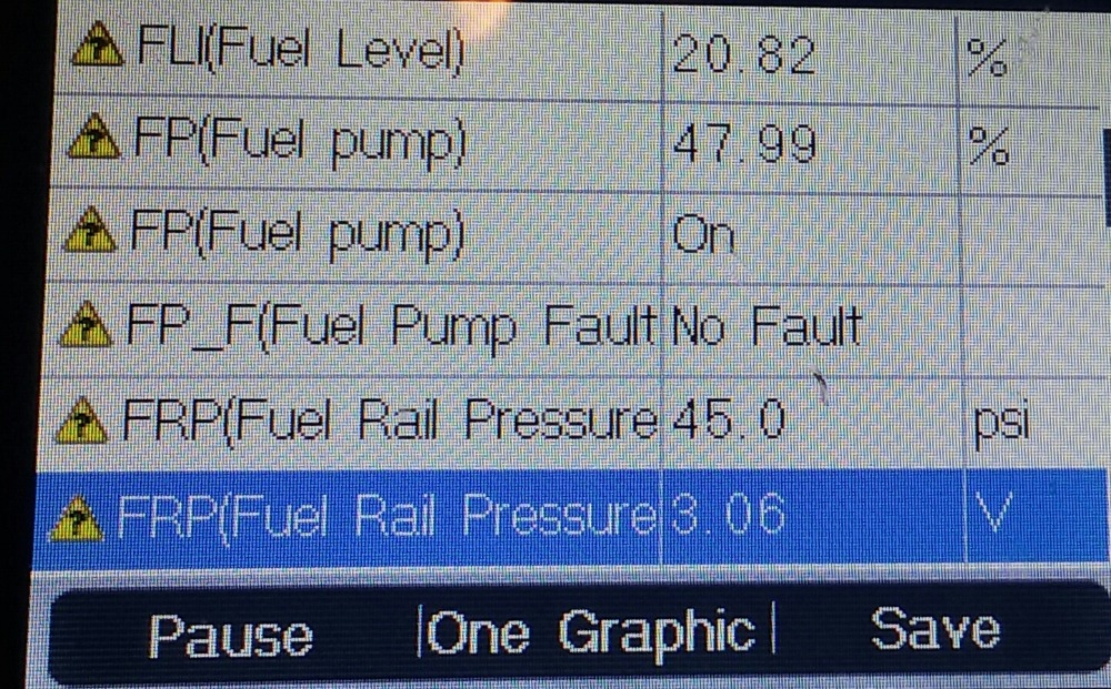

6 years 8 months ago - 6 years 8 months ago #37347 by Patrickreaves
Replied by Patrickreaves on topic 2005 f 150 4.6 has -20% fuel trims on both banks

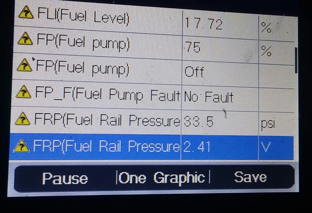

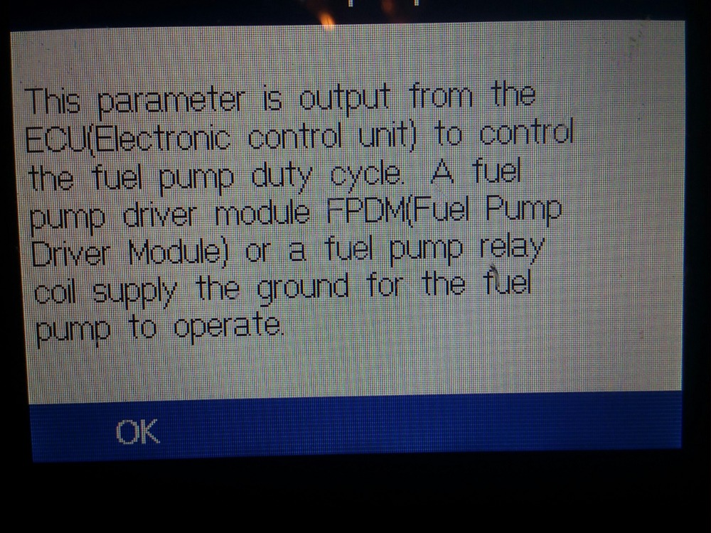

scan tool duty cycle %
Att#1 prime /crank/WOT =47%
Att#2 pump off after prime =75%
Attj#3 engine running =32%
Att#4 pid information
Last edit: 6 years 8 months ago by Patrickreaves.

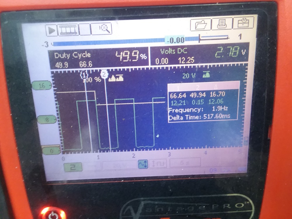

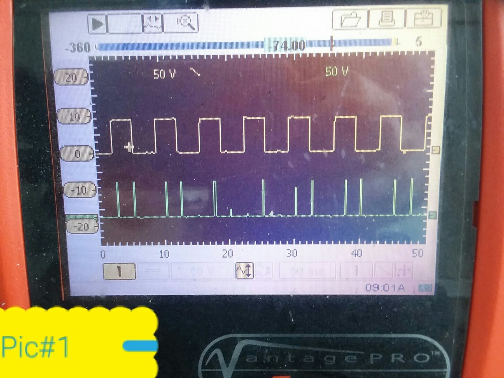

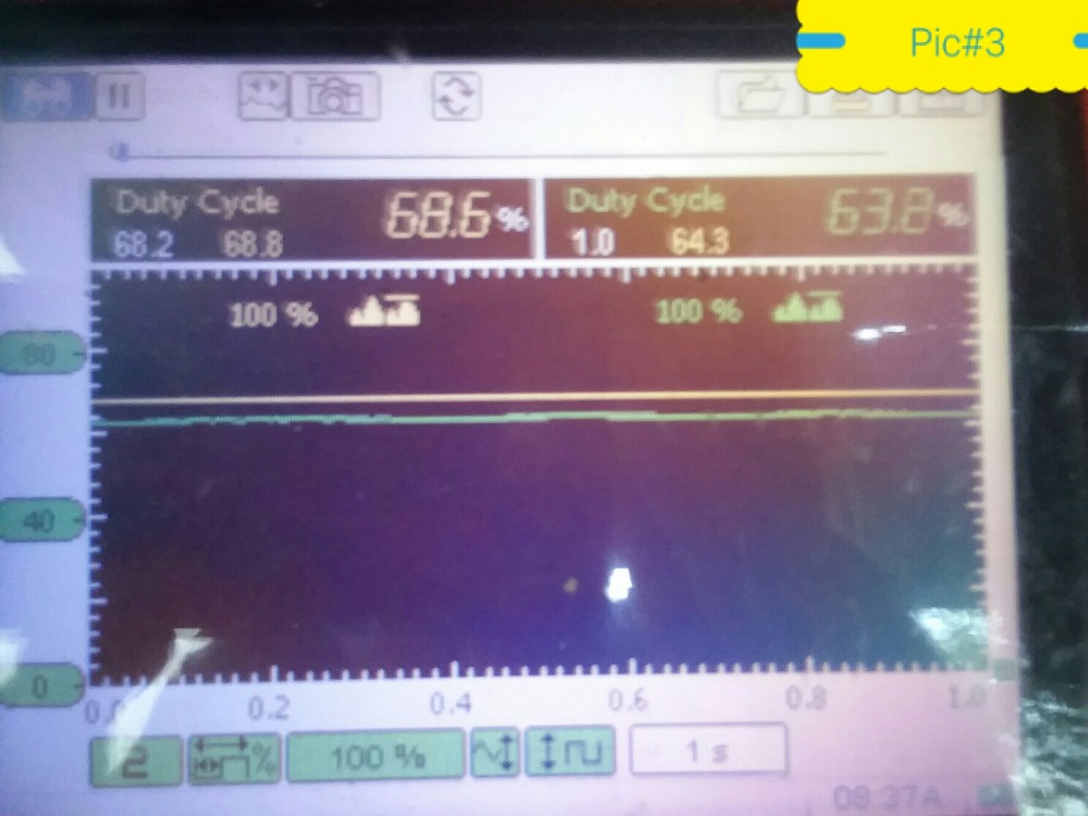

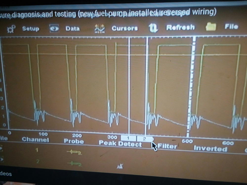

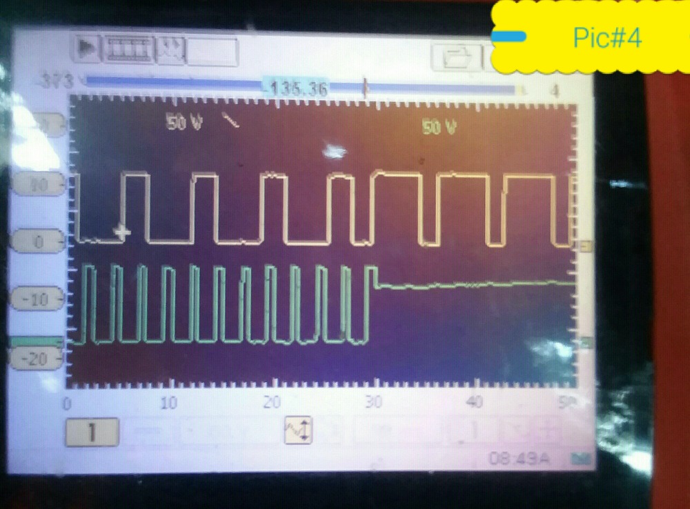

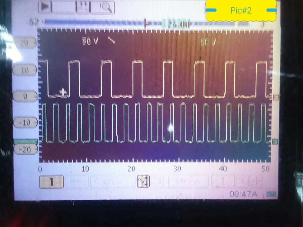

scanner john, i spent 2 hours today rechecking duty cycle command, and the on/off square wave/FPDM applied ground ,voltage signal. Im on the control wire now, because my voltage signals match the duty cycle command, but my readings were still not the same as danners two cars .
Im on a 50 volt scale because it was the best way to get both waveforms in the capture. The lower portion should be the on time, and upper portion being the off time.
pic #1 CRANKING with 50% duty cycle = yellow trace is on pin # 6 of diagram (module control) and green trace is on pin # 2 (pump ground)/ FPDM applied ground. this wire has 12 volts with key off,(pump contacts good).. During cranking it has a full ground. (this was the same as danners )
Leads connected the same for all pics.
pic #2 and #3-- engine running at idle, shows 68.6% duty cycle command (danners video showed 20% on the green trace (applied ground) with the engine running. After capturing pic #2, I left my leads connected and went to duty cycle on my vantage pro , and captured pic #3. ' ( I'm not sure why duty cycle is at 68% command, and 63% actual. (this would suggest that the pump is being grounded 70% 0f the time , (when max is supposed to be 50%), but then I don"t have excessive fuel pressure).
pic #4 is where the engine was running 70% duty cycle on the left side of capture, and on the right side is where i shut the key off and it returned to 25 % duty cycle command on the yellow trace, and the green trace has the curve effect from counter electromotive force as it climbs back to 12 volts . (the return to 25% duty cycle with the key on/pump off, should be normal, and is like the 2 cars that scanner danner checked. but that 70% command does not look right to me, as it should be closer to 20-30% with the engine running.
edit=
I also disconnected the FPDM about 4 times and let it run until it died, to relieve the fuel pressure, so i could install my fuel pressure gauges. Research says that it should, but may or may not flag a trouble code for (1) loss of communication (,2) if fuel pressure is less than 20 psi, and( 3) if pressure is greater than 60 psi. I have met all those conditions and it has never flagged a code. Research said that when a pump wears out it will require MORE average voltage (longer duty cycle ) to keep up with pressure demands. My fuel pump being worn out , would support the longer duty cycle of 70%

6 years 8 months ago #37398 by VegasJAK
I would not call the pump just yet... these systems are complicated, I sure would like someone with more knowledge on this system to post in before you do anything with the pump. That 75% has me uneasy... its a valid PCM to FPDM off duty cycle command, but why is it not the 25% command. If you have a full time 50% duty cycle on the diagnostic (FPDM to PCM) line then thing should be good, so why the 75.
My original theory was the duty cycle was fixed at 50%(full on) on the command line therefore providing too much fuel between start and WOT. The FRP sensor should see this and report the incorrect pressure.

6 years 8 months ago - 6 years 8 months ago #37402 by Patrickreaves
oh i"m not calling a pump at all, just saying that my pump being worn out may be the cause of the 70 % duty cycle .i agree that it should be at 25 % after start up. from what i understand after researching , when the pump wears out and can no longer maintain 40 psi with the original duty cycle , it will then increase duty cycle (longer pulsed ground/ applied average voltage) thus working the pump harder to maintain and match the pcm's desired 40 psi of fuel pressure .
my pressure is in spec so the pump is staying.
what I dont understand is , that if 50% duty cycle is a full ground, then anything over 50 % should still be a full ground. on my capture above 70 % does not equal a full ground as seen in wave form. it may be that duty cycle commands with the engine off, are not the same / equivalent as duty cycle commands with the engine running. that is the only thing that makes sense to me.
like you said , maybe someone with more knowledge on this subject can shed light on it

6 years 8 months ago #37405 by VegasJAK

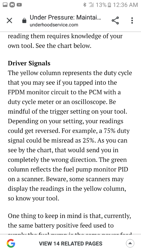

here is an excerpt from something that I found.
5 to 45% This is a normal operating range. ***The FPDM will operate the fuel pump at the speed requested***. When the FPDM sees this signal, it will run the fuel pump twice the speed of the signal. For example, 30% duty cycle from the computer the FPDM will run the fuel pump at 60%. The FPDM will send a duty cycle signal back to the PCM of 50% indicating everything is functioning properly.
48 to 51% Normal operation. ***The FPDM will operate the fuel pump at 100%***. FPDM will send a 50% duty cycle signal back to the PCM on the FPM circuit indicating everything is functioning properly.
70 to 81% the PCM will send this signal to the FPDM ***when it requests the fuel pump off***. ***The FPDM will "not" operate the fuel pump*** and FPDM will send a 50% duty cycle signal back to the PCM on the FPDM circuit indicating is functioning properly.
  • Patrickreaves
  • Patrickreaves's Avatar Topic Author
6 years 8 months ago - 6 years 8 months ago #37407 by Patrickreaves
Wow, thanks for the info. I just read the exact write up that you are referring to, and it's totally different from what I have previously read. It said that a 70% signal would be out of spec and ignored by the FPDM which would then result in the fpdm doing nothing and leaving the pump off.
The only thing that makes sense now is that my duty cycle signal is actually inverted on my scope. (This would now be a 30% duty cycle instead. And the write up said that this very thing could happen. I will attach that portion below
You said that if every thing is working correctly that the FPDM will send a 50% duty cycle on monitored return line, and thats exactly what ive got with engine running.
But really. Thanks for pointing this out, as the FPDM' works differently from how i originally thought that it did.

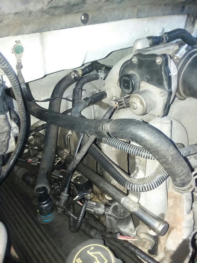

yes scanner john, I think your right. I think calculated load is way too high. These numbers have always bothered me! It jumps up to 100% load with 20%peddle applied.
As to PCV lines, bank 1 line goes to intake manifold,(has as much vacuum as the brake booster line.) seems it would suck up oil.
Bank 2 line goes to air duct, behind MAF sensor. I blocked off the 2 pcv lines, and put a vacuum gauge on the dipstick as "nissan tech" suggested. No vacuum in crankcase, but there was .5 psi of pressure.
So my oil may be fuel contaminated, (and I have heard that an oil change will fix negative trims if contaminated) But i have changed my oil multiple times in the last year,( expecting an improvement)and have never seen an improvement on trims after the fact. I will retest to be 100% sure.
Other than all i have done , I am out of directions to go, I have to be missing something.
To everyone, who has kept up with this, super long thread, and have shared information and suggestions with me, Thank You, I really appreciate you guys.

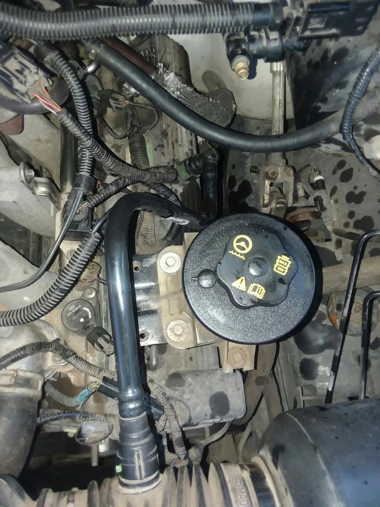

6 years 8 months ago - 6 years 8 months ago #37528 by Patrickreaves
Replied by Patrickreaves on topic Re:2005 f 150 4.6 has -20% LTFT'S on both banks
There is a blue pcv valve on bank 1, (replaced it with no change) pic below.
I drove a perfectly fine 2007 f150 4.6 today and looked at its data parameters for comparison. Coolant temp was 207 degrees. 17 degrees hotter. So ill take the advice and get a hotter thermostat right now. Will post results soon. Thanks
and i wish this site would stop rotating the pics i post, i have to crop them and turn them before i post so they show up correct. lol
